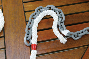

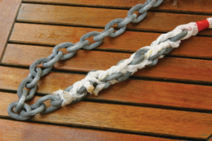

    The 'elongated splice' (we have to come up with a better descriptive term!*) with 8 plait has my attention.
    I know I'd feel safer with strands intertwining a number of links. It just looks right with the 8 plait. [Ebb's wrong here - see below.]
    When you buy the made up 30/270 it's a single link back splice.
    Aren't we loosing a big percentage of rope strength making a splice like that?
    Long splicing 8-plait onto a number of links has to be the best soft connection you can make between nylon and iron.

    THAT IS NOT AN 8 STRAND ELONGATED SPLICE
    described in the article.
    Assume is the mother of all screw-ups.
    It ought to be,
    Don't know how you take 8 strands of 5/8" nylon thru a single link of 5/16 G4.
    No wonder it didn't compute for me. I think the splice is ugly as shown. I mean it is not conceptually correct.
    OK. so where is that 8 strand to 8 link long splice?
    Somebody has to have done it!!!
    Mr. Danicic.....?

    ************************************ HERE IT IS - THE 8 STRAND LONG SPLICE *******************************************
    google> Anchor splicing
    sailmagazine.com/boatworks/sails-and.../8-strand_splice/
    (this probably won't work - but if some computer-age cognoscenti can bring it over to here that would be excellent! hint hint)
    Sail Magazine article:
    8-Strand splice
    By Peter Nielsen Posted April 30, 2009
    11 photos, one diagram.
    Could think this multilink splice UGLY,
    BUT imco it is conceptually correct!
    Mr Nielsen certainly believes so....
    and many European sailors who have used it for 'many years'.

    1,438
    http://sailmagazine.com/boatworks/sa...strand_splice/
    Before and after....
    3,549
    Mike, FANTASTIC!
    I guess that makes this thread a loop.
    We have pretty clear idea of a modern cruiser's anchor rode.
    Even if I wasn't cruising, I'd have something like this for the boat,
    just in case.
    For the moment it appears that this 8 strand rope-to-chain LONG splice is a
    FOLK SPLICE (if that is how to call it).
    It seems to have appeared spontaneously in Europe with the appearance of 8 strand plait, the Brits not credited with the invention. We're probably only 3 people away from knowing the guy who first did it.
    NO manufacturer has a diagram in their how-to's - which is really quite strange.
