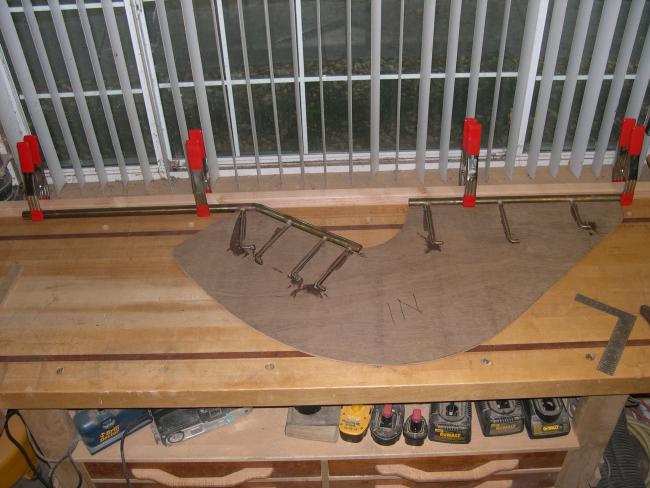

    Opinions please

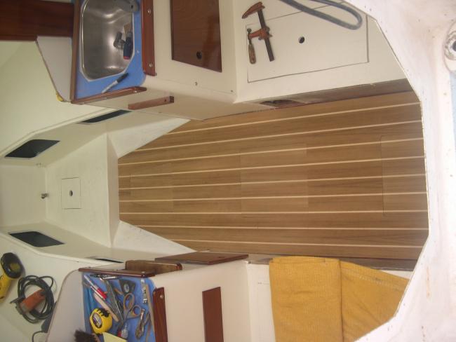

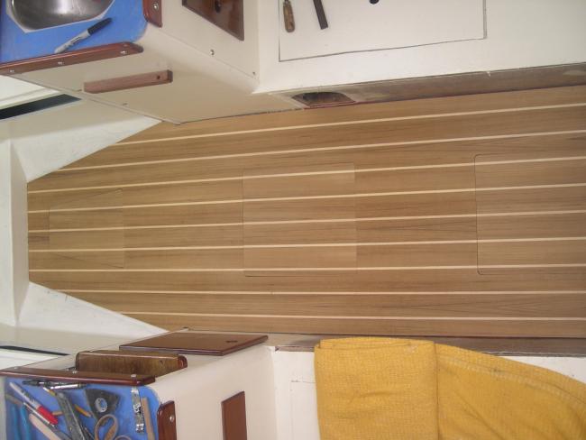

    Well I spent about 8 hours this weekend first making a template then making the piece of teak and holly floor for the boat. And I'm not so sure I like the way it is going to look.
    So far all I have invested is the cost of the sheet of teak and holly and my time. But if I decide to go forward with it I need to spend a lot more time finishing the flooring and then gluing it down after which point it will not be coming up again.
    If I put the finish on this floor it will get somewhat darker but even then I don't know if I like the look. I'm giving serious consideration to abandoning the teak and holly and going with a mahogany floor to match all of the other woodwork.
    What do you guys think?

    Looks nice Jerry, but it makes me dizzy looking at it. I like the idea of matching wood. Matching wood would seem more period correct. You have made wonderful progress on this Commander,
  3. #303
    As always, your workmanship is admirable!
    I love my teak and holly sole. I say keep it. After an Epifanes treatment... or 10, I think it looks richer and matches better. (with little ones, the steps are a necessity on Lucky Dawg.)

    So far the responses have been three forths in favor of keeping the teak and holly floor. And of those responses My oldest daughter (the one in the family with the design eye) said keep the teak and holly. My good friend Tom who's opinion I always listen closely to said keep the teak and holly. My other good friend John also said keep the teak and holly. Tim one of my closest friends said he also likes the teak and holly. As shown below Kyle is also in agreement that the teak and holly should stay. And probably the most important my wife the admiral said "it looks fine keep it".
    Dissenting views were Carl who believes the mahogany would be more historically correct and my youngest daughter Jennifer who just agreed with her dad.
    So since I still have massive amounts of work to do before I finish this project and my goal is to get her in the water this November (knowing full well a lot of things will not be done yet but she will be sailable) I am keeping the teak and holly.

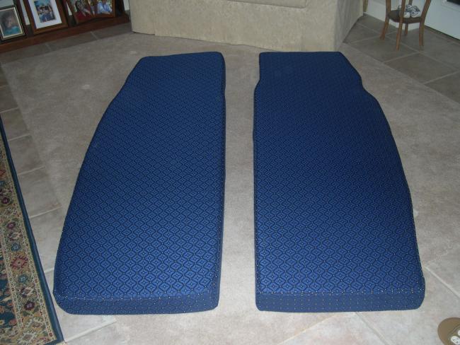

    Oh yea, while I have been doing all of this work the admiral has also been busy. She has made me new v-birth cushions, quarter birth cushions and cockpit cushions. There are some photos below. She also has a lot of work to complete before launch time but she is a trooper and will make it happen. My lifetime partner is at least as hard a worker as I am. :-)

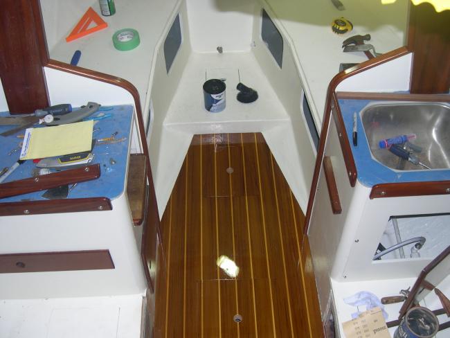

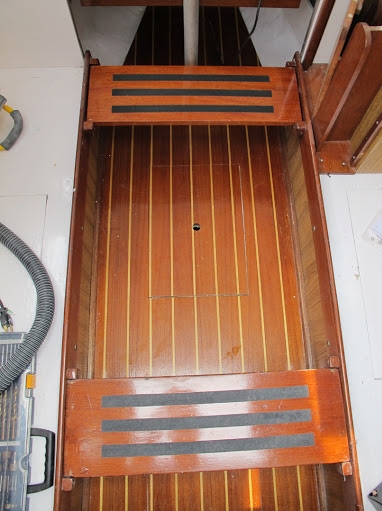

    What a difference a little finish makes

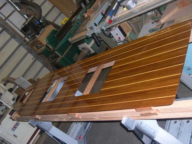

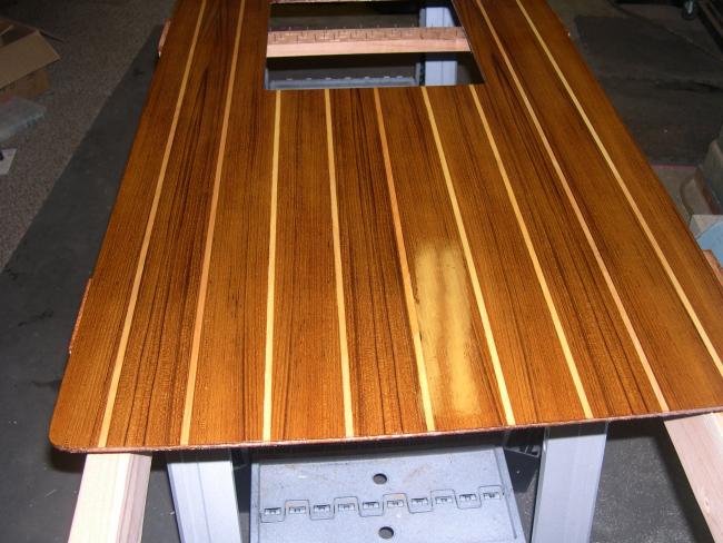

    Last night I coated both sides and all of the edges in epoxy for all 4 parts of the new teak and holly floor.
    Tonight I sanded the top smooth and put the first coat of Epifanes on it and what a difference. Take a look...........
    The picture with the narrow strips is of the parts that hold the quarter berth cushions in place.
    You may notice my "bed of nails" that the pieces are laying on. They allow me to put a coat of finish on both sides of a part at the same time. The back gets coated first then laid on the nails and the front gets coated. Cuts finishing time in half.

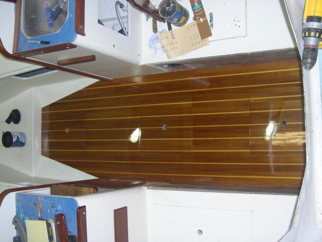

    First I got all 9 coats of finish on the new teak and holly floor and got it installed. And because the floor finally went in I was also finally able to install the bentwood edges for the two new bulkheads I installed to support the mast beam. There are 2 pictures of this work below.

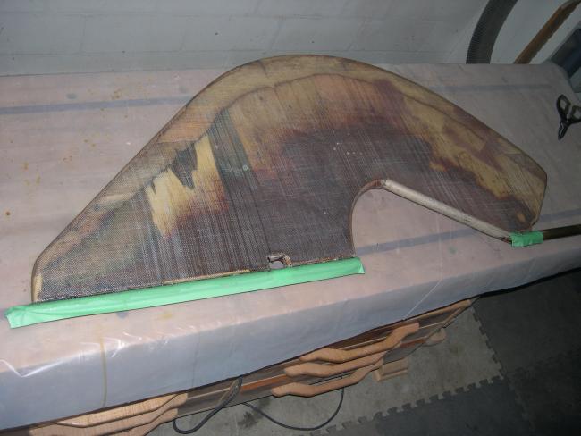

    Next I have been making progress on the new rudder. Since my new rudder is two parts like the original was I needed a way to keep them straight when I epoxied them into the first half of the new rudder. So I clamped a 2 x straight edge to the edge of my workbench and marked where the 3/8" rods would be imbedded in the plywood. Then I routed a round bottom cove 3/16" deep into the plywood where each rod would go. I drilled small holes in 2 places on both sides of each rod and fed wire up from the other side so after I put thickened epoxy in the cove cuts and laid the rods in them I could pull them down snugly into the coves until the epoxy set up. Then I cut the wires and pulled them out before I glued the second half of the rudder to the first one. I hope the pictures below help to make this clearer than my attempt to describe it is doing.

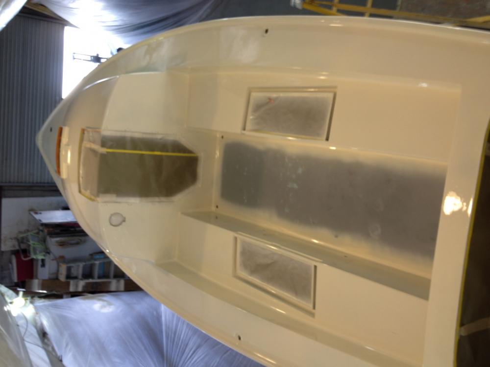

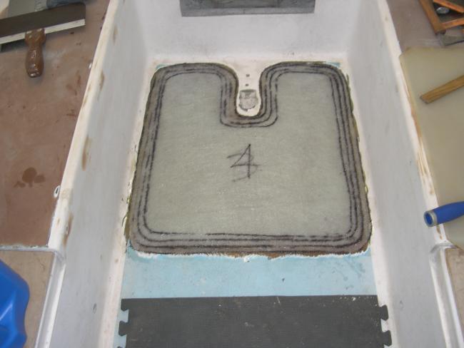

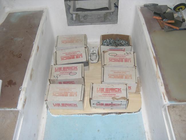

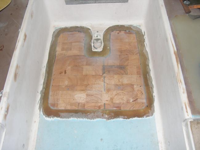

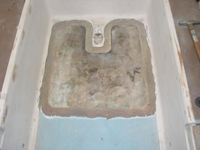

    And finally I have been working on the last of the recore projects. I thought I was done with that before but found that I had a spongy deck around the rudder post and found more rotted balsa core. So I am finishing that up now. Since it will only let me add 5 pictures per post I will follow up with those pictures in the next post.
  11. #311
    As promised here are the last of the recore pictures.
    Pictures below.

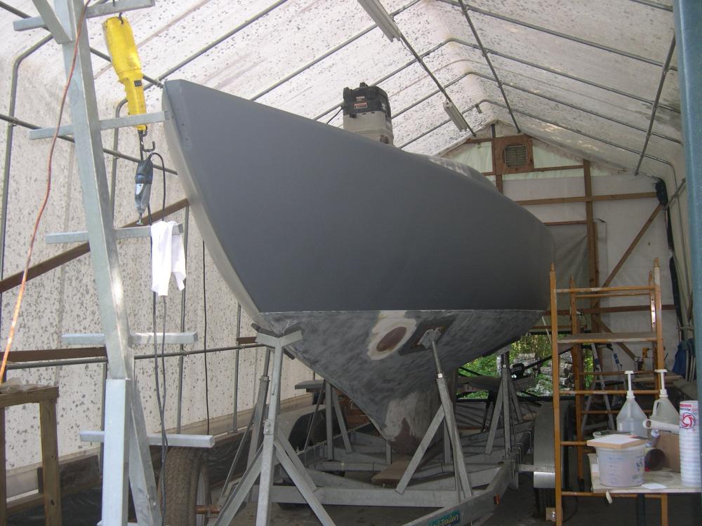

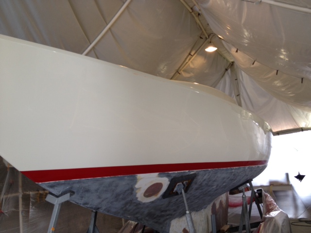

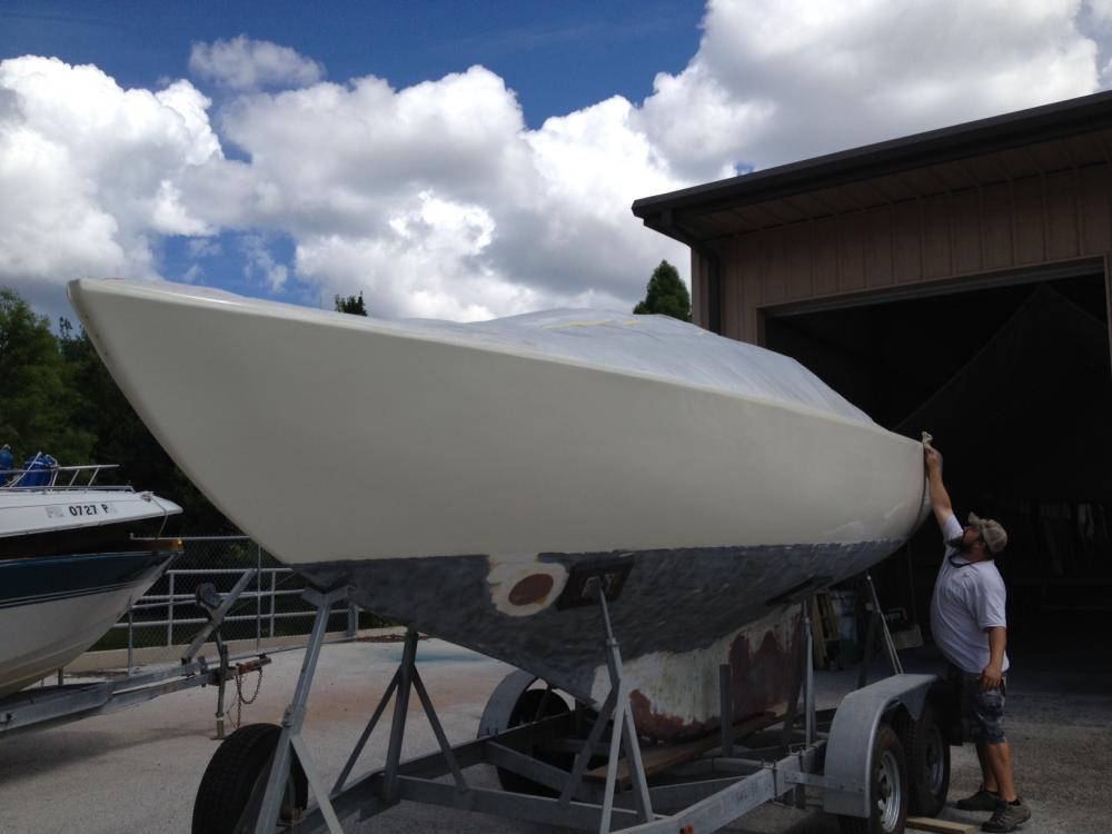

    Well, I have been gone from here for a long time
    And some of you probably think I have given up on my commander restoration project. That is not the case, I just have not taken the time to post about her progress.

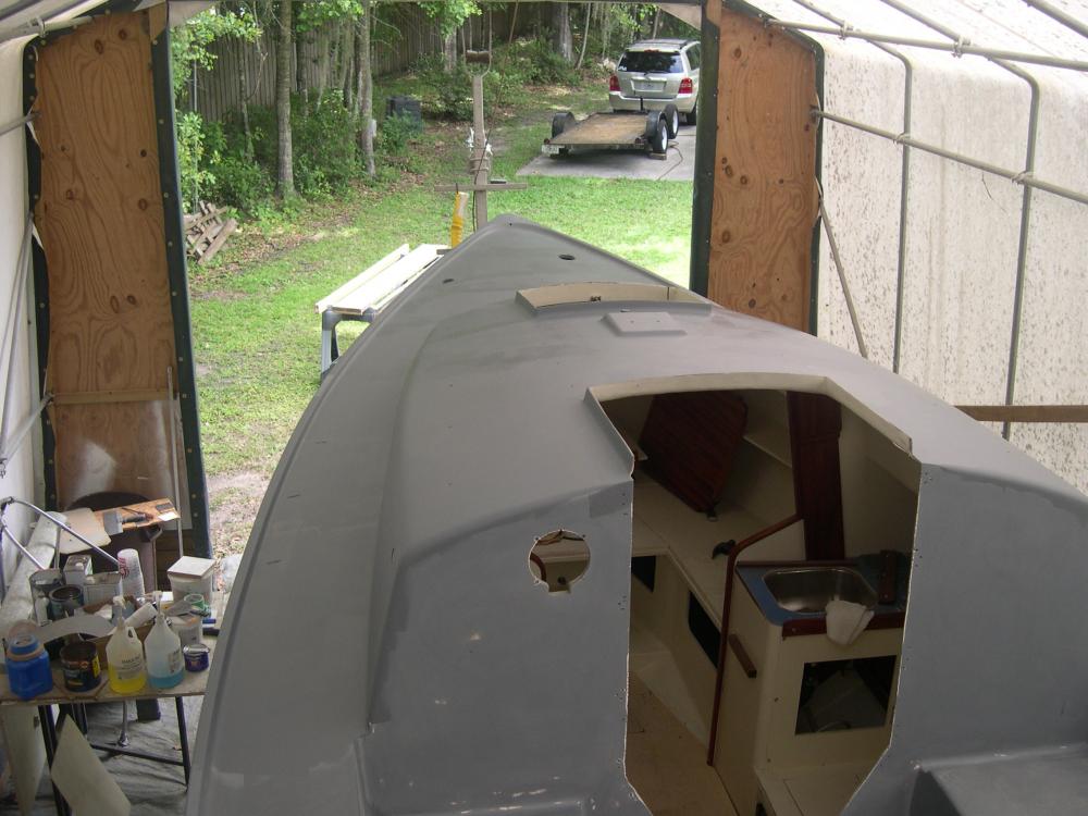

    So after I finished the recore in the cockpit floor I had to fair that area out. And while I was working on that I went over the entire boat fairing everything that needed it in preparation for the primer.
    When I was convinced I had it all I started priming the hull and deck with Awlgrip 545. That's when I found out I did not have it all. I found a lot of small issues when I primed her that I fixed as I worked on the primer.
    The first couple picture below is after the primer went on.
    On the hull I was able to only primer her once and sand it smooth. The deck was another story. I had to prime her sand her and prime her again and sand yet another time.
    The last three pictures are of her being painted. I found a guy in Tarpon Springs to spray her with Awlcraft.

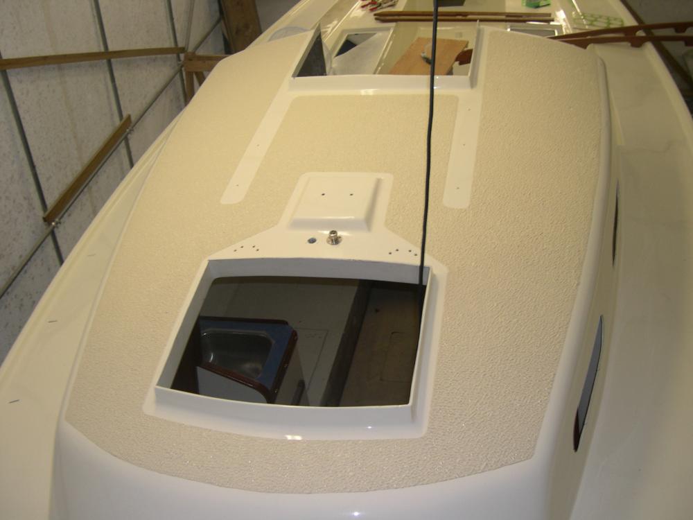

  15. #315
    Quote Originally Posted by Commander227 View Post
    She looks fantastic, whatcha using for non-skid?
    Funny you should ask Mike. I spent a LONG day yesterday working on just that! All I have done so far is the companion way hatch, the hatch over the v-berth and the cabin roof. Take a look and see what you think. It's Kiwigrip.
    BTW Mike I no longer have your e-mail address could you please shoot me a line via e-mail? I have a really good friend who I sail with often and he wants to come see your commander.
