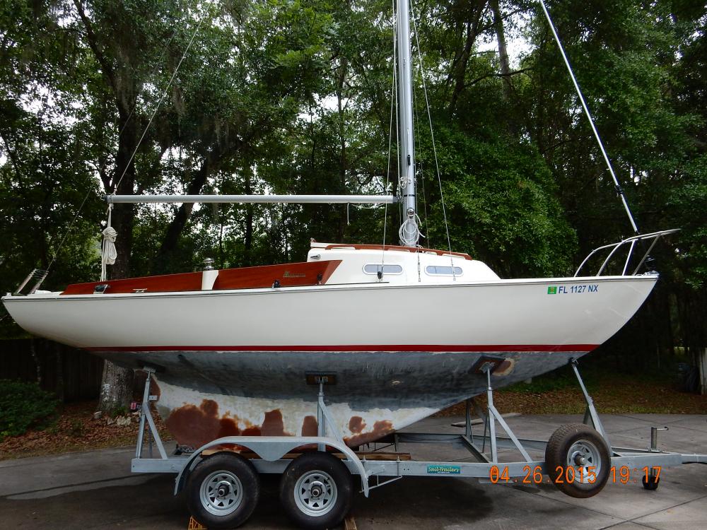

    Mast support

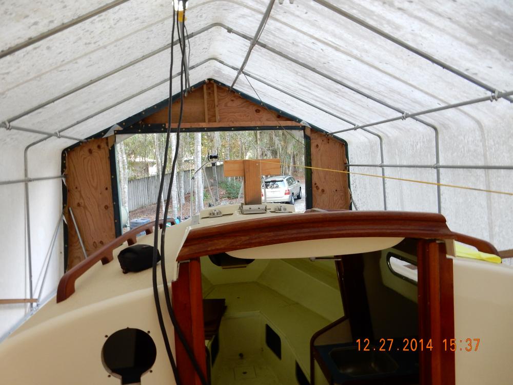

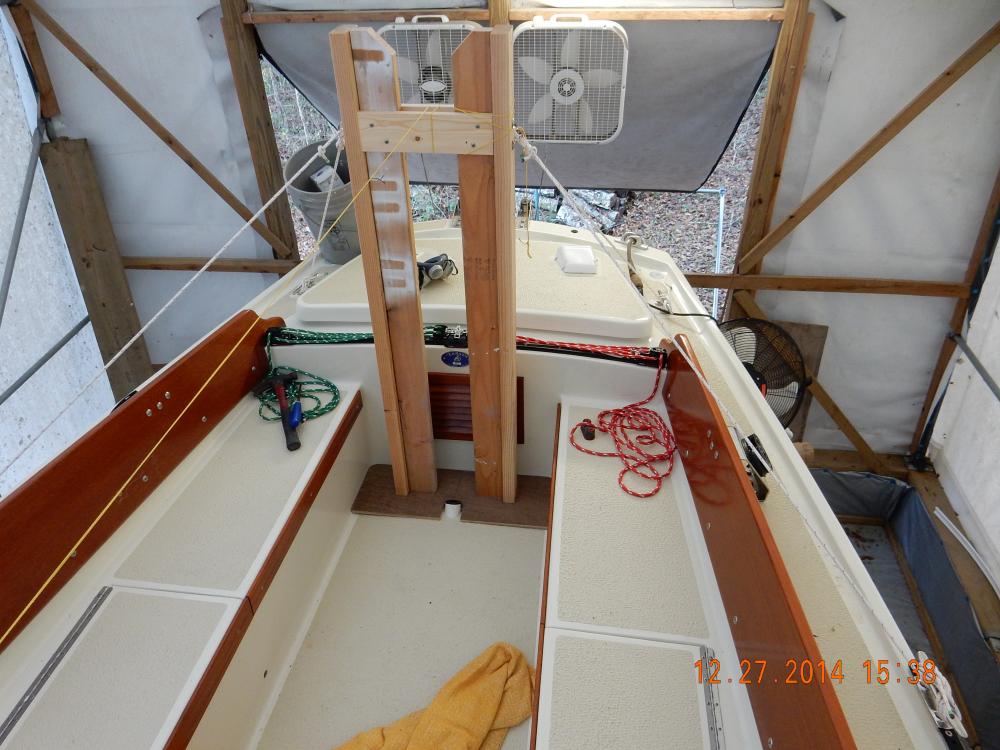

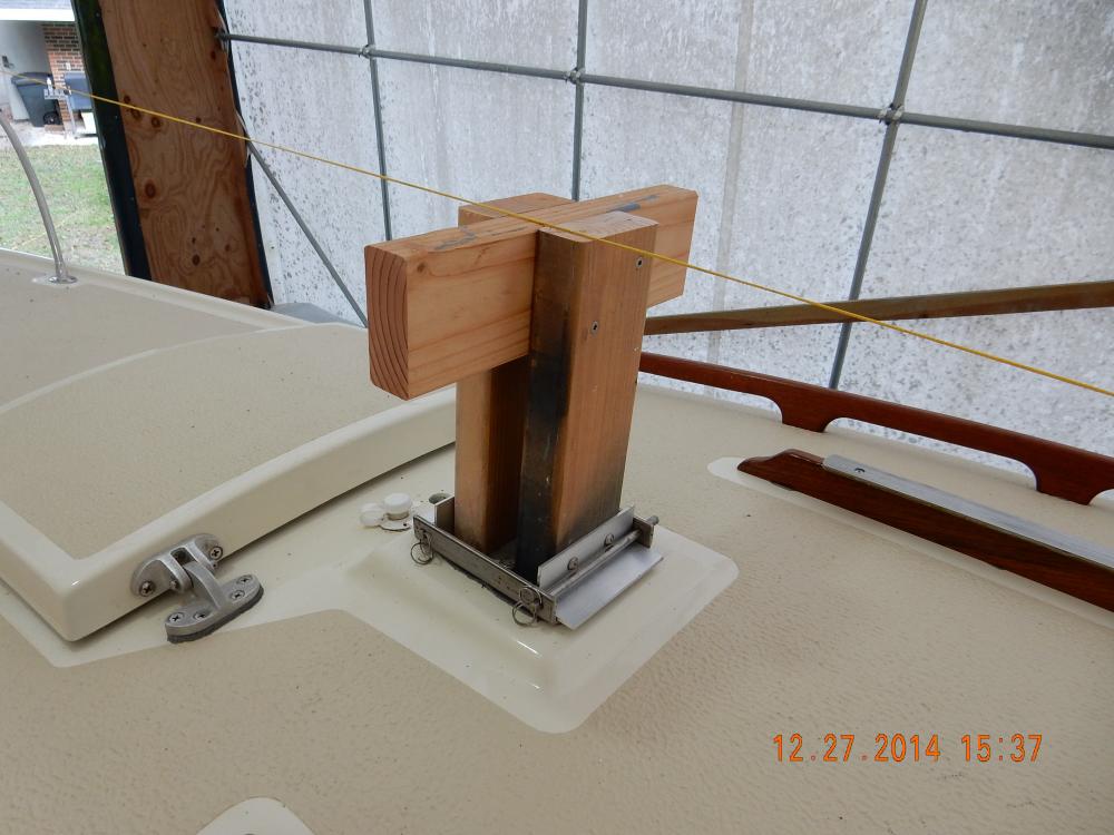

    Since I am not putting the stern pulpit back on Destiny I though a long time about how to support the mast for travel. This afternoon I built a support at the back end of the cockpit and another at the mast step to do just that. I was able to tie the back support off to 4 cleats (two stern cleats and two mid-ships cleats that mount to the genoa track.
    Because the forward mast support is part of the trailer and because the boat can get a little out of perfect alignment when going on the trailer the center support had to allow for the misalignment. So it is a support only. You can see the way the boat is on the trailer right now the string line does not land right in the middle of the center support.
    I'm trying to get the mast back on the boat (at least temporarily) so I can finish up the new standing rigging and measure for new sails.

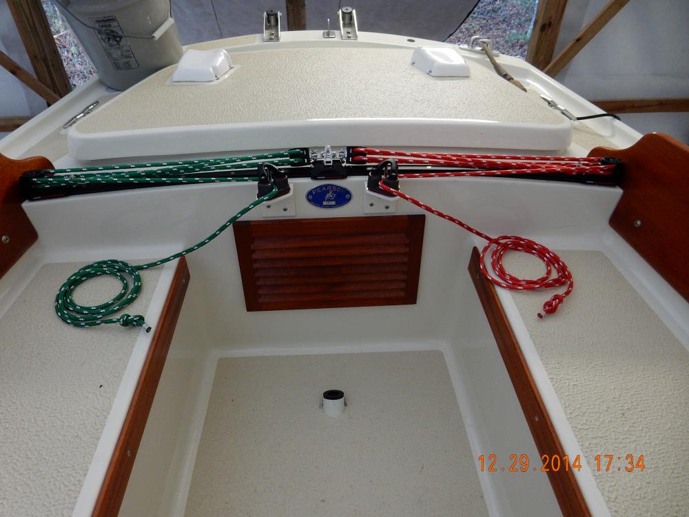

    Traveller install complete
    Did you know that according to Wikipedia the correct spelling for a boats traveller requires 2 L's? All these years I have been spelling it incorrectly.
    So anyway I got a small amount of time I could spend on Destiny today and I finished the traveller installation.

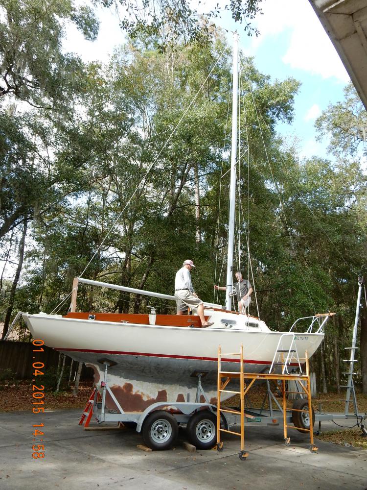

    Mast raising
    Stepped the mast this weekend so we could adjust the old shrouds, mark them and then use them for the pin to pin dimensions to make the new ones. I already have the new material here with swaged fittings for the top and mechanical fittings for the bottom and all of the shrouds were left long so once I got to this stage I could measure and make them up. So for the standing rigging it is finally show time!
    You will notice the boom is installed close to the bottom of the mast. I designed the vang attachments to the same size as the gooseneck so that when I was lifting the mast I could put the boom closer to the bottom of the mast to make the baby stays work correctly.

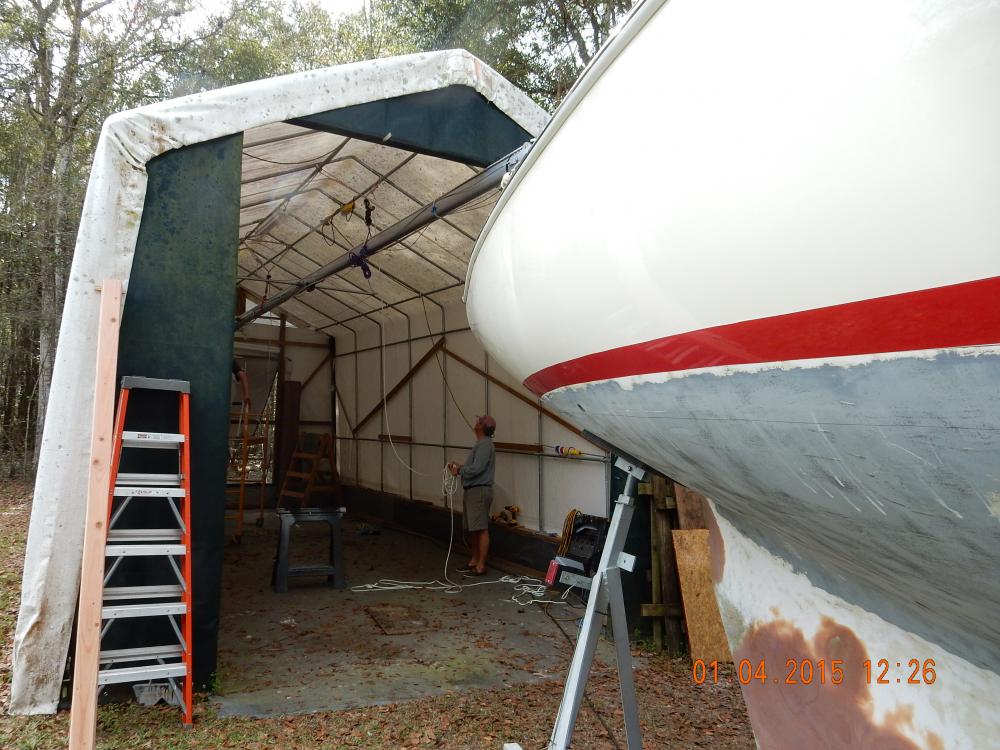

    Oh and a special thanks to my good friend Tom Scott who drove just over 2 hours each way to spend the day and help me with this process! Friends like that are hard to come by but I am lucky enough to have two of them. My other friend Tim who lives in Iowa but visits Florida frequently comes her to help also.

    Making up the bridles and baby stays to keep everything in alignment while it was coming up. That and getting the mast on the boat. We pulled the boat out of the shelter, hoisted the mast up to the peak of the shelter with the mainsheet and vang hardware and then backed the boat under the mast and lowered it onto the boat.

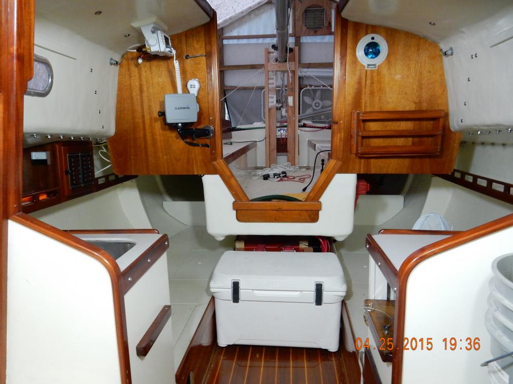

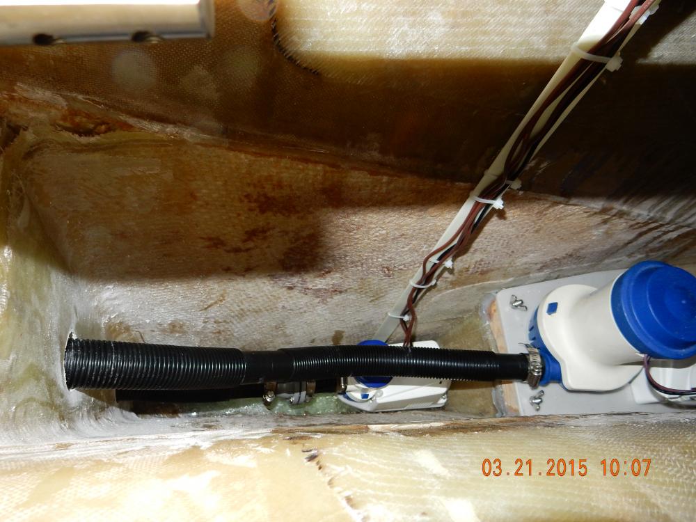

    Inside looking out and countdown to splash
    So all of the electrical is complete now. I got the GPS installed and wired and that was the last remaining piece to the electrical.
    Here is a picture from the inside of Destiny looking out. I did not put the new cushions in place for the picture and I noticed there is a cable for the antenna I forgot to tie up when I was working in that area but you can get the general idea.
    Also I stepped the mast again this weekend this time with the new shrouds and with the furler. This allowed me to work out all of the issues associated with the furler and a few other items.
