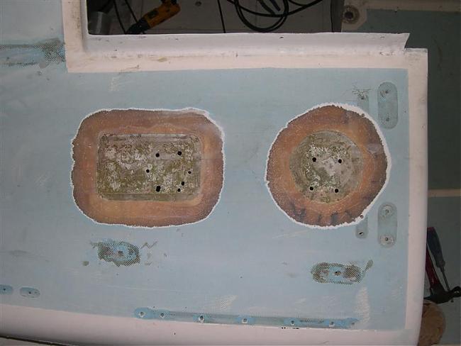

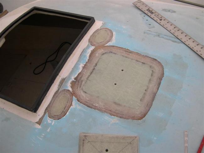

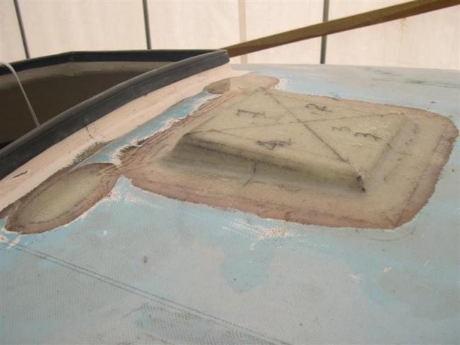

    Ebb I am happy to report that the 1708 biax stuck very well to the bottom side of the deck. I layed 11" wide area on the bottom of the deck and 4" wide on the side of the hull. I cut the pieces into a small manageable size that was only 9" wide. Then I wet out the deck and hull where I was getting ready to put the biax, and then the mat side of the biax. I would stick the biax up with my referance line right on top of the fillet where the deck and hull come together. Then add resin to the exposed woven side of the biax and imediately follow with a layer of 6oz. cloth to minimize the amount of fairing I have to do later.
    The first picture is what it looked like after I had the glass in place. It actually went very well.

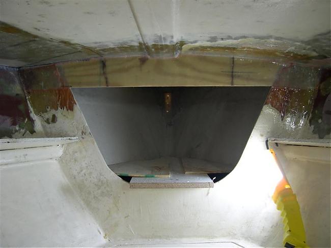

    The next picture is some future planning work I'm doing. Initially I plan to have my halyards terminated at the mast and I will mount a couple of winch pads on the mast for the halyard winches. But as I get older I may decide I want to run them back to the cockpit. So the second picture is of areas that I am making solid glass pads for rope clutches and winch bases.
    And since I need to recore the bow area and because I wanted to make a more substantial mounting point for my bow cleat I glassed in the top of the bulhead leading to the chain locker.

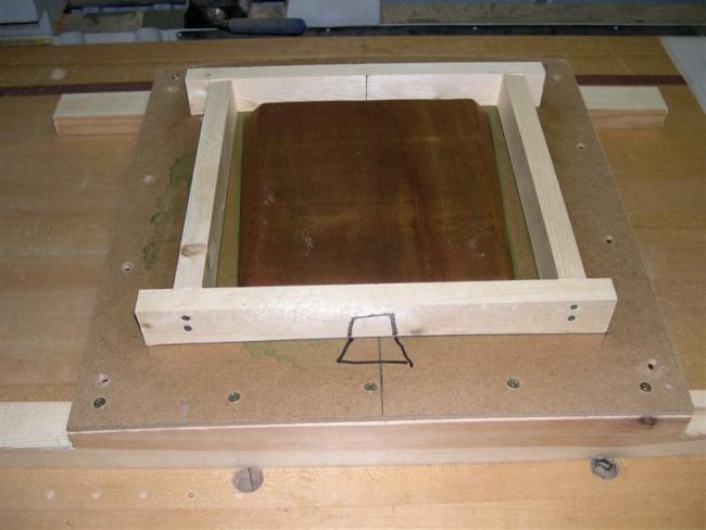

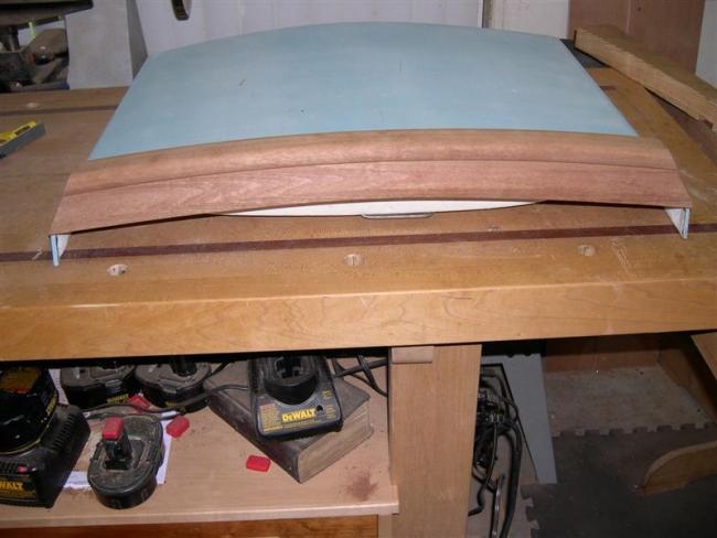

    Destiny gets a new hand hold on the main companionway hatch
    The little piece of wood trim that came on "Destiny's main companionway hatch did not allow for an easy way to grasp the hatch and slide it back and forth. So I decided to make somethiing for it that was more accomodating to my fat fingers.
    This was not a real easy task as I found out when trying to make the new hand hold. The curvature of the hatch is not a smooth radius so I found I had to first cut and shape the bottom of the new piece to match the shape of the hatch. Then 2-1/4" above that point I had to draw and cut a true radius that would allow me to use the top as an indexing point for the 4 router bits it would take me to make the profile I wanted to make.
    This first picture is the profile of the new hand hold.
    Name:  hatch hand hold.jpg
    This second picture is the view showing how it looks on the hatch.
    Name:  companionway hatch hand hold.jpg

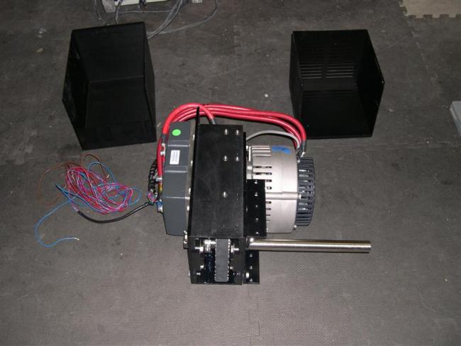

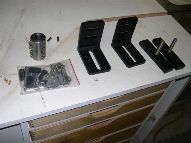

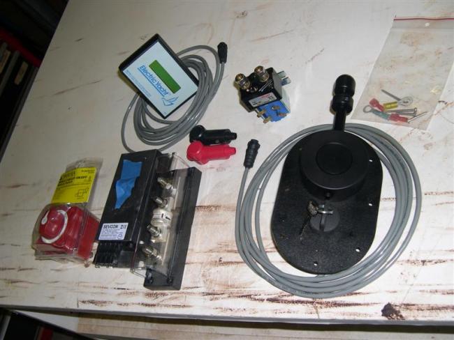

    Today I received the electric inboard drive for Destiny. It is really nice to finally see this thing in person and get a feel for what is in front of me for the install. It is also nice to see the apparent high quality of the parts and pieces that came. For me (I am NOT an electrical engineer) it was really good that I could find a vendor that supplies a complete package that is all designed to work together. I know Mike saved money by doing his piecemeal on C227 but I was willing to pay the extra for a complete packageName:  drive mechanical componenets.jpg

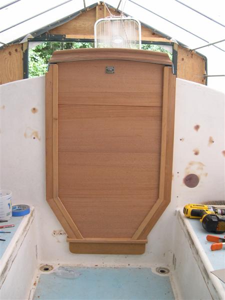

    Well, I lost about a month of progress thanks to a sinus surgery I finally had done that I had been putting off for close to 10 years. I can breath better now and in another month or so when I'm finally healed up completely I will be happy it was done.

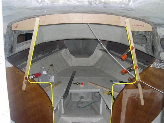

    In the last couple of weeks I have made progress in a couple of areas. First I did all of the final fitting to the wood for the companionway (picture 1 below) only to take it all back out for finishing. When I get to the end of the project and start putting all the wood back in I want things to progress quickly because I will be really excited to finally have her done. So getting all of the wood pieces final fit and finished now will really help then.
    After I finished that I demo'd out the compression post and the little boomerang braces at the top of the cabin so I can start my strong back install. I never plan to do a solid door leading to the v-berth because in my opinion in these small boats it just takes up too much room. I plan to do a curtain on a track so the ladies can have privacy. That being the case I decided (after talking it over with my friend Tom) it would be good to try and keep the cabin as open as possible and still get the support I need for the strong back. So the second picture is a mock up of the direction I'm heading on the new bulkheads (I will be removing the old bulkheads and replacing with new).
