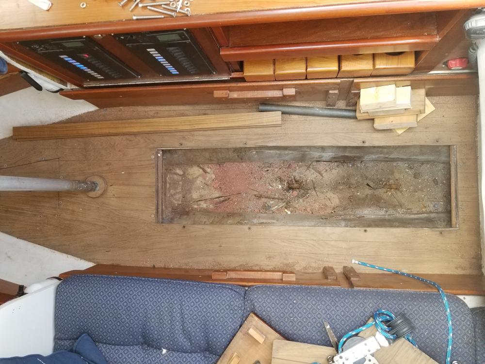

  8. #68
    Apr 2015
    Chicago, IL
    129
    600 LB Adjustment
    I removed the corrector weight today. Not too difficult although I was worried the lag eye I installed to lift it would pull out. As soon as I got the piece upright I tied a couple of safety lines around it and pulled it out of the boat. We'll see how the boat behaves without the additional ballast. I opened up the floorboard to make the removal easier.
    Name:  2017-06-13 14.56.37.jpg
    Name:  2017-06-13 14.57.33.jpg
