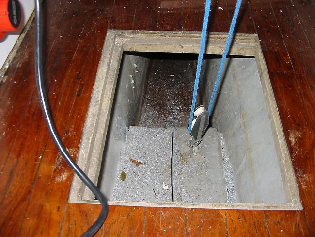

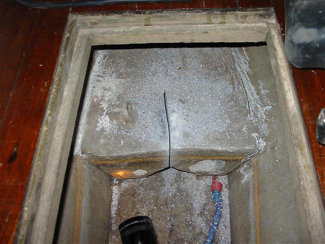

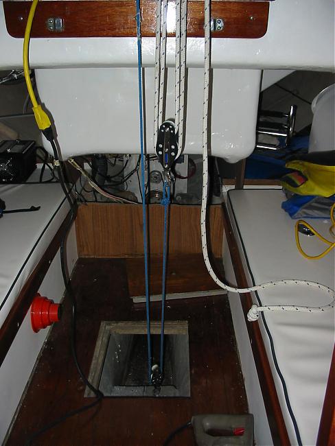

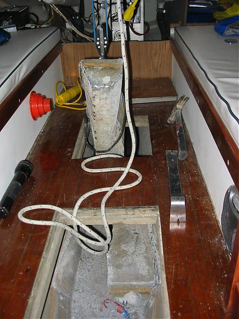

    The process;
    First I cut the fiberglass tape holding it in place.
    Being the compensator was wider than the hatches and 500lbs pretty unmanageable I cut it in half lengthwise with a saws-all. The notch down the middle made it pretty easy, although I had to lift and pry it back and forth to finish the cut between the hatches.
    To get the halves out I had to slide them back to the deeper section of the bilge and lift the front of the pig out of the aft hatch. I used a stout piece of steel square stock accross the companionway and my vang. I ended up having to throw in a cascade to get 8:1 as I could not get it to budge with 4:1.
