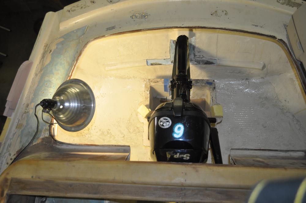

    We've been stocking up on boat stuff lately. One of those things was a new outboard-finally!Name:  DSC_0048.jpg
    Of course we have to modify the lazarette a little bit to make it fit. Fortunately enough people have already done this mod so all I have to do is copy what someone else has done.Name:  DSC_0049.jpg
    I was ready to give up the traveler but it looks like we will be able to juuust sneak the OB in behind it. Whew..Name:  DSC_0050.jpg
    So it's time to clean the slate and get started again. Thanks to Ebb, James Baldwin, and everyone else for doing all the hard work up front.

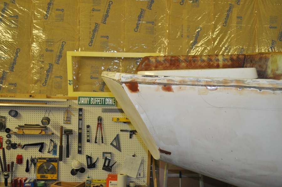

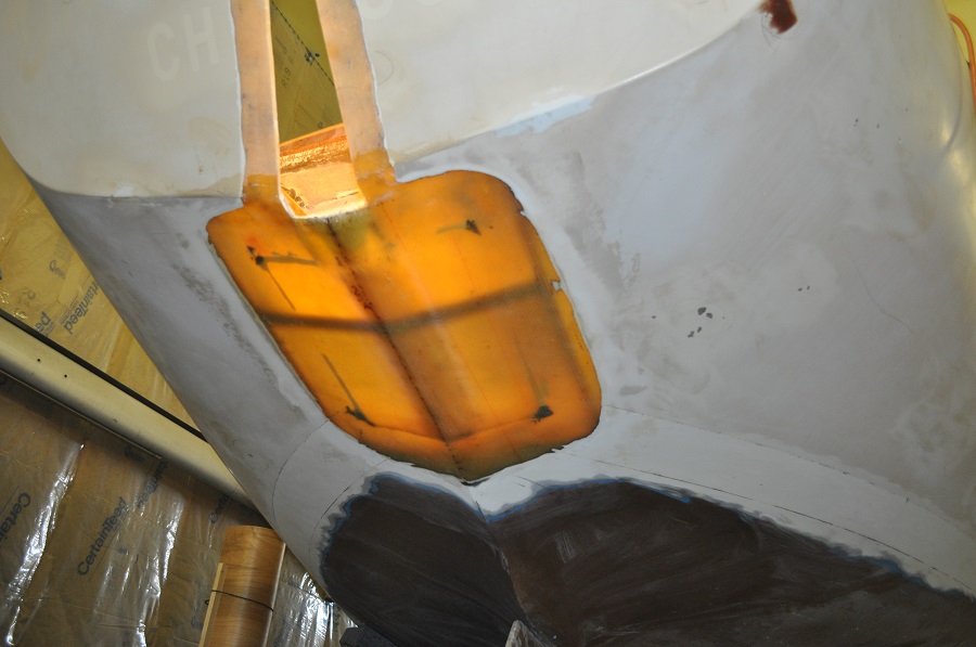

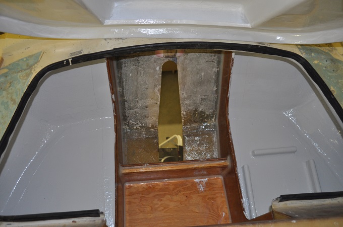

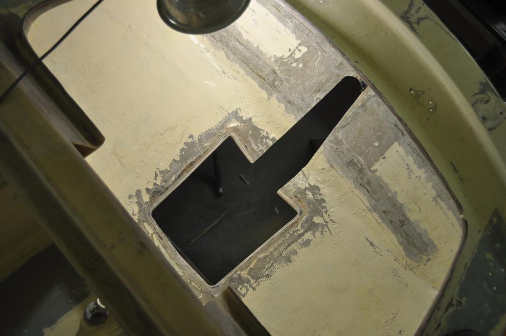

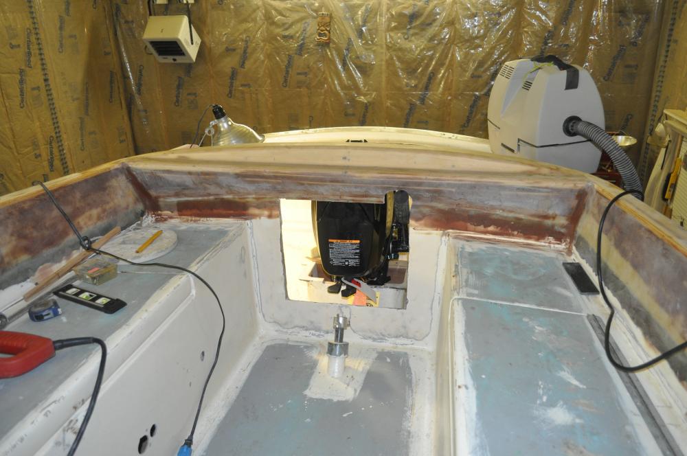

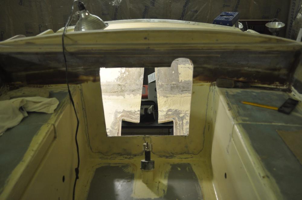

    There has been a lot of work going on here but they're all small jobs that have to be done before anything noticeable can happen. So for three weeks of working on her in the evenings and weekends, it is kind of disappointing we can't see more progress. But I hope that all changes soon!
    Even though we've finally found a local source for marine grade plywood, we have been double coating all the pieces with straight epoxy, and additionally, many of the pieces have been getting either 7 ounce or 3.2 ounce cloth added for more wear and tear protection. I figure it is cheap insurance being most of the added weight is in the epoxy itself.
    The outboard well modification has consisted of: finding where the outboard actually had to sit, fore and aft, in order to still be able to swing the lower unit up out of the water, cutting out the factory "collar" after we gathered some landmarks, then grinding (yeah!) back the buttocks so we could add a couple (3) layers of 1208 biaxial to form the new outer "skin" that used to be the outboard well, grind back a much larger area inside the lazarette to add four more layers of 1208, then just copy what others have done to make the same modification.

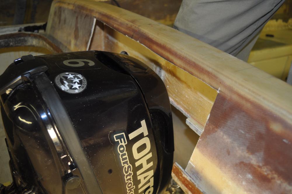

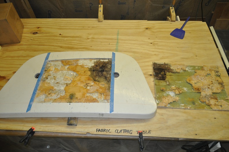

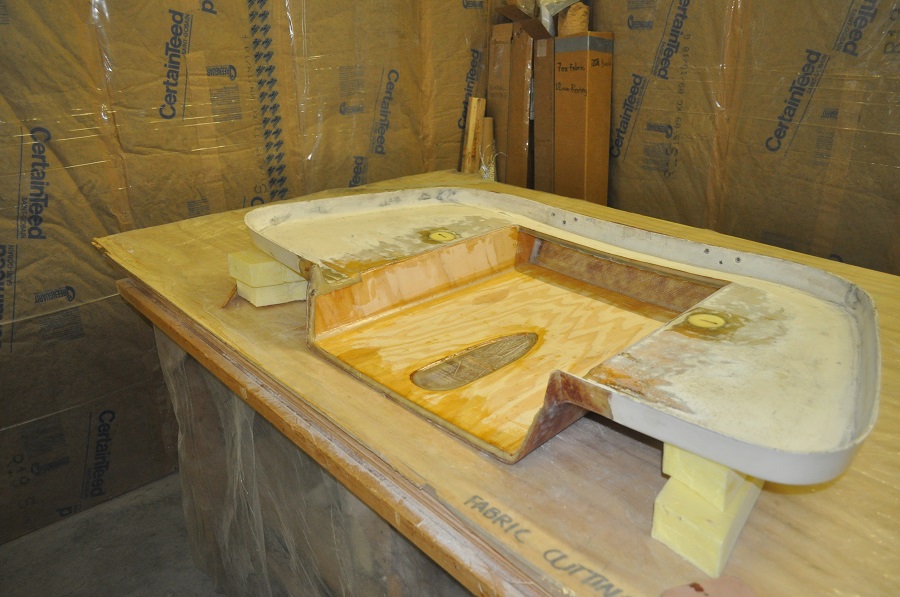

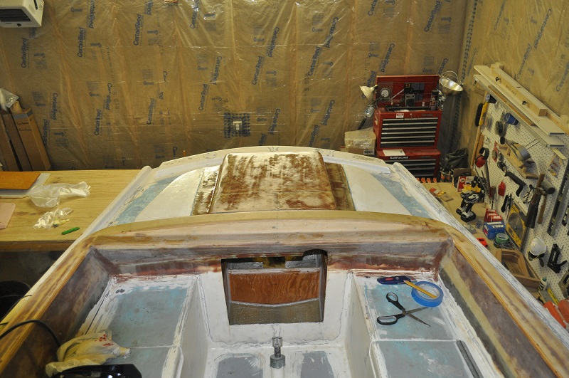

    We really lucked out, in my opinion, that the wrap-around coaming I added a few years back can remain in place, along with the traveler, after adding this mod. We did have to cut a "chunk" out of the back side of coaming but there was enough structure left to beef up and keep some strength there.
    The lazarette hatch is a different story though. One of the previous owners added a couple of clam shell vents to the hatch on their watch, but never isolated the coring after cutting the 2" vent holes and poking a couple of screws through the top skin. Needless to say there was some delaminating going on in that area, but in reality, I never felt that was an area I'd be walking around on anyway. Maybe I'm wrong there. I am very happy to say there as no delamination anywhere else on the boat though!
    We added the obligatory "hatch hutch", or, "bump" or whatever you want to call it. I started by cutting out the top skin to roughly the internal size of the bump and removing the core along the sides that would remain.Name:  skin and core.jpg
    Then we made a male mold out of Styrofoam and covered it in plastic tape to act as the release agent. I tried to follow the lines of the cockpit foot well for the taper, the arch of the coaming for the top, and the angle of the reverse sheer of the transom. The form received two layers of the 1208 and a single layer of 3.2 ounce. Yes, it is a bit "rough" yet and will get several layers of micro balloons to fair it out. If you notice, you can see the print on the tape showing through.
    Name:  laz profile.jpg
Size:  223.1 KBName:  laz stb qtr.jpg
    Once the new top skin cured, we flipped the hatch over and cut out the bottom skin and the forward piece of the remaining original structure. I was a little nervous hoping that I didn't severely weaken the hatch turning it into a bigger project, but it seemed pretty rigid for what remained. Although no where near strong enough to be used in its current state. We added a core of 1/4" marine plywood in a simple slab. I toyed with the idea of cutting the core into a XX shape in order to added more of a multiple stringer-like, or, webbing-like structure, but in the end kept it simple. If I find that the coring doesn't add enough strength as is, we can always add transverse stringers.
    Name:  laz hatch recoring.jpg
    The cut-out in the coring is to allow a little more room for a couple of protrusions on the back of the outboard when it is tilted forward in the "sailing" position. This side received a layer of 7 ounce cloth to tie it together. Tomorrow evening I'll get to see how stiff the piece actually is after curing for a couple of days.

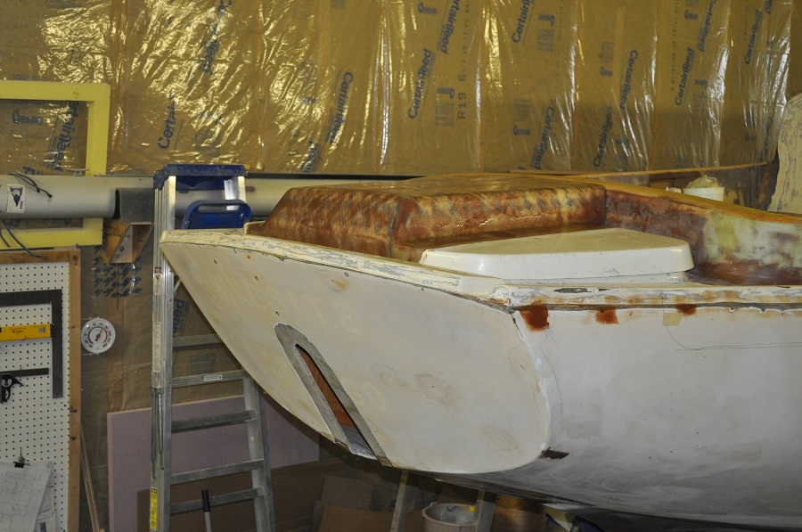

    gratuitous photo...
    Here is another one that shows how crude the interim finish is, along with the lines of the foot well.

    Nope. Nothing I've done here would help a two-stroke breath in a closed up lazarette. Fortunately, the outboard we purchased exhausts through the propeller. If we ever have to replace the motor with one that exhausts out higher up on the lower unit we'd either end up propping the hatch open or modifying the exhaust similar to what Mike (C 227) did on his Honda generator.

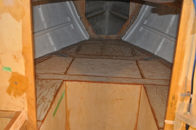

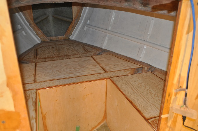

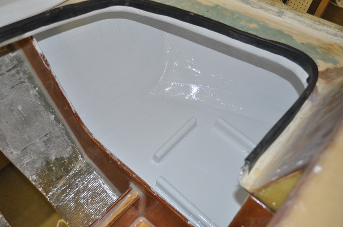

    It has been a long time coming but I finally have a place to take a nap on board!
    All of the locker lids have been cut. None of these will be water tight lockers even though it would be an easy enough conversion if we find that necessary in the future. Only the new chain locker lid and the lid over the water tank will have barrel bolts to secure them. The other lockers will probably just have finger holes for lifting them.Name:  v berth deck.jpg
    There will be a filler piece that will go over the head that will set in the v-berth just forward of the main bulkhead. Also, you can notice the strips glassed in for the ash ceiling strips we intend to apply. We are going to skip the insulation to see if we really notice a need for it. If so, it's an easy change to make next year.Name:  v berth deck 2.jpg

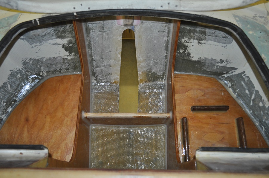

    Meanwhile on the other end
    Not a lot of action on this end lately. We are waiting for me to remove the old-new backstay backing block that I put in, oh, about a decade ago. Once that is done we will add a new-new backing block. Being the outboard slot takes up a majority of the center of the transom, we'll move the backstay chain plate off to port a little bit.
    Here is a shot of the gas tank shelf with the necessary cleats. The starboard shelf hasn't been dedicated to anything specific as of yet. The bilge pump outputs will pass through the area, but so far, that's it.
