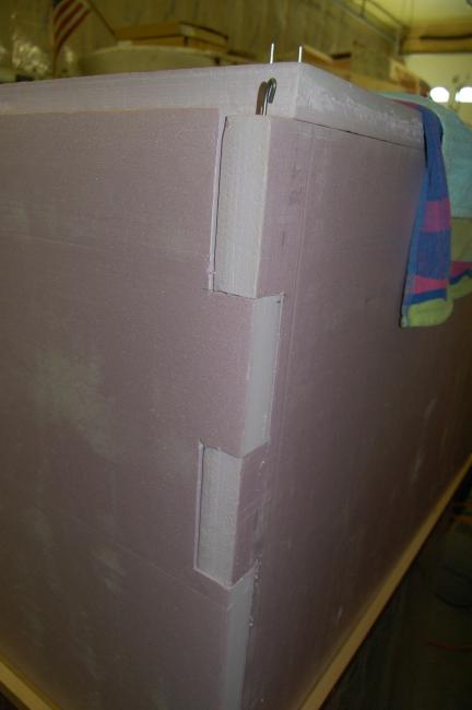

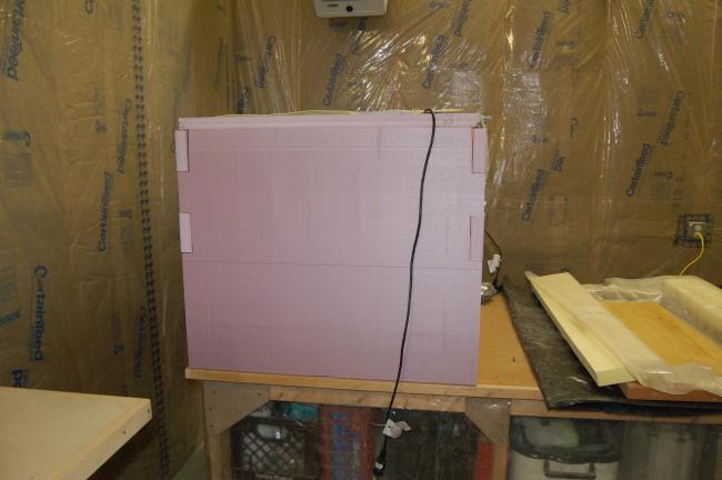

    The weather outside IS frightfull...
    Because it isn't feasable to keep a decent temperature 24hrs a day with the little 5KW heater we have, I've been trying to think of ways to at least get the chance to glue small peices together. Some of the small electrical heaters still use 750 to 1500 KW and that's a lot of juice for what you get. So I got a couple of sheets of 1 1/2" styrofoam and cobbled together a "hot box" that is 36"w x 48"l x 30"h. The corners are pinned together with 1/8" x 18" rods which makes it easy to put together and pull apart. It is heated with two 100w bulbs in reflectors. I don't have a thermometer handy but it was nice and toasty in there this morning while the ambient air temp in the shop was near the mid thirties. (outside temp was 14)
    Name:  corner detail.jpg
Size:  20.5 KBName:  hot box.jpg
Size:  31.5 KBName:  jig in hot box.jpg
    I still have to come up with a way to heat the hull and cabin this winter if I want to lay down some epoxy. It may be just a different version of this as I don't want to invest in a bunch of heaters. I can heat up the outside of the hull by directing the gas heater toward it for a short while as we bring the shop up to temp before going to all electric heat. Then it may be up to some more reflectors and a means of clamping them in place for twelve hours. I've even thought about getting some electric blankets and draping them over the hull adjacent to where we're working to see if they could hold a constant temperature. Any ideas out there?

    Well here's what I'm trying first. I rolled out to the box stores today and picked up a couple of cheapo digital min/max/current thermometers and one big dial thermo. The dial one is for the shop so I know the temp in house. One of the min/max thermos went into the hot box. With two 100watt bulbs running in there and a shop temp of 55deg the box temp was 92! Warm enough.
    I also picked up a sheet of foil backed 3/4" styro and cut filer pieces for the four ports in the cabin, one for the main bulkhead, a piece to fill the opening from under the cockpit and one that covers the main hatchway. I put 3 more reflectors with a 100 watt bulb in each securely clamped in the main cabin and closed her up. After about 45 minutes we were up to 60 degrees. I will swing by the shop tomorrow before work and note the max and min temps. Fingers crossed.
  10. #490

    Well here are the preliminary shake outs. The shop stays "relatively" warm overnight if I go there for a couple of hours after work consiering the outside temps. The ambient shop temp was 45 degrees at 7:15 a.m. with the outdoor temp down around 17. The hot box was 69 degrees, which was the 24 hr. low temp., with just one light burning overnight. So the hot box will work for gluing or coating or what have you. It appears the limiting factor is going to be it's limited volume and in response we will have to make a racking system that glue and epoxy doesn't like.
    The boat was a bit different though. With three 100 watt bulbs going over night the high temp was 60 degrees at the level of the side deck turn-out from the cabin trunk. That was the temp when I left her the previous night in a pre-heatd shop. The low temp recorded, and the temp I found the following morning was 52. Not good enough. So I fashioned a stable stand and adjusted all three reflectors to shine on an area of approximately 2' x 3' of the hull and set the thermometer slighly off center of the "hot spot". The following evening the shop's air temp was close to 50 degrees (outside temp of nearly the same!) and the thermometer's low recorded, high recorded and present temp was 79 degrees. That would work. One problem I see is fashioning a stand that will allow the reflectors to be aimed with the propper orientation.
