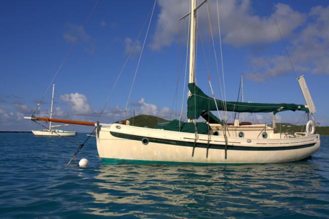

    Tony, your first toe rail mockup made me think of the BCCs...
    This particular one opted to go the paint-it route - looks good too!

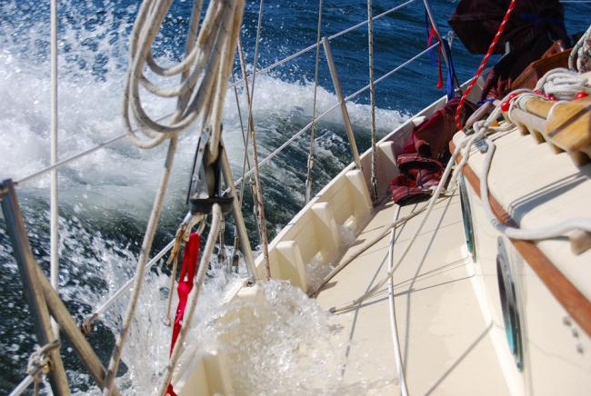

    Nice secure deck with those bulwarks...

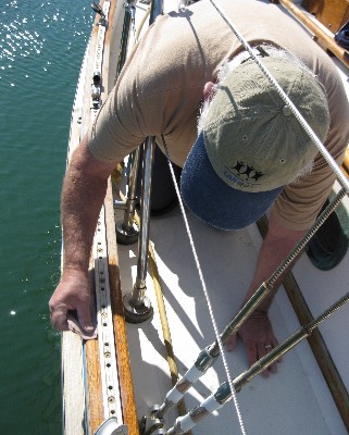

    ...Then you pulled out those bronze rail chocks. You should definitely design around those babies!
    How about a toe rail treatment similar to your coamings? Build them up with fiberglass - you wouldn't have to worry about thru-bolting. Then, you could top them off with a nice mahogany cap so you'd still have something to varnish.

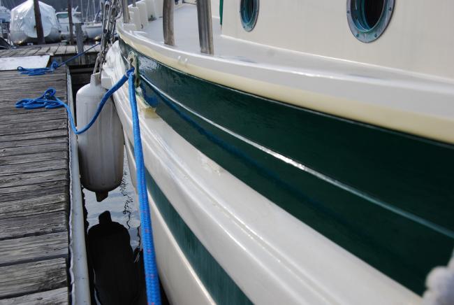

    I have very strong opinions on rub rails...here, let me share them with you. If you do not agree with my opinions it is because you are wrong.
    The rub rail is there to protect the finish on your boat and act as a bumper. It should stand proud of the freeboard and be able to take some abuse. It should be something you are comfortable using. Tough. Plastic or rubber with stainless. Not pretty and fragile. You have a full keel and a small rudder, you may need to put that rub rail up against a piling to pivot your boat out of a slip. (you know it won't turn in reverse against any kind of wind.) Wanna stop in somewhere against a concrete or rusty sea wall? Fenders are fine but tend to flip out of the way when you really need them. Don't put soft wood under glass, you will crush it. Use oak if you must but know it is sacrificial and will look like crap in a few years, it's pretty hard to maintain bright work that is bolted up against your hull. Look at the plastic rub rails on the Com-PAC 27 and 35. Alot like what you have but tough and usable.

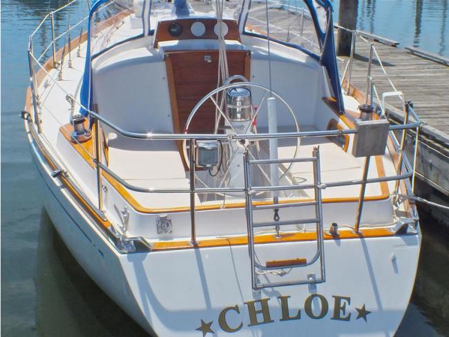

    Saw this pic today and it reminded me of what I imagine Tony's coaming treatment will look like:
    I like those stern chocks too!
    Attachment 8238
    Mike you are a genius! I don't know why, or how many times, I have read that and it just didn't sink in...I are a idiot...well, a dolt, at the very least. That sure would make things easier as far as maintenance goes, with the exception of varnishing. Plus we could make them as high as we wished. Toe rails could be bulwarks if we want! The only substantial bolting needed would be where the chocks get mounted, and that would have to be worked out being they are pretty skinny lengthwise. There is one wrinkle though. I cut the mahogany into those 2" to 2.5" strips years ago anticipating attaching them on their edge. I don't know if I could steam them enough to pull them into a flat "cap"...
    But I like this idea! Mucho gracias senior Mike!
