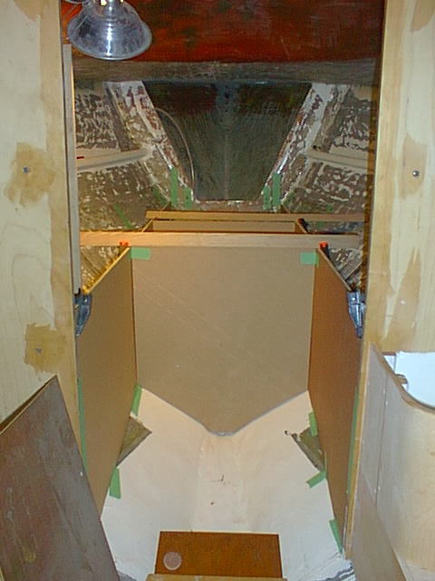

    soft-side head
    Tony, we just don't have the beam of even a Flicker!
    Suggestions, you know me, always suggestions.....
    Suppose you did have the head where you show the cardboard model.
    But instead of hard sides you had soft sides. We've got super Nylon zippers now
    - you could have a zip open door in a CANVAS enclosure.
    Knees could poke into the sides until the body is settled
    - maybe it could be large enough to turn around in.
    Could have a second set of zippers that will unzip the whole enclosure and gather it at the side.
    A head doesn't get that much use, but it could be made to zip into a private space without too much fuss.
    Test it out with cloth model. And it could be made larger because it is temporary. Permanently temporary.
    There are many extraordinary fabrics these days there would be something for the job. I like the tan of the cardboard.
    It could be a relatively heavy material so that it holds shape without wrinkles or folds. R, why not Sunbrella?
    By the same token, more room can be found over where the portside cupboards used to be at the main bulkhead.
    Might even have a fold down sink there. But it could be the same fabric enclosure that would be gathered out of the way for open space.
    The problem really is that the deck gets in the way of the head. The human head.
    The loo would be under a cushion so the function wouldn't be noticed right off.
    There would always be the option when using the throne to zip up the canvas cabin - or not.

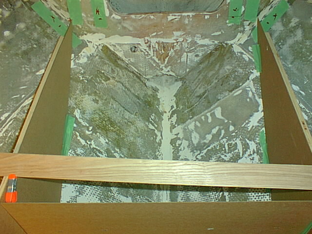

    I lopped out the starboard corner head a while back, partly due to the same concerns Mister Tonygee cites; the hard walls I was using were just too much structure for so little (in use as well as in size) space...
    So I bounced the head idea around a while. Put it back up front in the middle for the longest time. Then one day, when I was ripping out the sink and looking at all that space under the companionway, a Thought occurred. All that space there, and when we use the loo, we usually sit anyway...
    Lately I've been experimenting with a composting head. I have nearly all the stuff needed to mount a 'traditional' wet head, and was aiming that way, but thought that just for the sake of completeness, if nothing else, I should try the composting head thing... People speak so highly of it, and all...
    Well, I "invented" a ~$10 version of those phancy shmancy $1,000 heads (using a 5 gal bucket, an odd-shaped funnel, and a plastic coffee can), and have been using it for about 3 weeks now, and I can attest to the facts of why people like them so much. There really is no odor, none appreciable, other than that of peat moss, and then only if you take the time to try and notice it. And I don't have a fancy fan and tube ventilator, either... Tho' the boat does stay pretty much open 24/7...
    And I've been keeping it there under the companionway, in a makeshift, temporary, 'try-b4-u-buy' construct meant to simulate a fold-up water cabinet idea I've been totin' around in me noggin.
    This weekend, I took the plunge and cut out the sole platform at the base, thereby recessing the 'posting head bilgeward, so that the top of it sits less than 12" above what is the floor under most of y'alls sinks. I am imagining a curtain that wraps around it to be used as both a privacy- and shower-screen.
    It's working out fairly well. I'll play with it a bit more, see what strikes as most practical, then post some photos for y'all who might be interested.

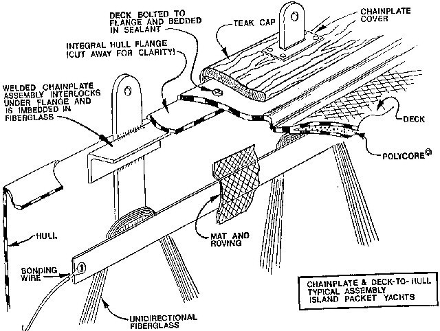

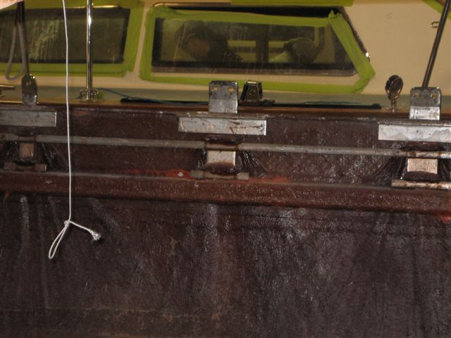

    Chainplates - I'm borrowing a bit from here and there. Craig/Faith has me talked in to using FRP only for purposes of longevity and no maintenance worries, and I'm taking a page from Island Packet with how they distribute the shear forces on their boats.
    Their chainplates are basically a grid made of SST plate; think of a sort of elongated TicTacToe board, placed up against the hull inside. Then take fiberglass rope, about a thumbs roundness worth and say 6-8' long, weave it through the grid, and take the two 2-3' 'tails' down onto the hull, getting splayed out farther and farther as you get away from the grid. Think 'long blond ponytail', wet out, and the end spread to cover as much surface area as possible. An upside-down V, where the apex/bottom of the V wraps over the chainplate grid up and around the vertical members, and the tips of the V spread out to distribute the force across a wide area.
    I'll use fiberglass pads shaped like below, shooting for thick enough to double hull thickness there, bonded to the hull, and then do the rope thing over those pads to help spread the shear out and down. Bolts come thru the hole in the middle, with big washers and etc... Name:  chainplate_attach.jpg

    Your chainplates sound very interesting and seem to be a new twist. Is the diagram above your actual chainplate or the backing for chainplate attachment? The IPs have a neat set-up for tying their CPs together and distributing the load. Another plus is the addition of a bonding point for grounding is easily handled too. There are a lot more questions regarding this mod. coming for sure.

    The 3" vent itself will work with a solar nicro fan on deck (8" diameter?). Where does it go on an Ariel deck? And how does the hose get to it in the accommodation?
    I've thought of adding some sort of half round dorade inspired vents to the outside of the cabin up near the mast. The vent hose to the composter has to be kept in place all the time. Unless there is another solution, that hose is a PITA.
    By SST I assume you are talking about stainless steel.
    I think interweaving fiberglass 'rope' into holes would be extremely difficult.
    You'd be creating odd spaces that would be hard to fill.
    AND, since you would not be mechanically fastening the perforated sheet to the hull,
    I don't see what is gained by doing this? Plain fiber would probably be stronger imco.
    How about carbon fiber, no metal, as some of the racers are doing?
    It's available, altho the methodology requires vacuum forming with the stuff.
    One intriguing form of cabon fiber is that it is also available in tube form.
    You decide the diameter, because it stretches like socks.
    It is dangerous to encapsulate s.s.
    Though total encapsulation is theoretically possible.
    Aluminum plate (6061T6) comes in a variety of perforations.
    40% more thickness to aluminum, supposedly equals the strength of s.s.
    But you'd have the same encapsulation problem.
    Then there is bronze (655). Doesn't matter what you do to it. AND epoxy sticks pretty well if that's what you have to do.
    (Littlegull's external chainplates are waiting for me to slap them on. They are all polished and
    bling the topsides very nicely. I'm strut bolting through the hull with meranti built-up backing inside. You can cut and shape silicone bronze with handtools.)
    Good luck with that frp 'chainplate' idea. Have to see photos!!!
    [later edit] Island Packets must have rampant corrosion problems! imco NOT a good idea!
    Both with the weld AND with the partial encapsulation of the stainless plate.
    Both Pascoe and BrionToss will have you keel-hauled
  11. #371
    island packet chainplates [type this into google search window]
    google
    [DOC] View Word Document - The look on my crew's face was priceless
    www.Islandpacketphotos.compictures%5CAd_898_word doc
    (pretty sure that won't come up.
    Scroll on what looks like an email page to get the article.
    You will also see pics of Tom's 'string theory' in his repair.
    I don't think it'll work, but there you go...
    He fixed it so the same stress cracking will happen again!
    it's not just me that's having problems with this idea.

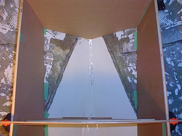

    Ok, as promised, this time around with patterns!
    I raised the platform in the 'berth'/closet/head/workshop another 2 1/2inches. So that's about 4 1/2 inches above the original height. I'm hoping to eek out every inch of room athwartship for sleeping. It will add some additional stowage and a smidgen of bouyancy with water tight compartments. At this level the tops of the compartments are a little more than eight inches above the scribed water line!
    In photo one you can kind of get an idea of the height but I've noticed in the past my photos just don't depict proportions very well. The bulkhead for the origainal chainlocker will get pushed forward about 6 inches. Well, actually a new one will get glassed in forward and then the original will be removed.
    Photo B shows where new storage will go. Because of the height of the new furniture some of the storage will actually have two layers or the ability to take a horizontal divider out and have one big storage box (where the contents can bang back and forth and wear on the surfaces, hence the compartmentalized compartments)
    The third half photo just shows the water tankage. Moved aft and considerably smaller than the plastic Cape Dory tank I just removed. The water tank will not be this tall. Only about two-thirds of this height will be tankage resulting in a little over 26 gallons. There will be shallow storage on top of it along with an inspection and clean-out port. While 26 gallons isn't much water this tank will be suplemented with another 20 gallons in a tank under the companion way.
    There you have it. Slow but pretty sure
