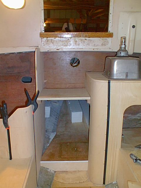

    Tony, are you planning to put the sink back in its original location there on top of the counter?
    Thanks for the compliments, captains. I'll be the first to admit I stole every idea incorporated into Dream Weaver this far and 'we aint done yet!'
    Still desperately searching for the best possible work surface/table arrangment. I thought we had found it in Frank's Revival but after changing 113's galley around it won't work there. The nav table refer location is mainly an inn table for the library. not really a ergonomically desirable work station. I'm back to eyeing the main bulkhead again. I seem to remember someone, somewhere storing a table on the overhead in their v-berth. That may be a viable option and if anyone out there has a link to that boat site.......
    The sink is going back in pretty much the same spot it came out of just a little higher and a little closer to the centerline and a little farther forward. I think we'll valve the drain though before it ties into the cockpit scupper drain and seacock assembly just for good measure. Hopefully that will still leave enough room for the gimballed kerosene cooker and some outboard storage under the side decks.

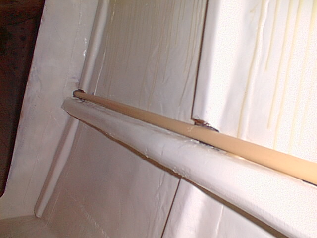

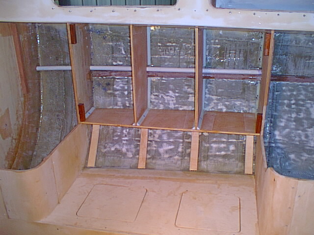

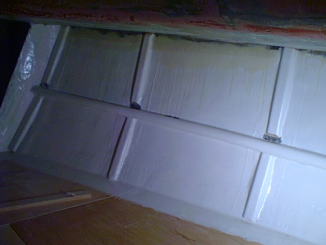

    Having recently given thought to the electrical system I decided I had to commit to a wiring chase forward from the electrical panel. That included a 3/4" PVC pipe through the main cabin and just through the mainbulkhead. Then we picked up a 1/2" PVC pipe to run through the v-berth area into the chainlocker/peak to handle the wiring run for the forward navigation lights. Of course this would involve hacking my way through the ceiling battens I applied to the hull some time ago.

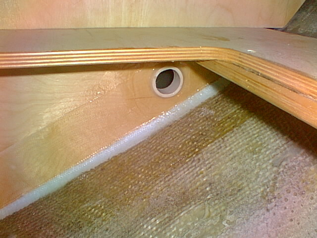

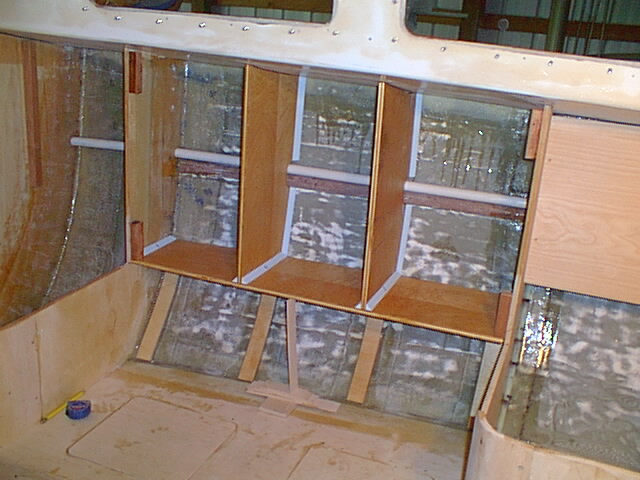

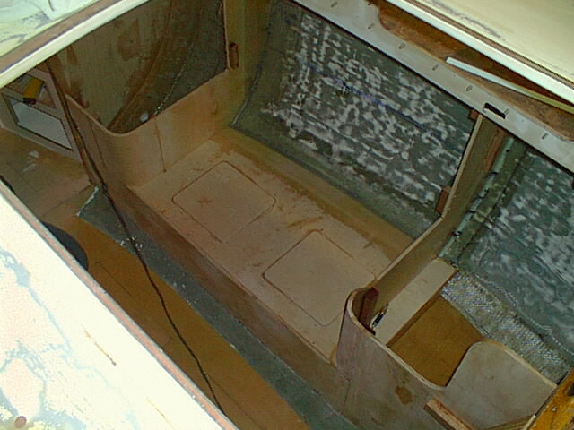

    Along with the wiring chase I made way for the plumbing to run from the head in the v-berth back to the holding tank under the cockpit much like Theis' set-up.
    I used short pieces of PVC just large enough in diameter to allow the 'flexable' plumbing to run through the bulkheads and setee dividers. The flexible plumbing will be caulked where it passes through the PVC stubs so the setees will be water tight (in theory).
    The edges of the holes were coated with unthickened epoxy first, then the PVC was wrapped in wetted matt and carefully 'twisted' into place. Later, after given a little sanding an epoxy fillet was added to smooth things out.

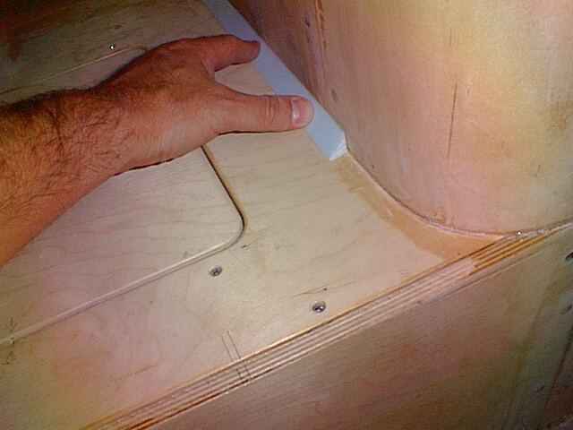

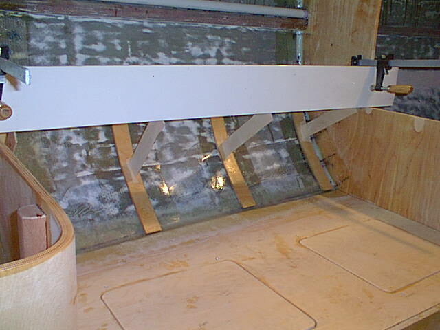

    Being these funiture pieces are not really structural and I wanted to expedite the whole process and save a little epoxy, I hot-glued these little styro wedges in for 'fast fillets'. A quick pass with a 1-1/2" sanding drum chucked in a drill gives a nice smooth form to lay tabbing over.

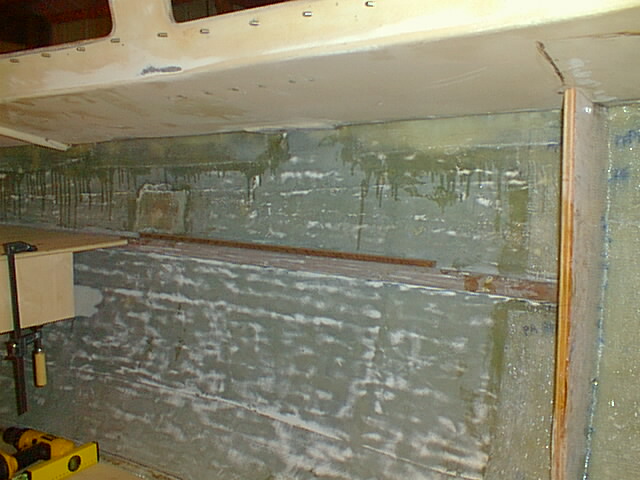

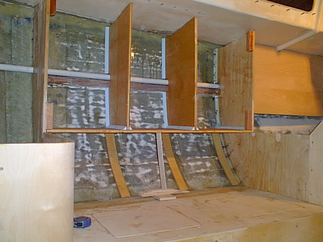

    We have all this re-sawn ash to use up so I thought as long as I'm waiting I might as well add some ceiling battens to the hull on the starboard side below the cabinets. This time I decided to use some of the 1/8" baltic birth ply lying around to make some curved battens that follow the hull's form.
    The curved furniture pieces got a final shaping and are glued in place. Well, on the starboard side at least.
