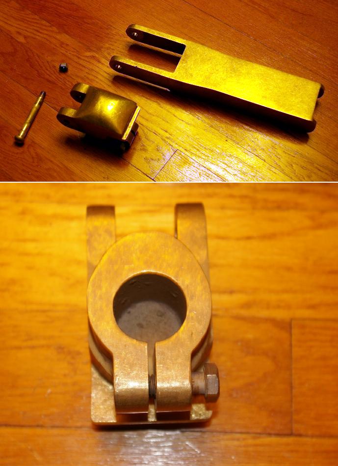

    Thinking i'd start with something that at least looked like our original pattern (and being told it could be bored for 1" ) I ordered the 1.5" pattern.
    Bunch of nice folks, the casting quality is very nice. one little problem, the casting they sent was cast with an 1.25" hole. Thought about fitting a sleeve or sending it back to get re-cast, I havenít decided yet..
    Hereís the new part:

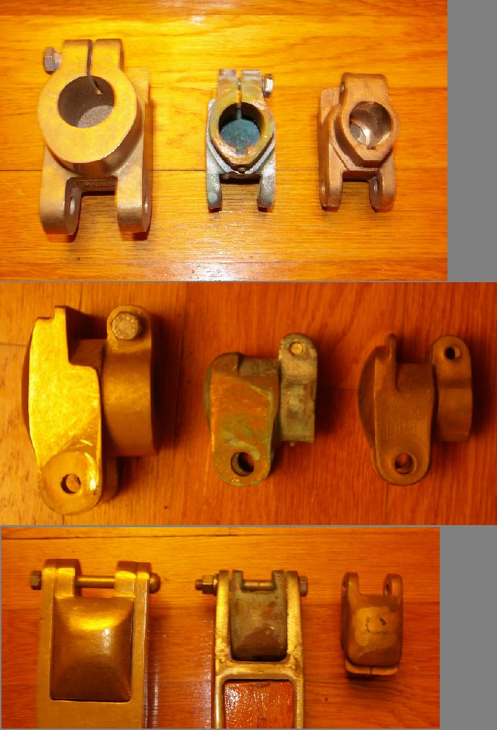

    Then just to add to the thinking, I stumbled on an unfinished rostand part that matches the original tiller head....
    here is a lineup of the HA 1.5" part, my wornout original and the rostand 1" tiller head on the right.
    you can clearly see the extra meat in the HA part as well as the wear on my old tiller head (note i no longer have the original pattern tiller part of this pair of castings)

    Doesn't the Rostand look like original pattern to you? The H.A. pattern is like comparing a porterhouse steak to filletmignon, no?
    Isn't that H.A. just too B I G ?
    Think that little machine screw will draw all that metal close togther - too much to clamp imco.
    Won't the old fork work on the new Rosand head? If you had to do that?
    Anyway thanks for those stylish photos!
    Don't understand why that Rosand won't work for us?

    I agree, the 1.5" HA part is a bit too large to make fit. Re-working the old rostand unfinished part will be way easier (it is an exact copy of the OEM part) ...

    However the old head in the photos shows some severe resculpting!!!
    Imco that's the result of an BAD fitting bolt.
    And as Ed points out a bad fit in the keyway.
    I imagine the bolthole in the fork got out of round as well.
    And as BILL mentions above, we have more on this subject elsewhere.
    And the reason for the tiller bolthole wearing is due to steering with the tiller held high. The sides of the fork should engage the cheeks of the tiller head at all times.
