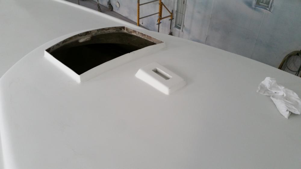

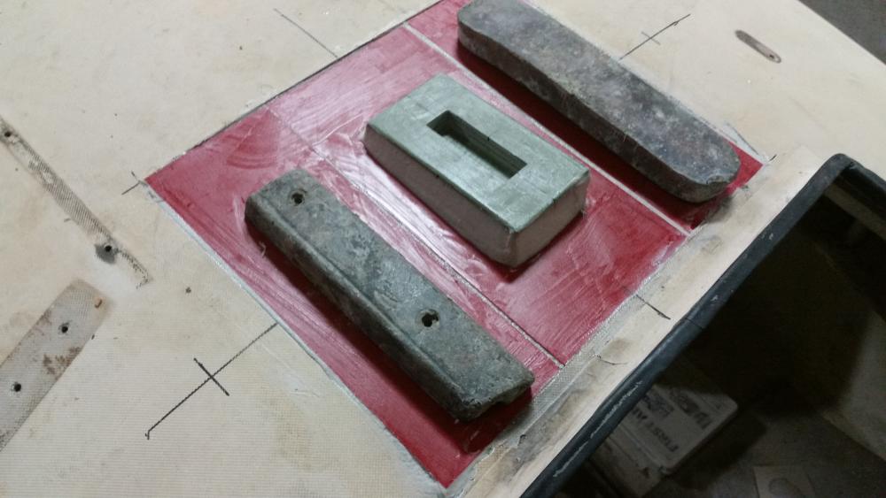

    The drawing in the manual is great. I had to rebuild mine. The manual had all the necessary dimensions. I am sure any CNC shop can make one. I rebuilt mine out of solid G-10 and glassed over it. I had to recore the area anyway so it is solid glass all the way down to the compression post. I also recored with solid glass plate where all the mast base blocks will mount. I am having a thin stainless wear plate fabricated to go over the top to prevent the mast base from digging into the new glass. Here are a couple of pictures. One that shows the basic structure before I laid the outer skin and the other after I glassed it over and primed it.

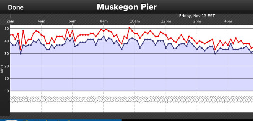

    Wow, that season seemed short!! Lucky Dawg is on the hard. Only good news about that is she was hauled in time to avoid the strong midwest wind storms of last weekend.
    Photo is from Grand Haven where my office is - about 12 miles south of Lucky Dawg
