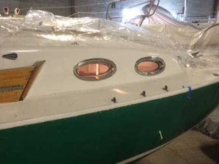

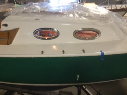

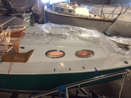

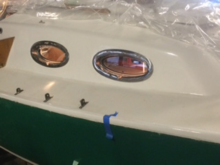

    These would roll out prettier in the summer sunshine, but... I'll take some interior next visit.

    That looks GREAT!!!!!!!!!!
    [QUOTE=Lucky Dawg;26987]These would roll out prettier in the summer sunshine, but... I'll take some interior next visit.
    Kyle
    Man you make me wish I had bit the bullet and put those in Destiny. That looks fabulous and no more leaks is only a minor plus when you consider how young that makes her look!!!! Your mistress has a whole new sexiness about her!

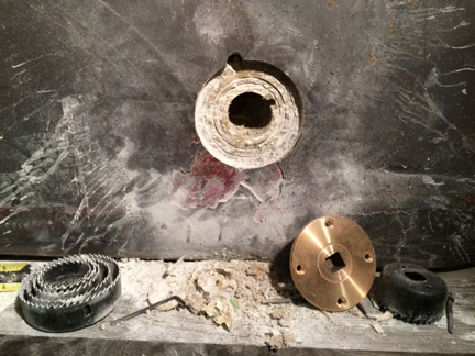

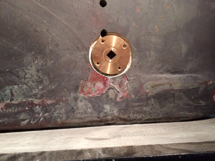

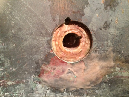

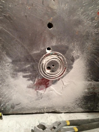

    Initial installation of garboard drain. The couple holes above the on-purpose hole were exploratory trying to ID the bottom of the bilge. A gallon or so of water seeped out from the lower hole after drilling the bottom hole. Followed directions from this site http://www.oocities.org/earlylight16...oardDrain.html which were spot on. Can't do the interior grounding part because of my enclosed bilge, but otherwise... followed that guidance. Couple trips to the warehouse to epoxy my exploratory holes and I can check that off the BIG list of projects I have underway.

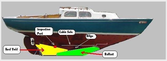

    There is a ton of discussion on the forum about the keel void. (better than the search option here, go to google/other and enter: site: pearsonariel.org "whatever you're looking for" (in quotes)) The manual also has some discussion on pp. 41-42. (Manual, by the way, is well worth your $35.) I'm not blowing you off, but it is better stated than I might several times over elsewhere on the forum! There may also be a diagram in the manual, but I haven't looked for it in a while.
    Water is pretty diligent and finds its way wherever it cares to. The void isn't in the front of the keel where you found seepage, but that doesn't surprise me that some worked its way up there. Here in MI where we're unfortunately 6 mo. on the hard, dry-out is an option. Not sure what the advised dry-out regimen might be where our yachts are 24/7/365 in the drink.

    Pic Bill (A231) posted. Holes I drilled are just a smidge fwd and a bit below of the tip of the arrow indicating the keel void. I can't tell you exactly, but I'd guess the bottom of that void is about 5" above the bottom of the keel - solid fiberglass below. You can eyeball it - that fitting is 3 1/8" in diameter, and the bottom of the 1 1/2" hole I drilled is at the very bottom of the void...

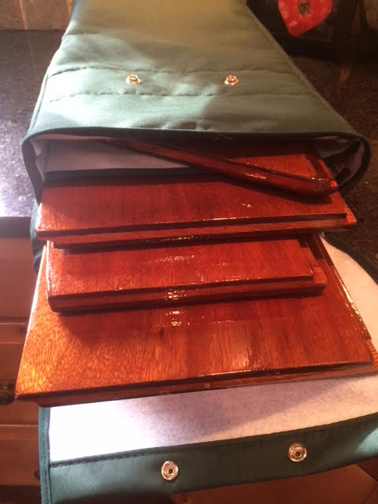

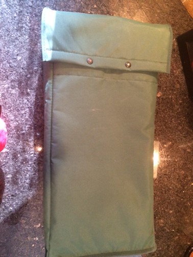

    hatch board bag
    I refinished my hatch boards and companionway brightwork. Commissioned a bag from my canvas lady. Came out nicely! Four pouches and fuzzy on the inside.
