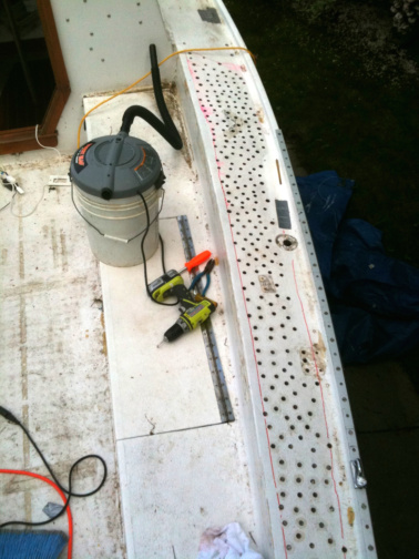

    $.02. ... The princess also tapped out fine and when I went to drill out the mounting holes for the combings I had a few that spit out some wet core. The outer skin on those side decks is so thick that even in the worst areas it does not flex under foot. I just let it go on The Princess (being certain that everything was sealed up so it would not worsen) concluding that with the thick skins the core is not needed in that area anyway. on many boats the area between the combing and rubrail is not cored.
    I think you could approach it this way:
    1. Chuck up an allen wrench with a 90 degree bend in it.
    2. Spin that sucker in each of your holes to clear out the mush.
    3. vacuum out debris and blow out with compressed air.
    4. Douse the area with Isopropyl alcohol to help remove moisture.
    5. repeat step #3
    6. repeat step #4
    7. repeat step #3
    8. inject epoxy thickened with something light weight like micro balloons with west system tubes and the $50. Royobi electric caulk gun. (or a regular caulk gun, I heard chicks dig guys with strong hands)
    ...or just cut the skins off and recore if it makes you feel better. not as bad a job as you might think.

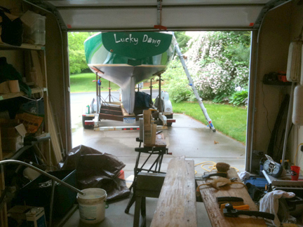

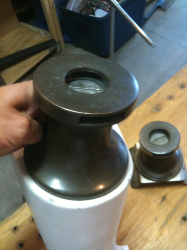

    Can someone ID this primary winch for me? It isn't the South Coast winch in the background (which, helpfully, is inscribed as such on the top.) It is about twice the size, but hasn't a marking of any sort on its exterior. I want to download a service manual for it before cracking the top off to rebuild it. Another pic in post 55... and 81.
    And... a view from the garage. All of the rot has been vacuumed away with an initial batch of epoxy injected. Easier than I thought and required less epoxy than I presumed. Stripping the coaming boards and other brightwork with Bix and curious what the final result will be. Ordered my vinyl-ester primer yesterday. Rolling along.....

    I would guess it's a Merriman Brothers or South Coast Company. You might find a mark when you open it up. Freshly lubricated winches will enhance your sailing experience. Great old hardware, perfect for our boat size.
    The jib sheet winches on my Ariel are unmarked.

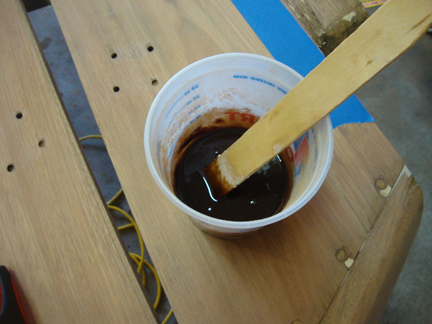

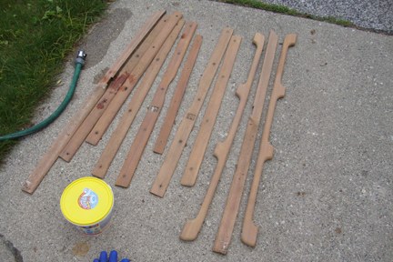

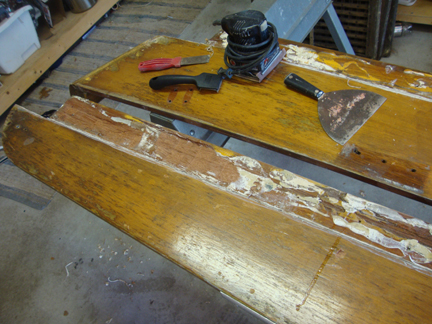

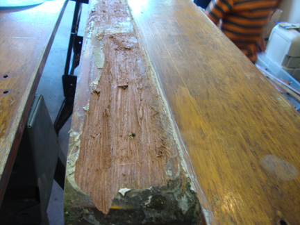

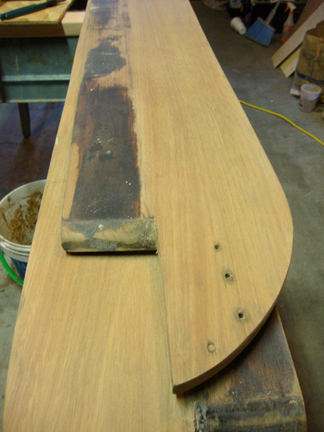

    A little progress. Crummy weather has made for a slow go of it on the deck work. I found and drilled out all my wet core. Mostly on stbd, under every stanchion, and at the bow pulpit attachment points. I have the first pass of thickened epoxy in my swiss cheese holes. Would have been easier / a one-step process had I known about release fabric - as each hole has a little concave shape to the surface. (I know, I know... release fabric...) Learning as I go! Anyway, that is slated for this week as the rain will finally go away for a couple days. (The only solace in not being in the water is that sailing-weather days have been few and far between.)
    I patched my coaming boards, which had some damage upon removal, with epoxy thickened with the mahogany sawdust from sanding. The dark brown will be hidden, of course, against the cockpit sides. They'd also been patched by a PO here and there with MarineTex and the white looked bad, so I dremeled that out and filled with the same epoxy mixture. It took a lot of Bix slathered on for a lot of time, and then standing on those boards with 40 grit at times to get out the old yellow out. Finally down to nice pink mahogany. Nice weather will also let me initiate my Epifanes. What I have removed won't match the Cetol that is on the cabin door, but I'll address that over the winter. Taking apart the companionway would have added another step that would delay sailing. My family is already tapping their collective feet waiting to splash.
    I may break down and rent a nearby airplane hanger to get this done inside - I fear unpredictable showers might treat my vinyl-ester fairing compound, not to mention primer and topcoat poorly
    p.s. the color in pics 3 and 4 really is nice and pink like the pieces on the driveway, but doesn't look so in these!

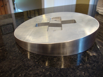

    Aluminum mast base

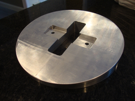

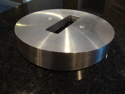

    Also got my aluminum mast base back from my C&C man. He said most of the expense was in set up, so if anyone is interested in one, let me know. I used Rico's plans to fabricate it.
    A thought - is the underside cavity below the screw holes just open like that for filling with water impeding bedding compound?

    Beautiful Base Kyle!!
    and great work on the dawg too!
    BTW; That cavity on the mast base is necessary for the plate that is welded to the conduit through which the cables are routed from inside the cabin into the mast... This SS assembly is essentilly a 1/16" plate that fits tightly into that cavity and has a about 12" of tube going through the middle. The tube (as installed) extends 6"-8" up into the mast, and about 4" below into the compression post.
    The Mast base screws go through holes in the plate fixing it (and the tube/conduit) in place...
    I suppose this assembly helps keeps any water in the mast (condensation / rain water) from coming inside. - I have a small water drain-hole in the mast at 2-3 inches above the deck.
    So far I've only seen this plate on the Mephisto Cat (C-155) and in no other boats...
