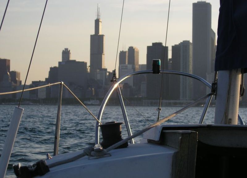

I have a Commander - maybe the curve of the cabin roof is more pronounced there than on the Ariel. I think the total distance to bend is around two inches, maybe a little less. I don't think I can simply force the rails - they feel really hard and unyielding.
As for the radius on the companion way hatch - I need to certainly bend that because it's supposed to give shape to the hatch which is flatter now than it used to be. If I would screw a straight board on there it would flatten the hatch completely, which is the opposite of what I want.
I'm attaching a picture where you can see where the rails are missing and maybe guess at the curve, and notice also the 'naked' (without wooden stiffener) sliding hatch.
