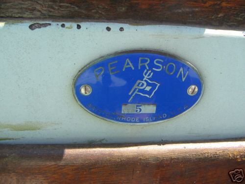

    This Pearson Commander is a 1964 model and is Hull #5 (yes...Hull #5). It might be the earliest Commander currently in existence. Additionally, it was owned by one family continuously from initial purchase until it was donated to our sailing organization.

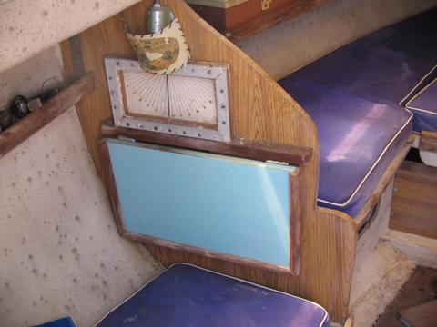

    Foredeck: This boat has soft spots on the foredeck at the bow area. There are also cracks in the deck where the bow pulpit is attached.
    Cockpit Coamings and Tiller: The wooden cockpit coamings are intact but have large lateral cracks and should be reinforced and treated. The tiller has completely deteriorated and needs replacement. Additionally, the metal rubrail is loose along the starboard cockpit side and should be reattached.
    Cabin: The cabin cushions are dirty and could benefit from new covers. The current covers have some holes. Also, some of the wood access panels on the cabin floor need some support trim reattached.
    Cleaning: Lastly, the boat needs to be cleaned. In fact, the boat is dirtier than the pictures show. (I don't know why that is, but it is.)

    This inclinometer allows you to calculate angle of heel to within 1/2 a degree.

    Hello everyone, my name is David and I am the proud new owner of this 1964 Commander Hull #5. I couldn't be happier. I have thoroughly enjoyed reading many of your posts and especially lookin at all those photos of your boats.
    Thank you all for all for your pictures and for your enthusiam and appreciation for these great classic Alberg designed-Pearson built boats, which truthfully in part inspired me to buy her. I hope I prove to be worthy to join your ranks as new owner and steward to Hull #5.
