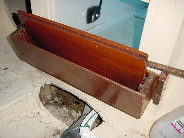

    A PO built a holder for the hatchboards, sort of like a magazine rack, with two separaters on each side to keep the three boards apart when stowed. It's mounted in the aft locker against the cockpit wall - not sure if it would work if you have an outboard though. But it's great. I take out the boards, stow them, and forget about 'em. The same thing would work just as well in a cockpit locker too...

    Here's the hatch board storage in the aft lazaret in my boat.

    Mike, I like Sea Glass' storage for the hatchboards. You're still holding out on us when it comes to photos, aren't you?

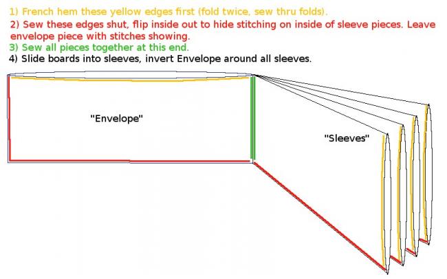

    Reading this thread, I came up with the following idea. Should be very cheap to make, and will be very easy to sew, since it is all straight lines and no fancy corners or anything. Made right, when the envelope gets inverted over the sleeves, that will hide the stitching of the envelope part.
    The envelope piece will need to be a bit larger than the rest, since it will need to have room enough to fold over the others with boards in the sleeves. It could also be made just like the sleeves (leaving the end open @ opposite the sleeve openings), and slid over them from the end similar to how a spinnaker sock works, with either a drawstring or velcro'ed flap for enclosure.

    Nice! I like this idea better than my beach towel sized configuration. I think it would be about as easy to sew either, but this one, with the "envelope" as a separate piece (your alternate idea) compacts the work stowing process. Maybe make the sleeves out of leftover interior cushion sunbrella fabric that I have and the envelope out of the old sail. I am wondering though if my sewing machine will go through 8 layers of sunbrella... Thanks for taking the time to illustrate!
