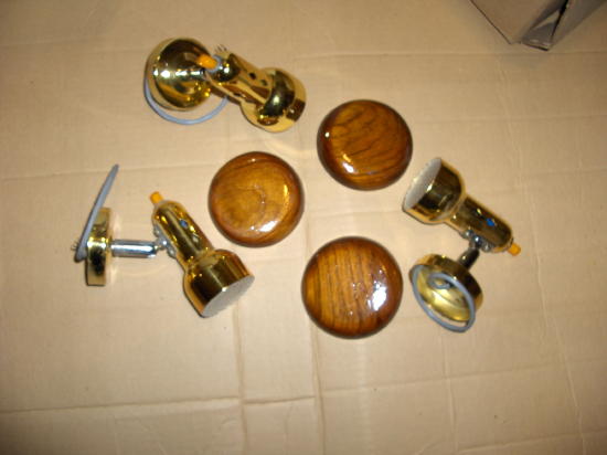

    Different choices to replace the old incandescent cabin lights. You can get halogen, flourescent or LED. Each has its pros & cons.
    I decided to get LED lights. I'm embarrassed to say that I bought them 2 years ago and only hooked up one of the four so far.
    I was really looking for the red/white fixtures, but couldn't find them. I'm sure there's more styles available now.
    I bought them from this place
    http://www.theledlight.com/led-fixtures.html
    I'm putting them on teak mounting bases to dress them up a bit.

    Those brass fixtures look nice.
