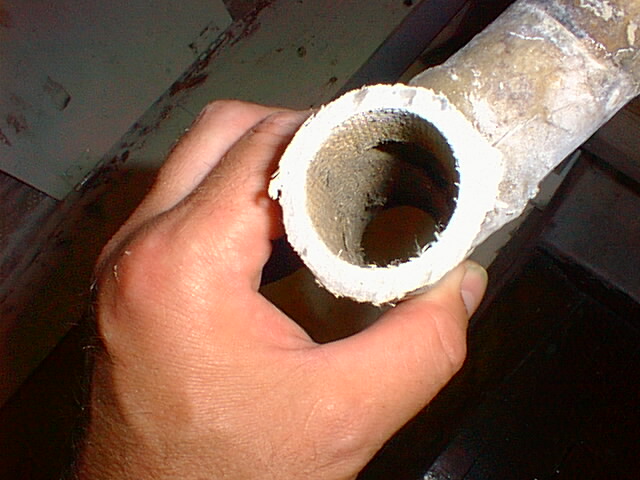

    The original Pearson sink drain led to a T in the port side cockpit drain. If there is a third through hull, then it's from a PO. Half inch seems a bit small for the sink drain, but if it works . . .
    John
    I agree will Bill, a half inch does sound a bit small for a drain. I snapped this pic the other morning of the 'T' shaped tube Bill speaks of...

    Looks like they glassed a tube. That looks like the drains they used on the Gunwales with the bronze grates. I did not think mine was original after looking at the sink the pipe and and the seacock and the inventory list. I sat taking measurments any suggestions on increasing the size or don't fool around with it. I was worried about putting in a bigger hole for a thru hull.
