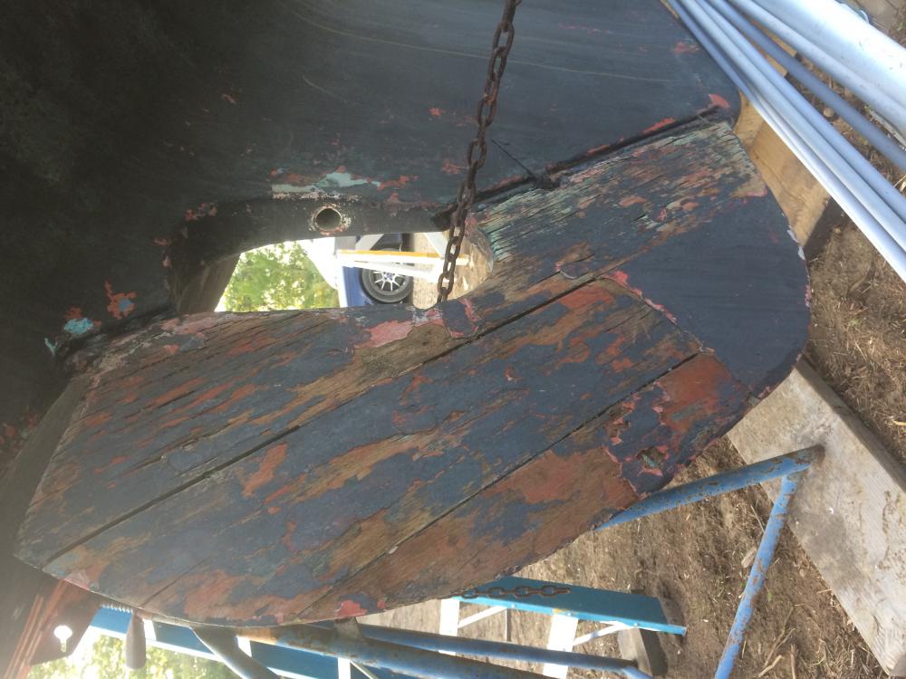

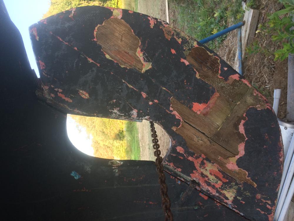

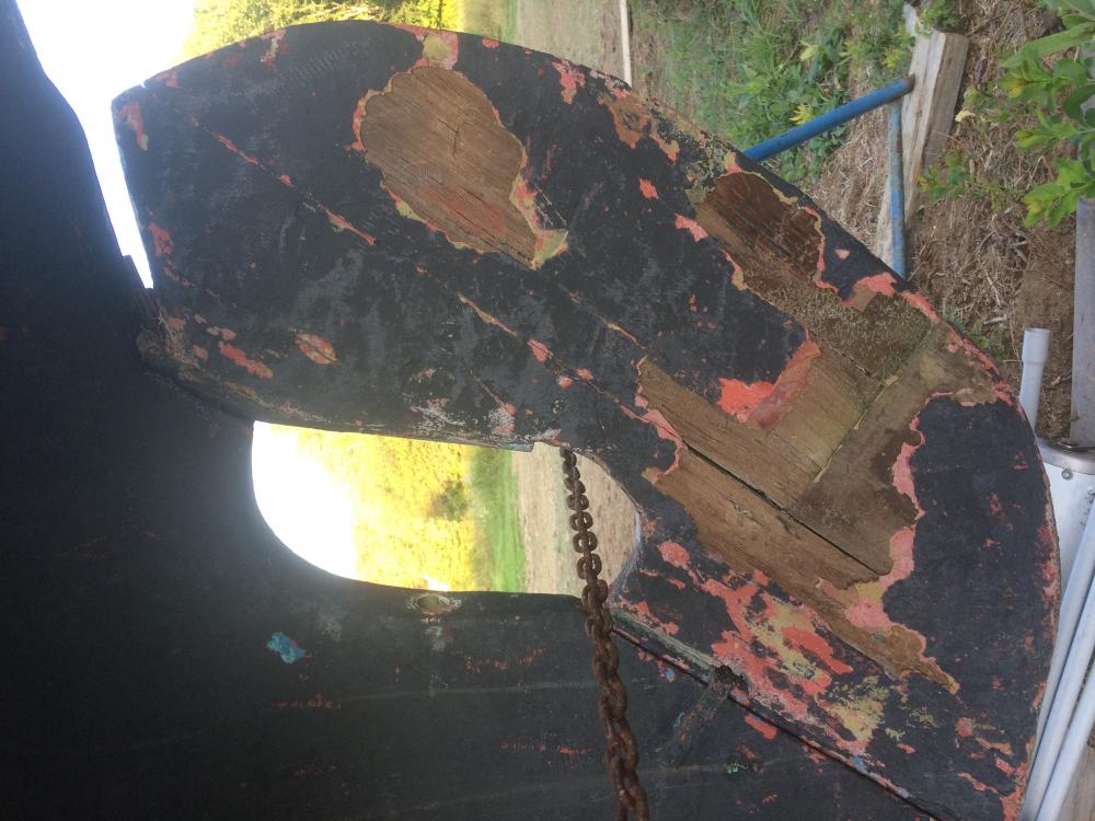

    I'm starting to get my head around the list for A 414 - Mike's (MBD) old boat 'Sea Glass'. I've got a bunch of ideas and a a few big items that must be addressed and most of them I have a good idea how I want to tackle them. The rudder though is a different story.
    After reading what I can find here and elsewhere on the rudder I'm thinking this one is not as bad as it looks. There is not really anything that is soft except one spot in the center that I can cut out and fit a new piece of mahogany in with epoxy and some bronze rod. Also the shoe is perfect - no play between the shaft and shoe. The rudder to tiller connection is also good with a just barely noticeable amount of play. And Mike already did the upgrade to the delrin bushing and gave me a new o-ring too (he really is a great guy)!
    SO what would you do if this were your boat? I'm not afraid of pulling it and doing whatever will get me the most years.

    Seriously though, a PO had previously encapsulated the rudder with expoxy/glass. It had long failed and I would just bottom paint it each year. I had been picking at it over the years to determine if the wood underneath was still solid.
    I'll now return to vicariously spectating. I am really looking forward to watching your progress. She is in good hands!

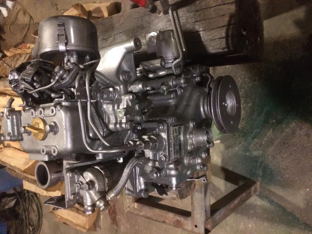

    Finally pulled the '83 Yanmar 2GM out of #414 today. Surprisingly quick and straightforward job. Mike (mbd) had done more than half the work for me before I bought it. All I really did today was unhook the wiring, fuel lines, raw water and unbolt (had to cut one) engine mount, and the control linkages and come-along it up through the companionway. It's now sitting on blocks in the shop ready for teardown. I've already taken the exhaust elbow off and it was pretty rough in there, I don't have a picture to post now but I will post it soon. Here are a couple shots of the engine ready to come out and one of it gone. Feels crazy to have it out - and exciting!
    -Ben
    P.S. Sorry for the sideways images. Still learning how to use the forum!

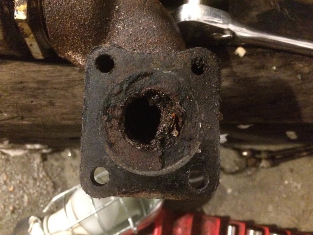

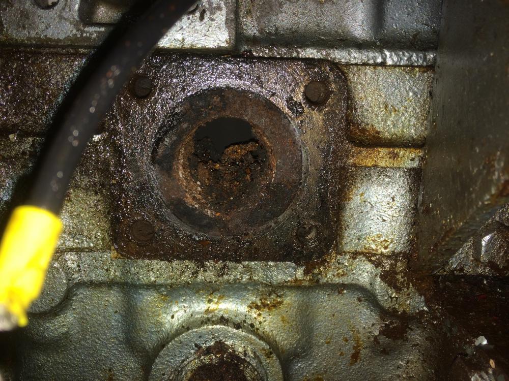

    Here is a view of the inside of the exhaust elbow and the exhaust port on the head. The port on the head was about 2/3 full but I couldn't help but poke it before getting a picture. Obviously the head is coming off so we'll see how she looks on the inside.

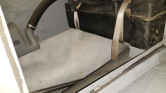

    Good luck with the rebuild. Looks like she needs it but I think the 2GM is worth the effort. I have a 2GM and I put my tank on a shelf under the cockpit floor above the stuffing box. The fill is on the cockpit floor but no problems with water or spills so far.

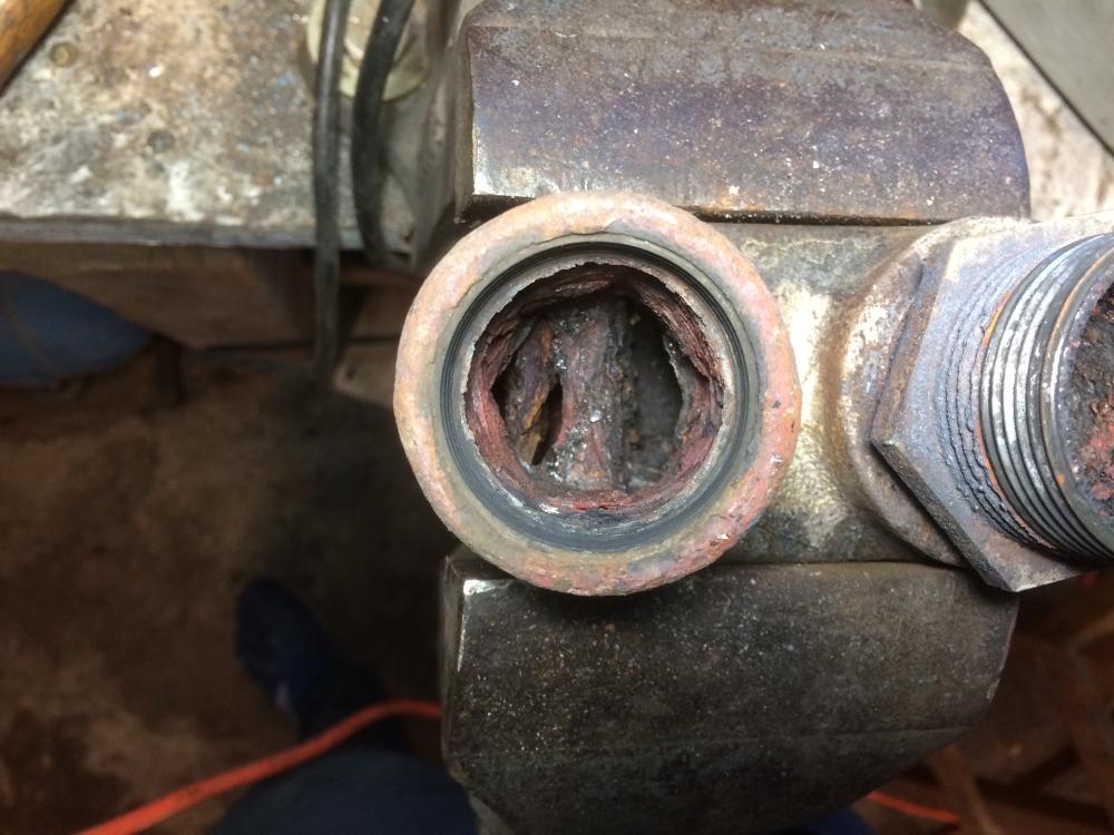

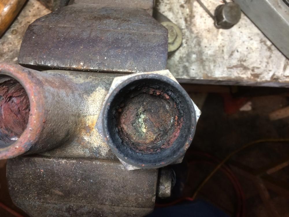

    Pulled the head off late last night and everything looks good. Cylinder liners are in great shape with cross hatch still visible and no scoring or uneven wear apparent. Valves looked good too. A little carbon build up on everything but nothing that would cause the engine to not run or even run rough. I lapped the valves since I had it apart anyway and cleaned all the carbon that was accessible. Going to order the gaskets and get it back together soon.
    The thing I was not expecting was the water injection elbow (it's the u-shaped one in this case). On the outlet side it was very corroded but had a fair amount of area for gasses and water to escape as you can see in the picture. After much heating with the oxy-propane rosebud the inlet side came apart (meaning separated from the exhaust piping that is between the water injection elbow and the cylinder head, what would be called the manifold if it had multiple ports) the interior had closed down to less than a pencil's width for the exhaust to escape! It was impossible to see this until the two had been separated. In the photo you can see a greenish area that is the passage.
    So my thoughts now, after seeing the inside of the engine looking quite normal, is that the exhaust had closed down to the point where back pressure was extremely high and thus the engine could not pull in the fresh air charge. This made the fuel to air ratio very rich for any given engine load and caused incomplete combustion, giving the black smoke that Mike experienced back when she conked out. The only thing this doesn't explain is why the mechanic reported low compression on inspection in the boat. I should have tested it before tearing the engine down but I was just so convinced I'd find a smoking gun in the valve train or scored up cylinder liners I just went for it - lesson learned.

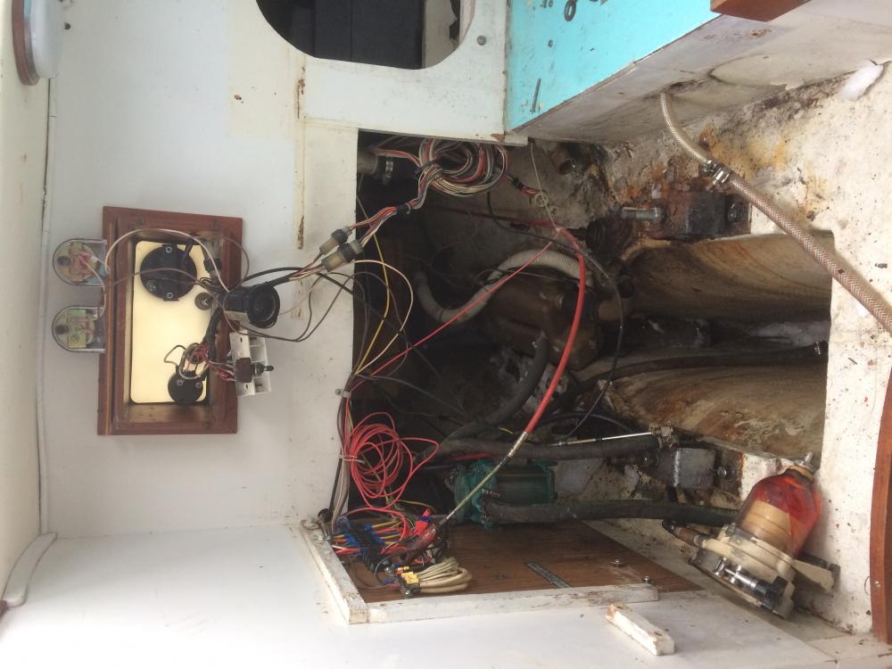

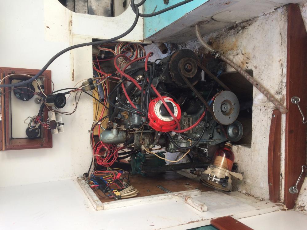

    Still chipping away at the 2gm. New zincs, fuel filter and I replaced the couple of fasteners I chose to cut to remove the engine. I also slapped (and I do mean slapped) some new Yanmar grey paint on it. Time to deal with the engine room if I can get a day that isn't super cold or raining. Plan to cut out the rear engine mounts and replace them then clean, sand and repaint the whole area before re-installing the engine.
    I'm thinking of tearing out most of the existing wiring. It's all pretty old (much original I'd guess) and some of it is confusingly complicated for what it is. I need to dig around more but that's the way it's headed I think.

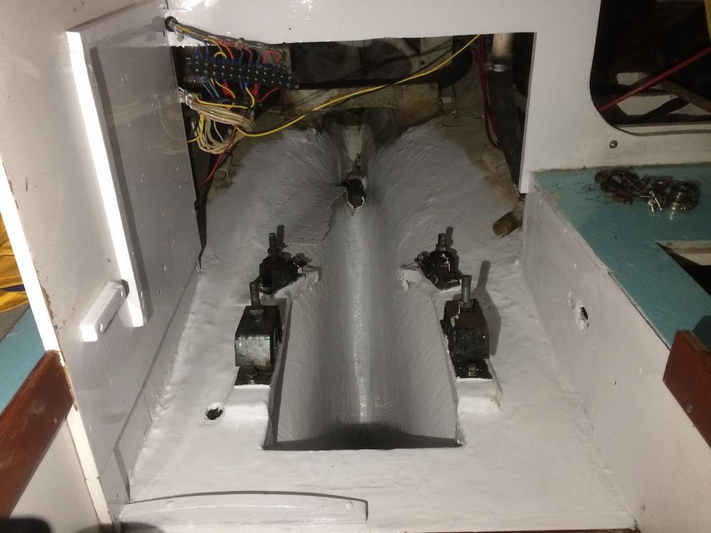

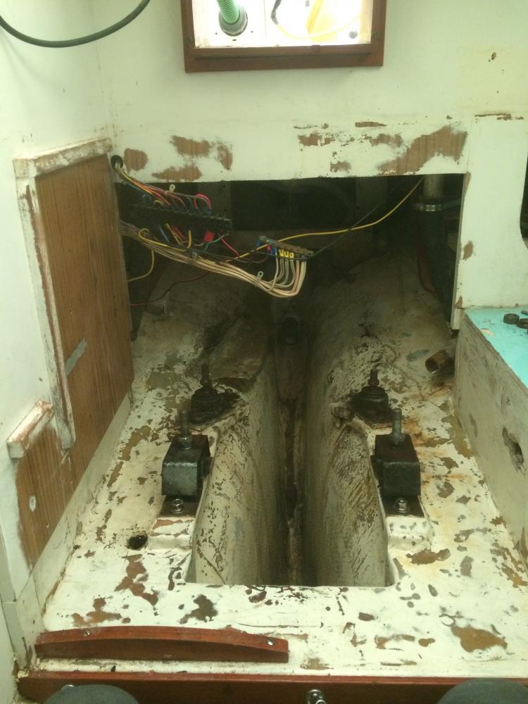

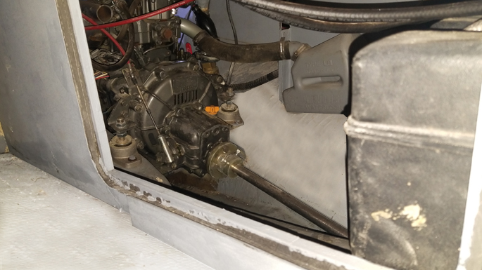

    Took advantage of the very non-typical weather we're having here in Maine to get the "engine room" and deep bilge painted tonight. I'm hoping that with the above freezing temps for the next few days and a small space heater I'll be able to get it cured. I can finish the paint that can be seen at the back end of picture after the engine is in.
    In finishing up the engine I've replaced the couple of coolant hoses that run from the raw water pump to the block and from the block to the thermostat housing and head. I opened the raw water pump and had a good look at it but the impeller was in perfect condition so I let it be. I've got an extra (thanks Mike!) and I'll keep it on board with the tools to change it. From here on I'll make it a yearly maintenance item. I also pulled the oil pan while I had it out of the boat just to get a look at the bottom end and see if there was any metallic chips or shavings in the pan. All was well in there with barely any sludge which surprised me given its age and the amount of non-run time all boat engines experience.
    All that's left to do before dropping the engine back in is to make a catch pan for under the engine that slopes forward to catch drips and make them easy to clean up and perhaps a two new rear engine mounts (I had cut about .5" off the top of one to get the nut to unthread but they are actually still stiff and in goodish shape). They may wait though as boat funds are running particularly low.
