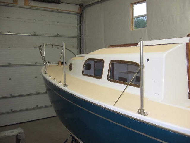

    This is how the frames look now:

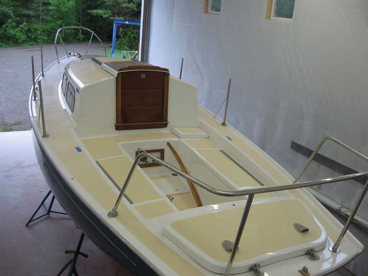

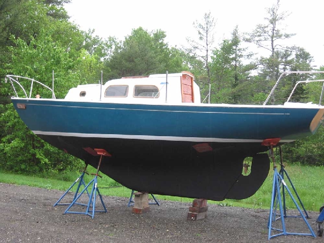

    Another shot from this morning. Too bad a topsides job wasn't in the cards! Tim's work had drawn to a close, so yesterday, me and my friend spent all day doing the bottom, boot top, repainting the window frames, applying the new name and whatever else we could to get ready for the launch today.

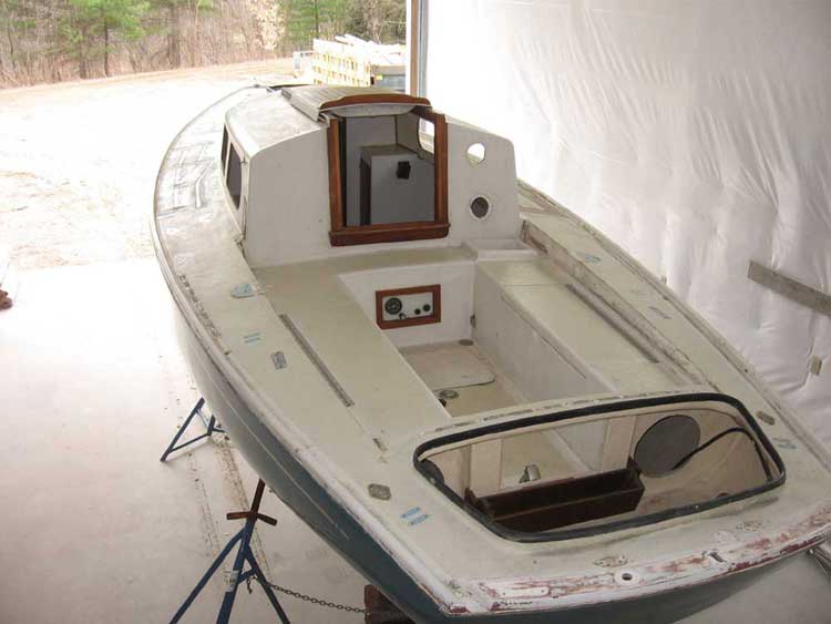

    Here's a BEFORE from Tim's web page.

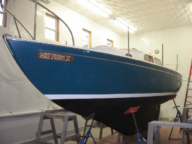

    ...and AFTER. What a transformation!
