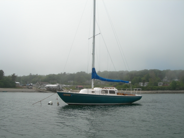

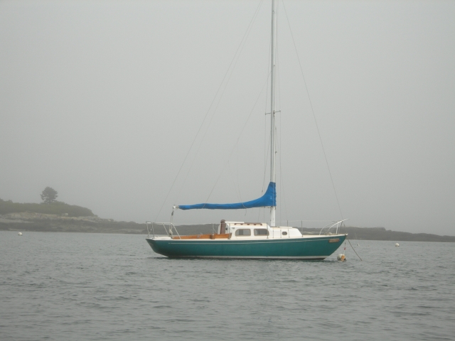

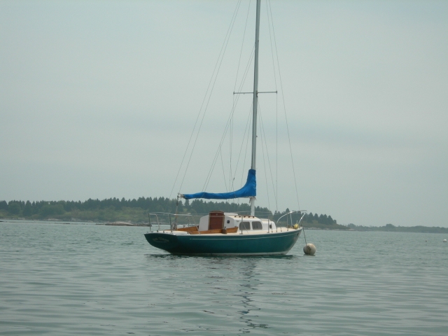

    Just gonna say you can always go sailing! But looking at how tite and tidy and skinny the blue cover is on your boom... have you checked your mainsail recently?
