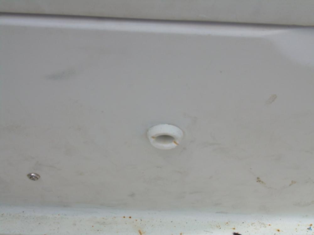

Make sure exit is as high above the waterline as possible and is protected with a seacock.

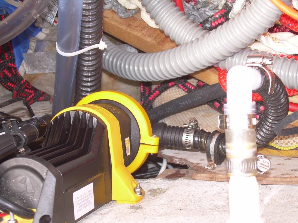

Put the smaller pump in the low position. It will take care of incidental water and is cheaper to replace. Mount it high enough so it won't continuously cycle because of hose water run back. Put the high capacity pump switch higher in the keel-sump so that it is used only in emergencys. Helps save an expensive pump.
Use UNCOVERED Rule super switches so that you can lift them out of the sump to SEE if they are working.
Use the manual pump to lower the water level in the sump. Save the electric.
There are threads here that discuss A/C leak sources.
Planning to take the boat offshore creates a way more intense level of leak protection. Some things requiring upgrading have been talked about on the forum. Make sure that what you might have to depend on is actually working. Checklist.
Investigate mounting the pumps to King-starboard or other plastic to make it easily removable so sump can be cleaned if necessary and pumps replaced or cleaned. Float and super switches same thing. To keep them in place in a crowded keel-sump. 338's sump may have to have non-submersible pumps.
Flex-impeller (non-submersible pumps) will burn up if run dry, have good head but way less capacity. Research how long a 'submersible' can be run out of water, ie, with a short hose into the bilge???
