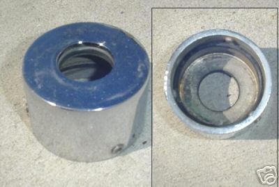

The 338 cap is as smooth inside as low grade corrosion can be. No flanges or grooves, which is not to say the Pearson or a DFO didn't have something else there. The only added rubber COULD be a washer put on the inside of the cap where it sits on the bearing. Don't think it necessary unless you are using the washer to change the position of the cap for the setscrews because the fiberglass tube is messed up where they go. In other words, you could use a washer to lift the cap so it rides higher and exposes unviolated rudder tube to drill into with the setscrews.
The cap is not tight on the bearing. It should allow a bit of drainage for any water that gets in there.
Rico, thanks for the photo of the cap. It's great to have something to see when talking about it. Looking inside I can only imagine a ledge as you say. Just what exactly was in there??? That blue disk??? It might have been someone's attempt at snugging the cap, that stuck around for you to find? Imco it's better that what water gets in gets out quick.
