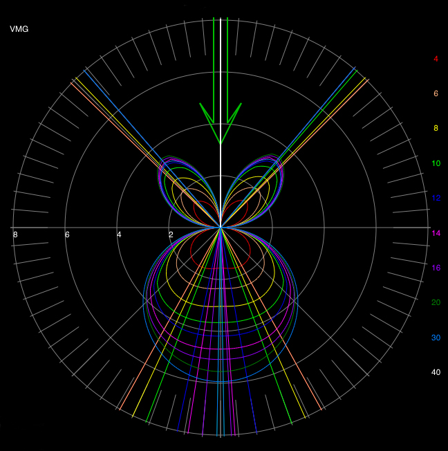

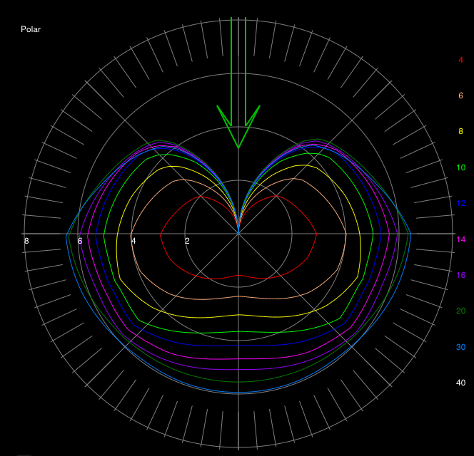

Here are the polar diagrams - speed and VMG
Attachment 10062
Attachment 10063
