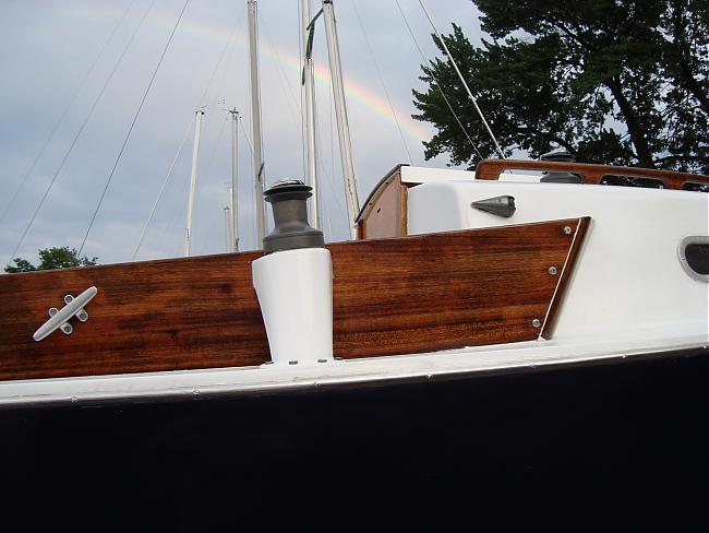

The official word from Lewmar Tech...
It took them awhile to get back to me but "the word" on mounting winches is LifeCaulk or some similar adhesive bedding compound in the mounting screw holes and that's it.
That said, I had already given up waiting to hear from them so I did the screw holes and a bead around the perimiter - leaving a 1.5" gap right under the small gear spindle so that any water that ends up under the base can drain or evaporate out. It seems to be working in tests.
A couple of tips from a guy who's been bedding his brains out for the past couple of weeks - I place the bedded object and then tape around it - be careful about the speed at which you pull up the tape when you're finished - too slow or too fast can cause a mess - I use vinyl gloves extensively - using my fingers to smooth and mold the goop into position. I keep a Windex bottle full of tap water handy - spraying the goop speeds curing once you have the it where you want it - this has the advantage of fiinishing the job faster and reducing the mess. Finally, I go back around the edges and the hardware and clean it and the surrounding area with Interlux 202 which seems to to a better and faster job than the Remover product or Solvent product that Life Caulk sells.
