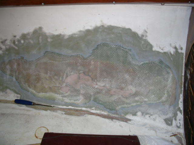

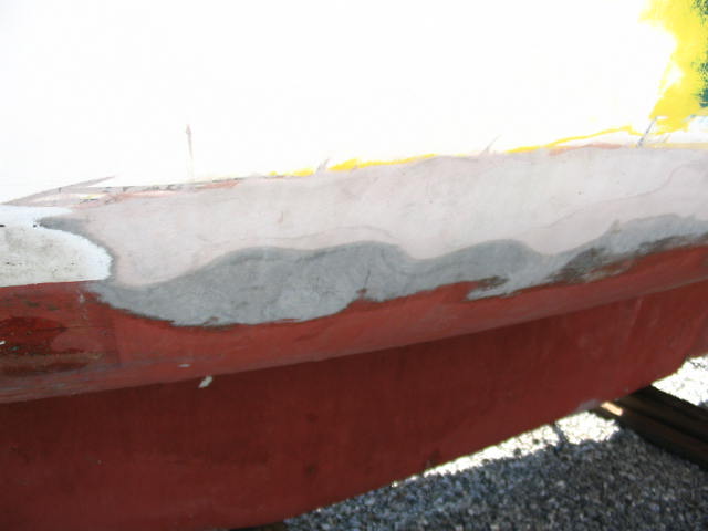

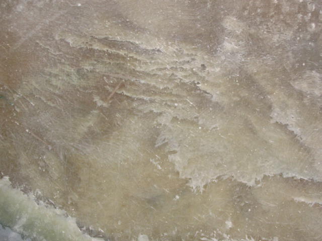

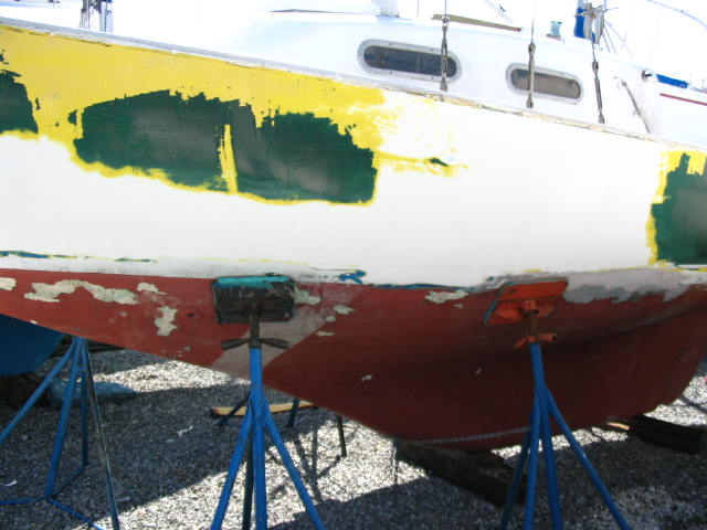

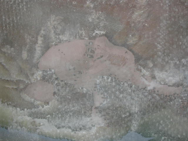

This is what we're looking at on Augusta, Commander #303. You can see the damaged area at the waterline on the right of the picture. This one has about everythign worng with it that you might not want: the hull was punched through below the waterline, there was a bad repair and extensive delamination behind the bulkhead and on the interior of the hull and then they put a truly bad Rustoleum paint job on top of it.
We have stripped the hull of the old paint & gotten an idea of the size of the hole - next step is to tackle that problem. I'll make sure to include shots of the interior - that's where things get really interesting.
