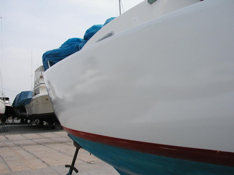

So, I figured I would post some pictures of my hull painting job. I used the Interlux one part Brightsides. Did the roll and tip application. Came out pretty well I think.

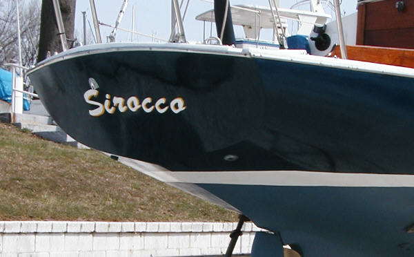

A fetching stern.

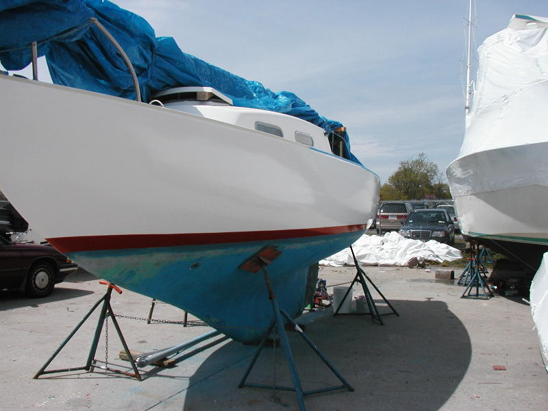

Next I need to do the boot stripe.
still needs some bottom paint
and the rub rails.
That should bring me to 100 posts and a new exalted title.

Commanderpete,hull looks great I think that I could comb my hair in the reflection.What happened to the interior project?

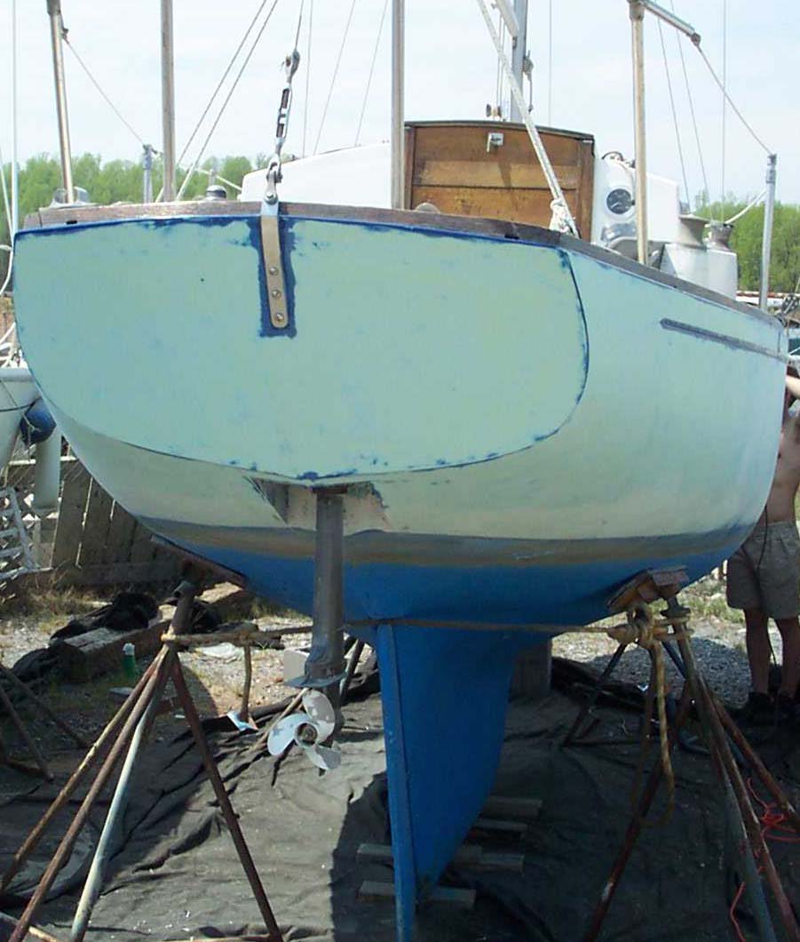

Photo from last week is attached. I did some more sanding after this was taken and there's now hardly a speck of blue left on her.
Jeepers, that must have been alot of work.
Did your boat come with the toerail? I always wanted one of them. But I'm a glutton for punishment.
