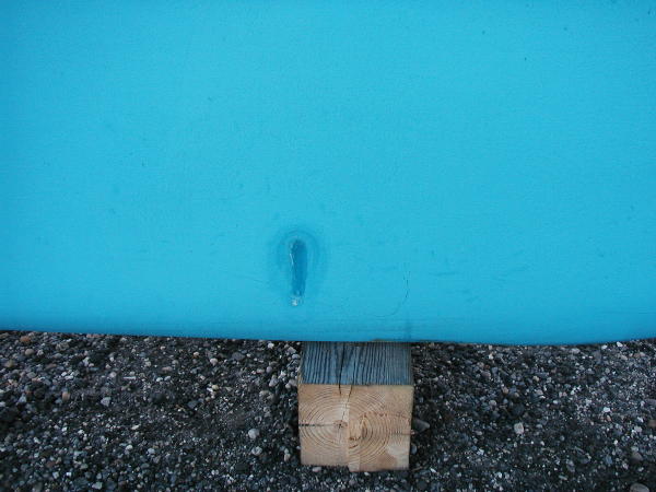

Here is my little wet spot, just about in the middle of the keel.
I'm not too worried about it.
Remember the major weight of the boat, the balance point, is at the bulb at the forward end of the keel. Whenever the boat is laid up, virtually all the weight of the boat is balanced on this point, so it is almost inevitable that it will crack, just from the weight, and ultimatelly leak.
Also, if the boat went aground (and in this part of the world, that is necessary part of the sport - if you really cruise), that could also cut a hole or cause a leak, right at that bulb.
If the boat is put up for the winter in a freezing clime, the moisture/water in the bulb will likely cause it to crack eventually.
So there is water. Who cares, as long as it drains before freezeup?
On #82, I had it laid on its side and found there was a major hole in the bulb. I ground out all the rotten glass & mat - to the length of about 3 feet, and laid it up again. About half way back, just above where the bottom of the keel rounds towards the bottom, I mounted a permanent drain plug, to drain the water in the winter. However, before mounting the drain plug, I put in a couple gallons of resin to hold one side of the lead. That way, I figured, the lead could expand and contract without breaking the figerglass shell ( I hope that is clear). It should be noted that the hole, crack, whatever is never visible when the boat is resting on a stand, trailer or whatever, because the plank or whatever the boat rests on covers the area of the hole.
I also coated the inside of the bilge with several coats of Gluvit, so I don't think I get any water from the top.
So now, three years later, I still get water in the keel well. Who cares. I have no idea where it comes from, but in all liklihood, it is from something in the bottom of the bulb. (I can only see some discoloration when the boat is being lifted to be put in the water).
