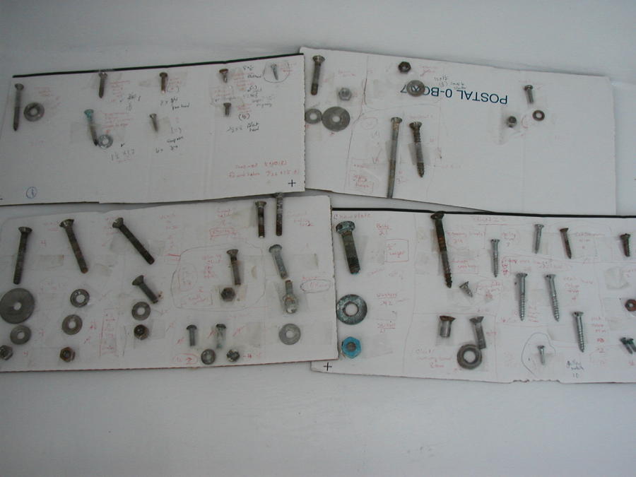

I decided to rebed much of my deck hardware. I removed the fittings and screws and put them in individual ziplock bags with labels. Then I took one of each and taped them to a piece of cardboard, noting the location, size and number.

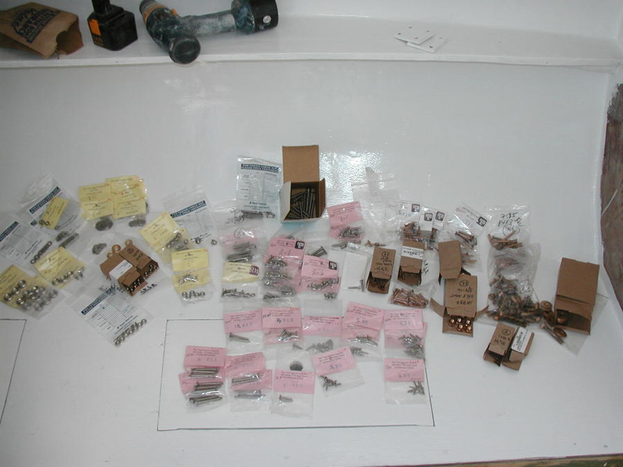

Then it came time to try and locate all the different fasteners. You end up with a bewildering array of machine and wood screws of different sizes and lengths. Different sizes of flat and finish washers, hex nuts, lock nuts, cap nuts etc. Some of the sizes are unusual and hard to find.
That's most of them. I'm still scrambling around trying to find some, and ordering the ones I forgot to buy.

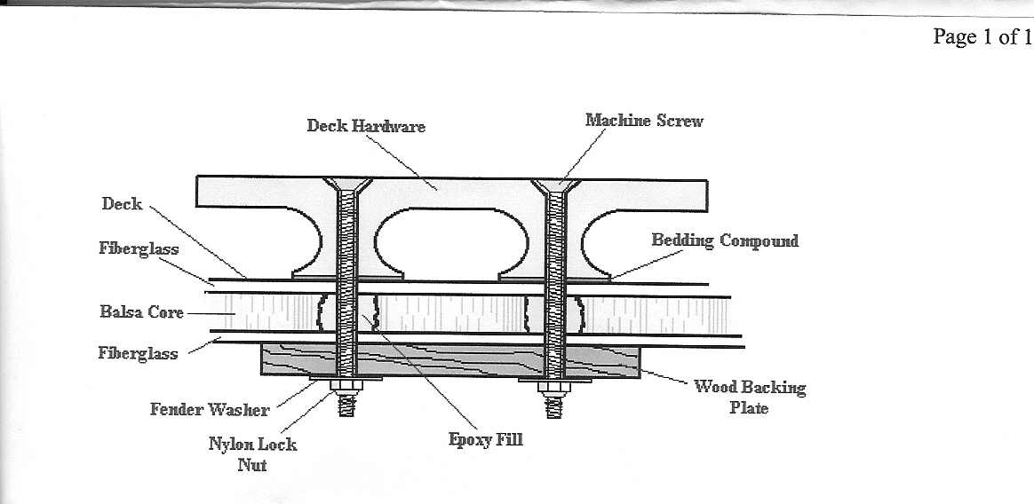

Here is an illustration I found on bedding hardware. Wood is not the preferred choice for a backing plate, but its better than nothing. On high load locations, you can't just use fender washers. The underside of the deck will get crushed and deformed.

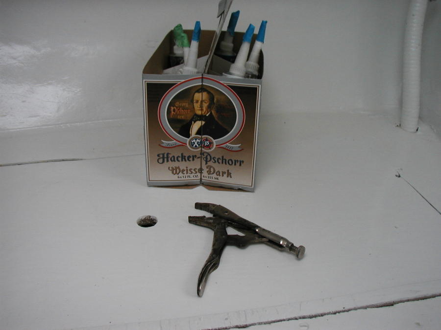

To keep all the various sealants organized, I purchased a handy sealant dispenser pack (pictured below). The dispenser pack was kind of expensive, but it came with six free beers.
In the foreground is the wrench I use the most. His name is "Junior."
