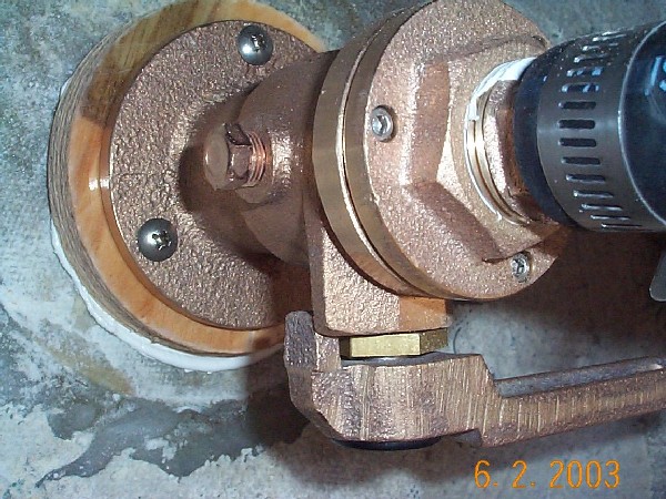

First we drilled a hole for a thru hull fitting and then installed a seacock.

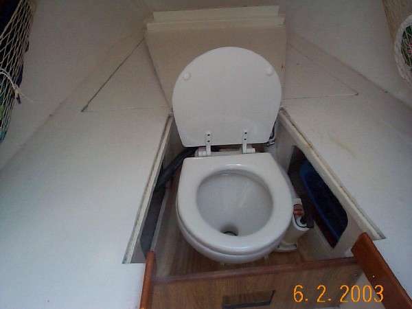

Here is a picture of the new head.

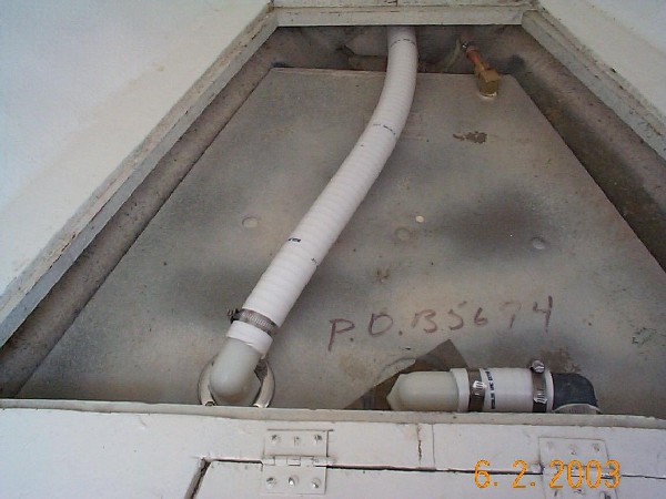

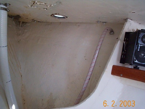

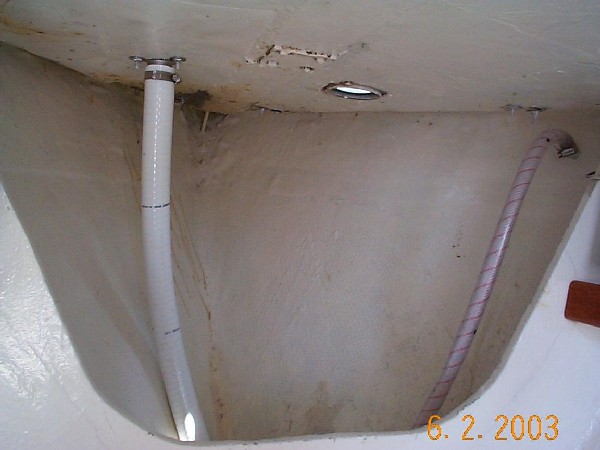

We did run the vent and the waste pipe out through the anchor locker.
This is a pic of the waste discharge pipe.
