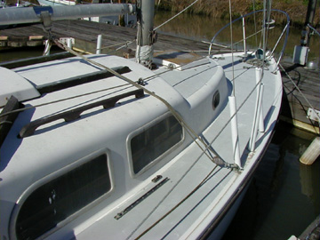

Jib Track Location

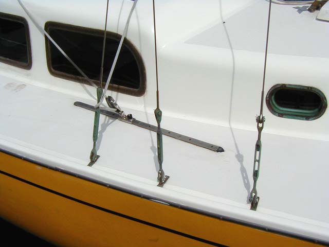

Here is the track loation for the working jib:

Did you move your tracks? Mine are right below the windows and parallel to the house .
This isn't my boat , but the track is in the same place .
The track in Mike's photo is the location Pearson used in its original jib setup. Pearson had the sheets coming back to blocks attached to the two eye straps on the coachroof.
The track location on Maika'i is fixied and is the result of much fleet testing for maximising the drive of the class jib.
The Genoa track (not on Maika'i) is set out against the toe rail and on some boats extends from just behind the shrouds to midway of the cockpit. Good for anything from a 120% on up.

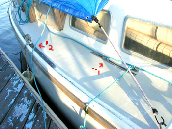

Seems like 120 or 140. The foot is 16 or there abouts. My question here is. Is the sheet for this suppose to go outside of the standing rigging? seems like it. I have two tracks on Kuan Yin picture attached, I belive the long one is for the Spinnacker...
With the sheet running to the outside of the rigging and the Sail so large, what about tacking? does it just flop across everything to get to the other side of the boat and the sheet should be long enough to handle it??

the picutre did not post here it is.

Genoa sheets go outside all the shrouds. Jib sheets go outside the forward shroud and inside the two remaining shrouds. Yes, the Genoa sheets need to be long enough to follow the sail as it crosses the foredeck. And yes, the sail will hit the shrouds. Remember, here in the Bay Area, on most Spring to Fall days, the 110 will be more than adequate -- In fact, on some days you will want to reef the main because you will be over powered.
Track #2 in your photo is the original Genoa track. #1 is the original jib track location. See #77's Genoa track location if you are flying 120's up to 160's.
