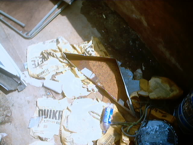

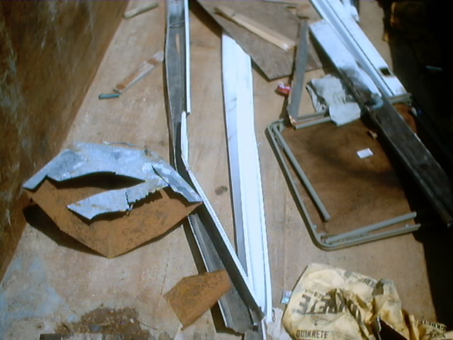

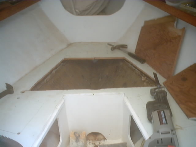

Spent the afternoon ripping the watertank out of the forepeak. What a bear of a job, but the Sawzall won. Nice space for a locker.
If the water tank is one of the Monel models, I think there is someone on the board who would like to purchase it.
Not unless they were a good welder, it is in several pieces and it is very rusty , so I'd say it is plain steel. The inside was all rusted up bad , the outside was like new except around the filler cap . The baffle inside was paper thin and crumbled away.
A bear of a job indeed! Was your water tank held in with some blue resin-like globs? If so, what was that stuff? It sure made a mess with the grinder.
Are you intendeing to put in another water tank of some sort somewhere? What kind of locker? Tony G

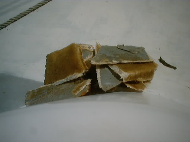

My tank was glassed in with regular resin that looked like the rest of the hull. It had a strip of glass about 6" wide down P&S sides of the top of the tank. I just took an old chisel and got under the edge and worked it loose. Hard to believe it was still holding since 1962, not bad for polyester.
It will be a general storage locker, for spares and items not needed on a regular basis, since it is under the vee-berth. I'll take some photos of the hole I made and the old tank in the dumpster.
Tank Parts
The rest of the tank
see how rusty the inside is.
Glass tabs
Part of the tabs that held it in place.
Vee Berth
Looks like the photo in the manual :)
Very definately one of the early galvanized steel tanks Pearson used. Someone once said that galvanized tankage was an old wooden boat thing . . :confused:
Yep, I removed a galvanised water tank in 1977 from a wooden boat I had, it was built in 1954. That was no fun job either, had to colapse it and pull it out through the engine hatch.
