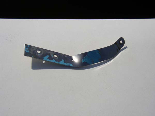

If you're replacing the backstay chainplate, I'd recommend using thicker stock than Pearson used. They seem to bend a bit. Here are a couple of examples:
Or, this one:
The 2nd chainplate came out of #76. I had no idea it was anything other than perfectly straight, until I tried to remove it. Could not understand why it would not pull straight down . .
The first chainplate came from #312. It got that shape because of a collision with a piling! The sudden stop pulled the backstay chainplate half way through the lazeratte hatch!

Today, as we were measuring for a replacement backstay chainplate, my machinest friend and I discovered that the "bent" original may have come that way from the factory :confused:
It seems that the knee to which the chainplate is attached, is located dead center of the boat. To get the chainplate centered so the backstay would be centered, it appears Pearson gave it the double bend shown in the above photo of the chainplate from #76. We varified this by peeking through the chainplate slot in the deck.

Scott, good question :confused: Our analysis may be faulty and it may be just happenstance that the bend in ours takes the cp through an out-of-line hole above the knee. Your extra thick, 304 ss chainplate sounds good to me. I think I better take another look through that hole in the deck . . . :)

Ok, took another sighting down the chainplate hole today and saw the knee filling in the view, but not all of it :confused:
Next, used a straight edge poked down the hole, and yes, it did fit . . . :mad:
So, I guess you should ignore my original post, although I still think Pearson bent my chainplate a little to fit . . . :p

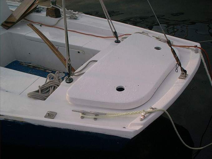

Ebb has the right idea, go to a split backstay . . . :cool:

Yikes, talk about cost. An hydraulic adjuster runs about $1,000 so it's not a consideration. :) A wheel adjuster runs about $325 and a turnbuckle adjuster about $185 for our wire size. A split backstay adjuster, however, is only $30 ;)
My reason for going to a split backstay is primarily race related - makes adjusting the backstay easy and is cost effective (see above). The shrouds are due for replacement (1988) so the marginal cost of splitting the backstay cable will be low relative to the total. The "only" added expense is getting the chainplates fabricated and installed.
A secondary consideration is what appears to me to be the under engineered backstay attachement (that little knee in the lazarette). It's lasted only 40 years, but still . . . :p
