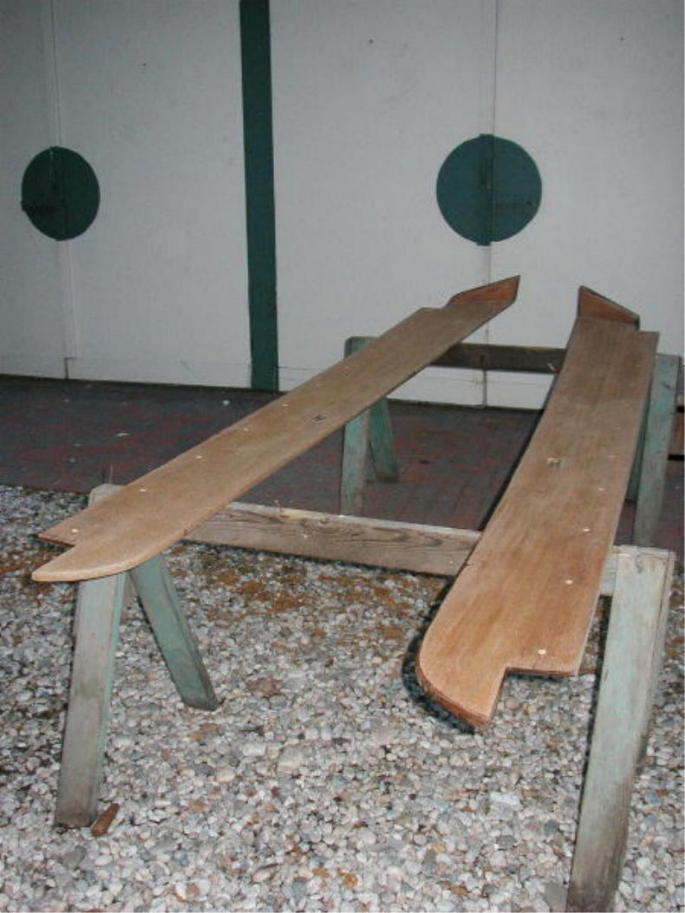

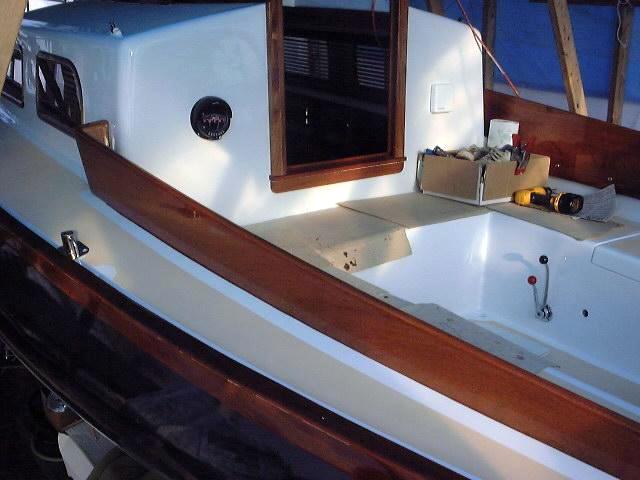

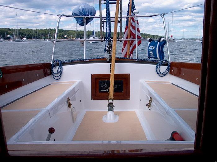

Taking them off and replacing them is not so bad. I used to do it on my old Ensign every winter so I could refinish, and now on my Triton I will take the coamings off every other year for a thorough sanding and several coats of varnish.
The only way to get nice looking restored coamings is to remove them. If you have rot, might as well plan on new ones. Use mahogany for a more attractive look and to save huge amounts of money over teak--many or most Pearsons of our vintage used mahogany for the deck trim anyway.
It is well worth the effort to make new ones...these coamings make the boat.

I would try to restore the end pieces (where the boards attach to the cabin) These were made out of some large blocks of wood and you would need to do alot of measuring and cutting to get them right.
Other than that, you just have two long boards.
They come off easily, unless somebody used alot of sealant attaching them to the boat.
The boards bend quite a bit when you attach them, which is probably another reason to use mahogany.
