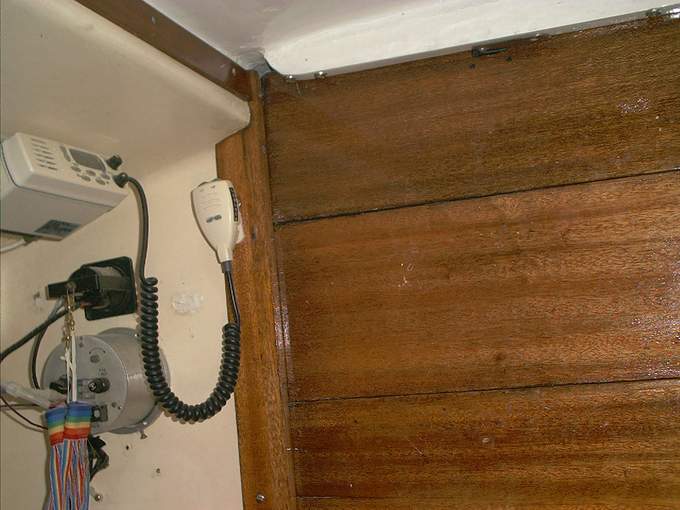

Does anyone have a picture of what the originals look like? Exact dimensions, whether they were tongue-in-groove, etc.?

They're originals, plywood with veneer as far as I can tell.

Hi. Believe 338's were original too. But the three equally sized pieces are 3/4" solid mahogany with a fat spline-filled dado on the sliding edges.
Middle horizontal edges have a simple 1/2" lap for shedding water.
The splines are 5/16" wide and are 3/4" deep. These glued-in splines must have helped keep the solid boards from warping, kept the boards from splitting, and long grain made a smoother edge for sliding. It's a nice simple trick that's lasted for decades. :cool:
I took a look at the boards, that sounds right I think.

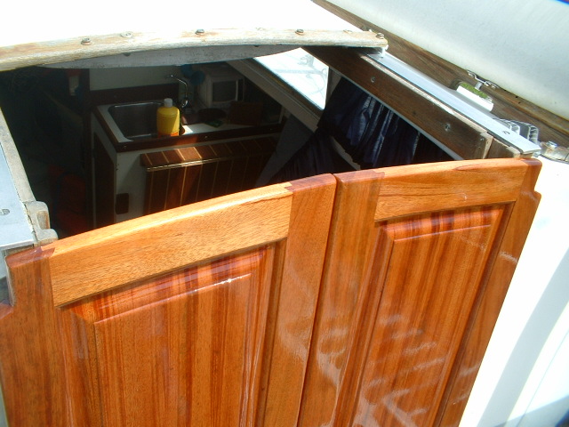

Here's a shot of doors we made in shop class. Curved tops were fun!

Fantastic doors Bill.
So, I see you plan to mount them outside of the grooved dropboard slot. Here's an idea for locking it up that might lead on to something.
How about a separate made up astragal of stainless that would drop into a slot in front of the two doors in the threshold and rise above the doors with the traditional horizontal slot that takes the tongue for the hatch lock? It could be just a flat bar of 1/8" stuff, or it could have a stub out on the back that would fit between the doors to further stablize them. A short legged 'T' in section.
This would be a separate piece just for locking up when away.
You'ld probably have to add a sliding bolt inside to keep the hatch from sliding open. So it would be harder to force open.

Nobody ever turned out something like that in any shop class I've been in! Hoochie mama I like that!

Those doors look great - I like the lines... There's a good design in the Manual that this organization puts together as well. Any chance you've got measurements or a schematic for a pretty thing like that?

ah, shucks guys, it's just wood. ;)
I put them outside the grooves for the boards, didn't want to loose that option. And in practice (sailing) i don't really know that i like the doors. Open, they're kinda in the way of things, like halyards that run back, depthsounder, etc. So they're kinda just for show. I still slide in a piece of plexiglass behind them, and secure the hatch through a slot in it. Works ok. And they're on take apart hinges, so they go below most of the time. It was a fun project though, and they are beautiful.
As far as measurements/schematics?? No, just have your local 4yr. old hold a piece of cardboard up to the c/way with you inside with a pencil. Go from there. Nothing to it. ;)

Don't klnow if this helps, but since you asked and I had the camera here is one.

I have a standby board that is used off season or when I need to freshen up the varnish on the three boards. It is 5/8 plywood, shaped sort of like a tombstone. It is 20 3/4 inches wide, 23 3/8 in. high to the top of the crown and 22 1/2 in. high at the shoulders. Fits like a glove. Even cut in a slot for the lock tang.
