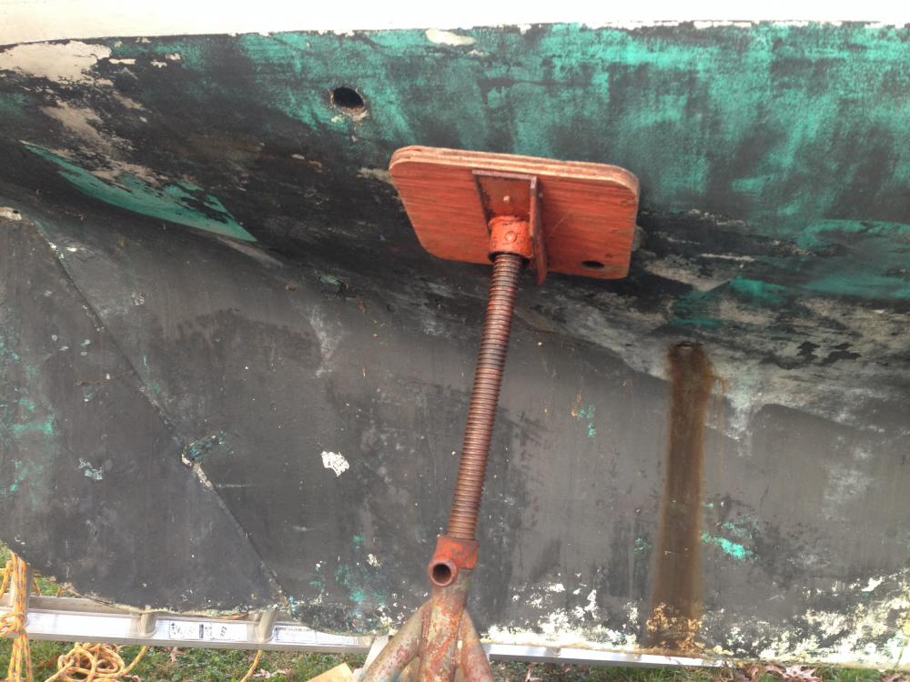

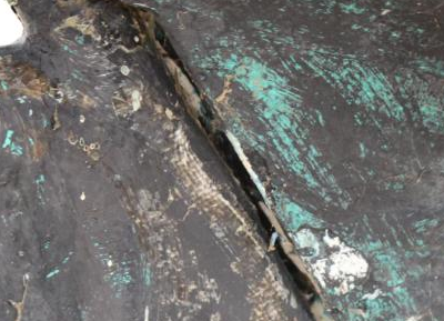

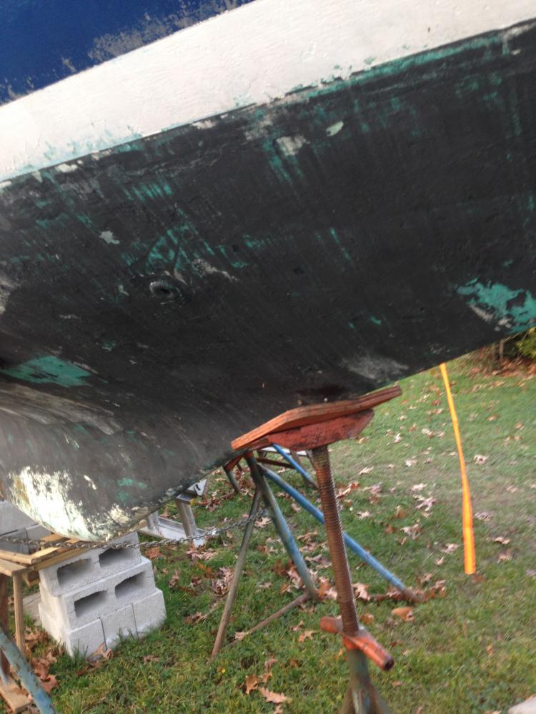

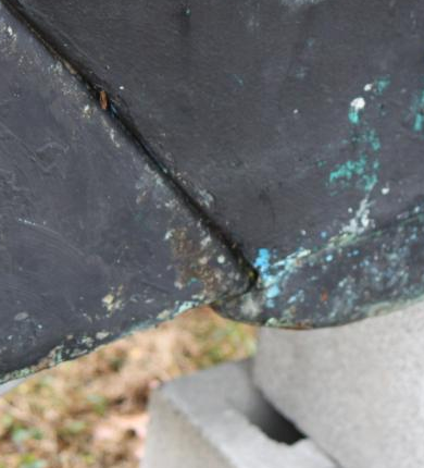

Here are some pictures of the Hull on Commander #38. I would like opinions on what should be done to sail for one season in Long Island New York.

Your Commander hull looks like it's in great shape. The rudder looks like it's been rebuilt.
Doesn't look like original wooden planks are showing. The space between rudder shaft and
keel post looks tight. You may have a rudder encased in fiberglass. Or completely 'new'.
Doesn't matter... Take a (Bahco carbide blade scraper, the large size) scraper and remove
any loose stuff. Don't dig the blade into the hull's surface until you figure out what you got.
Use the carbide to scrape a little deeper in a couple small places to see if there is a thick
white gelcoat on the hull. If there is no white, or if the white layer is very thin, you may
have a new barrier coated bottom on your boat. Don't do anything rash until you've
figured it out! Former owner available?? Original polyester color is dark translucent green.
Looks like the boat is supported OK. Just recently went on and on about boat jacks. See
if you can easily get the boat level fore-n-aft, and sideways. See if the partial waterline
showing is level. Maybe you can use the remains of what looks like the bootstripe to find
where the bottom paint ends. You might look VERY carefully for the original factory boot
stripe and waterline in that area. It would be a slightly indented scribe line, an obviously
intended line or maybe two, whose lower line is eyeball straight. They may have long ago
disappeard. Found mine on the Ariel.The top of the bootstripe often rises going forward
to the stem, appearing wider at the bow than midway. The lower line of the remains of
the bootstripe seen in your photo is the dead straight waterline, or should be.

Looking at your photos, it doesn't look like you have to go crazy. Just some scuffing to
provide a surface. If you are actually planning to later work on the hard on the boat,
you shouldn't need a primer. Vac dust off hull. Hose off hull or wash with warm water
and small amount detergent. Water should sheet, not gather in drops, streamlets and
islands like your newly waxed auto.

->Figure out what caused the rust stains. They happened when the boat was out of
the water. Rust appears to be coming from the interior in the bilge area. There should
NOT be any drains in this area. The hole(s), if they are still there, must be repaired.
Something rusting in the bilge probably made the rust, but there is no logical reason
to have drainage there !!!
->The hole in the hull in the third picture should have a seacock behind it. It doesn't,
because there is no thru-hull showing.
