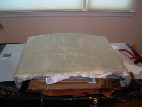

Don't have to steam bend thin wood, glue will hold it. Will hold it on a mild curve. A radical curve where you have to bend and hold the curve with clamps, you would put fastenings in at least on the ends. I wouldn't. It is really not possible to plug screw holes in thin teak. Maybe 3/8s thick if you are really careful and have shallow plugs glued in. Remember the resanding/refinishing down the line!
If you have a difficult curve like the front, or the back top over the c'way, you can have the actual curve cut out of thicker stock. It would then have no springback and would never pull away because too much of the glue was squeezed out.
Might glue the harder pieces on first, like the front. And the sides of the flat top, let them set, and come back later to fit and fiddle with the rest - that way you have nonmoving edges to depend on. And you can custom the spaces or trim the pieces.
You can screw convenient blocks to your bare hood where ever you need them to help position the first pieces. You can cheat by predrilling small holes in the teak (do it dry first) for small nails that you pull out later of course. If you do it right you can include a small block of wood or cardboard under the nailhead to hold the teak down like a small clamp. You don't need to drill thru the hood. No holes in the teak by a similar method but using the grooves for the nail holes. You could create a hold down bar across a strip.
Even simpler is double sided carpet tape with the fiberglass core. The glue can be very aggressive, you need the fiberglass one to pull the tape off! Instead of little nails stick battens on with the tape to help positioning and to hold a piece until cure.
Might glue the strips on with 5200, cut off the squeeze out when set and fill the layout spaces with polysulfide caulk. You'll have to reef out the squeeze out in the spaces at just the right time. If you have a rabbet milled along one edge you wouldn't have that problem - you'ld be laying them tight like a yacht deck. But it would be difficult in thin stock and the rubber filler would also be thin and might pull out. The sulfide should be at least 1/4" deep.
Better to glue on plain strips with spacers - scrape groove clean when partially set. Skimp the 5200 to avoid squeeze out. If the little planks are cupped at all put the cupped (slightly hollow) side down. Some tricksters will make a slight hollow down the length of a strip to get more rubber to stay there if they have an easy tool to use. If you have open ends (no cross pieces in your design) on the sulfide make a dam with wax paper and a batten. Screw the batten to the hood and fill the small holes in later.
Rough up the glue side of the pieces to give the epoxy or 5200 good tooth. Especially with teak. Check the one-part polysulfide to see if you need to bloody prime first. Maybe don't have to these days.
