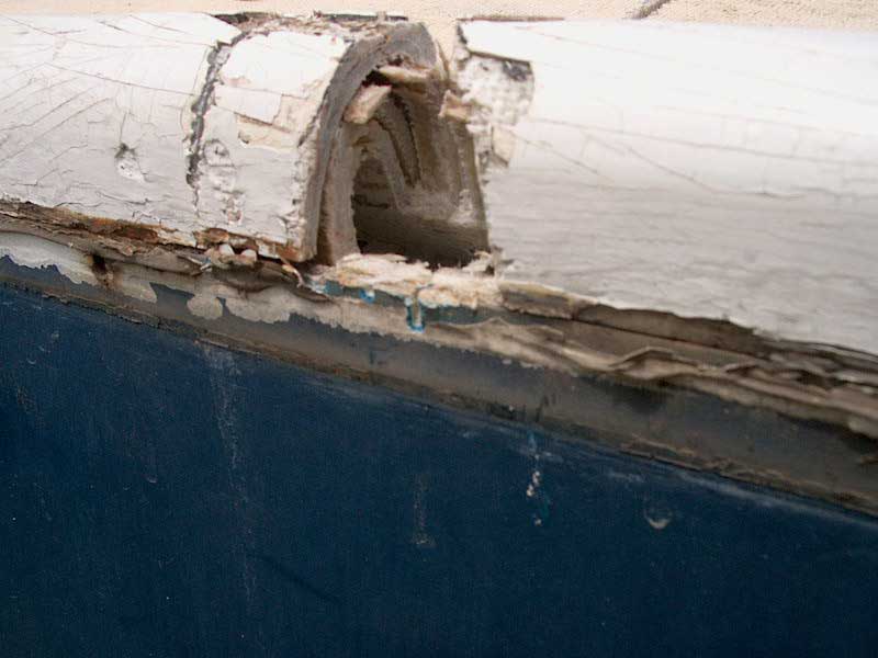

Just wanted to close the loop on the rubrail and anything attached with screws on a fiberglass boat.
When you think of it, if you are attaching something to laminate, you have one shot getting the screw into the hole. If you back the screw out you now have a hole bigger than the screw size. Glass shatters and plastic is brittle. Even a carefully sized predrilled hole for the fastening in fiberglass will not keep the material from disintergrating when the threads are driven in. When you back the screw out you are clearing the hole.
Therefor the rubrail leaks thru the fasteners if it has ever been removed. Care to guess how many screws are doing the holding vs how many are letting water in?
If you carefully refill the holes with epoxy etc, and you're putting the rail back where it originally was, you are right back with the one shot deal. IMCO if you are sure you can get 5200 or 1A DEEP into each hole and let it cure so that when you reattach the rail you get some bite to hold and press the rail tight to the boat you have a better chance at stopping the leaks. You may have to predrill a small hole for the screw in the rubber. Have to feel each fastening, but predrilling a tiny starter might seat the screw without the danger of drilling thru the joint and making another potential leak. My opinion only.
Whether you use the same material to bed the rail on is your call. I don't think glueing the rail on forever with polyurethane rubber will strengthen the hull/deck joint. Polysulfide would be my choice. It weathers better, lasts longer, and allows removal.
Point is, screws are almost the worst fastening you can use on fiberglass.
Hope the rub rail won't have to be removed again for another 40 year.

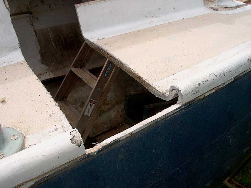

In what has begun as a minor re-fit, 'Faith' has now had the hull to deck joint glassed over from the inside across the transom, and inside the lazarette.
I filled the joint with epoxy on the outside.
I actually purchased the 5200 to re-caulk the joint, as per the manual but have discovered that the screws were replaced by larger, longer screws that have gone on through into the cabin.
I am now working forward, the rest of the way around. I will epoxy 1" band of fiberglass, and fill and fair the outside.

As the battle rages on, today I worked on the hull to deck joint again.
It was tough, looking up at my new sails and a beautiful day calling be out to the river. I have shifted my strategy slightly, and now am filling the screw holes and the seam with thickened epoxy (I see the light Ebb, I can not imagine how much fairing compound it would take to get that right).
I am back to the hull to deck joint since I am moving the Genoa tracks to the toe rail and need to have it painted before I mount them.
Quote:
Are you going to refasten the stainless rubrail or abandon it?
I plan to remount it it is going to be tough to screw back into what will now be a watertight joint though. :rolleyes:
