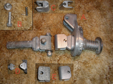

My gooseneck parts arrived today from Rig Rite.
The parts are the toggle and the gooseneck shaft (arrowhead). The photo below including inserts B, C, D, and E nested into a photo (A) of the complete assembly and broken/worn parts . This collection of shots displays the parts along with my original but cleaned-up front-end cap (gooseneck casting).
In the main photo (A), the new Rig Rite gooseneck shaft (arrowhead) is installed in my original front-end cap (gooseneck casting) on the right. The casting, spring and washer in the assembly are original.
The arrowhead and the toggle are identical, except that they are drilled for smaller (1/4 inch) fasteners. The toggle as displayed installed in photo A and uninstalled in Insert C and Insert E below has a smaller (1/4 inch) horizontal hole for the pin or bolt to connect it with the smaller (1/4 inch) hole in the arrowhead. The hole in the original toggle as shown in Insert E has worn into an oblong shape. A smaller (1/4 inch instead of 5/16 inch) hole in the new toggle means a weaker pin or bolt, but it also enables a smaller hole in the arrowhead, and this means a stronger arrowhead. The arrowhead was the part that broke on my original rig. See the broken arrowhead with larger hole on the left in Insert D (or in the assembled gooseneck assembly marked "A" in post #3) above. Also see the original bolt, washer and nut on left in Insert B bbelow in comparison with the new pin on the right also in Insert B.
This smaller hole in the arrowhead seems like an appropriate compromise to me although that stainless steel pin does seem a bit tiny to me.
A top view of the original toggle (on the left) and new toggle (on the right) is shown in Insert C. Although the length (height) of this part is correct, the vertical hole on the new Rig Rite toggle is also smaller in diameter. It is also 1/4 inch instead of 5/16 inches). No fastener was provided by Rig Rite to attach the toggle to the sliding mast track car. The original bolt used on my boat will not fit this hole. So it will take some thought before I fit the new toggle to my mast track car.
Note: Those additional thoughts consisted of using a 1/4 inch bolt and lock nut to attach the assembled gooseneck to the mast car. The1/4 inch bolt, being 1/16 inch smaller than the 5/16 inch holes in the gooseneck slide (mast car) wobbles excessively on the gooseneck slide. This is a concern because he wobbling will create asymetrical stress and resulting on the mast car. The choices seem to be:
1. Enlarge the verticle hole in the Rig Rite toggle. I called Rig Rite and they do not recommend elarging the vertical hole in the toggle. I also checked with a machine shop and they tell me that it woudl be difficult to enlarge the hole in the toggle with a dril press. They did not have milling equipment.
2. Select an alternative toggle if one is available. I was not able to indentiy a toggle on the Rig Rite site with 1/4 horizontal and 5/16 vertical holes, nor can I find an arrowhead with a 3/8 inch horizontal hole. I called Rig Rite and they don't make a toggle with a 1/4 horizontal and 5/16 vertical hole. They say that Pearson made both the toggle nad arrowhead with 1/4 inch holes.In contrast to what Rig Rite says, both of the old arrowheads that I have have from two different Ariel booms and two different Ariels have 5/16 inch holes in them. I suppose I could follow Bill's lead and have a new toggle fabricated in stainless steel.
3. Replace the gooseneck slide (mast car), but with what? I have not been able to locate on the Rig Rite site a gooseneck slide that fits on a 7/8 inch by 1/8 inch external track and accomodates a 1 1/2 inch high toggle. All is not as simple as it seemed. Do I really want to remove the bolt that serves as the track stop for the car, since that stainless steel goodie is frozen in place? Not really.
4. Locate and install flanged bushings in the hole in the gooseneck slide holes to reduce them to 1/4 inch. I have located precisely the bushings that I need in nylon, but I'd like stainless steel or bronze. I have foound 3/8 bronze flanged bushings, but I would have to either enlarge the holes in the gooseneck slide to 3/8 inch to accomodate them, or sand the outside diameter of the bronze bushings down to 5/16 inch.
The nylon bushings are only $0.19 apiece. I wil probably try them to see if they hold up while I more fully consider other motre permanent alternatives.
At this point I am more favorable to Option 4 above.

So here is my lastest version of the installation of my new Rig Rite gooseneck toggle.
1. I found some 5/16 bronze bushings at Orchared Supply Hardware.
2. I pressed them into the 5/16 holes in the goosenck slide (see bottom photo).
3. I then cut the bushings to length with a hack saw and flat file so that the gooseneck toggle and two stainless steel washers just fit between them. (See top photo...Please note that the lock nut on the 1/4 inch bolt was not tighened when I took this photo, so the assembly is loose as a goose..neck.) :)
4. The bushings are held in place on the inside by the washers on either side of the toggle and by a stainless steel flat washer and the hex head of the 1/4 inch bolt above and a stainless steel flat washer, lock washer and lock nut below.
5. The aluminum gooseck toggle is protected from and insolated from the bronze bushings by the stainless steel washers. I am not sure whether the outside washers and lock washer are really necessary, but since that was the way the original installation of the old gooseneck toggle was, I duplicated it. I do like the idea of the washers being in contact with the bushings rather than the bolt head and lock nut.
6. In addition to peventing the smaller 1/4 inch bolt from wobbling in the 5/16 inch holes, the 1.5 inch high gooseneck toggle will no longer rattle up and down in the much larger gooseneck slide space formerly available to it. Of course there's three kinds of metal in there, but hey they are all moving parts. I cut the bushings from the same piece of 5/16 :1/4 bronze bushing stock. The stock cost less than $3.00. I have enough left from that one piece to make two more bushings.

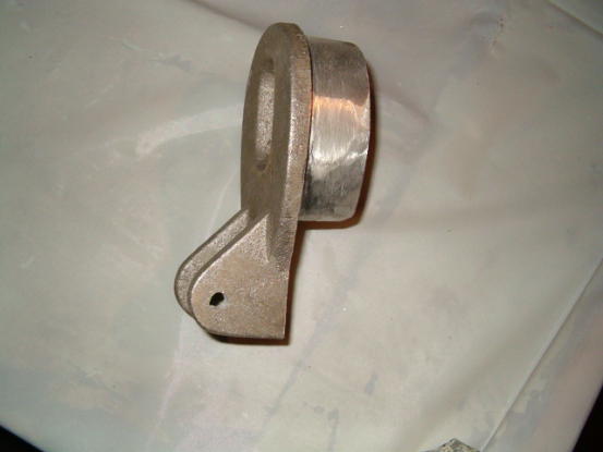

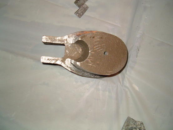

The only other part we haven't talked about is the gooseneck casting.
I couldn't find a direct replacement. D & R sells one that is pretty close. I had to do some grinding to get it to fit
The part that fits in the boom was little too long
sideview
I believe this casting was designed to fit a RR 4025 boom. Rig Rite also sells a casting for $ 159

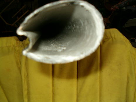

I'm certain that our boom is different than the 4025. The picture below shows the inside of our boom where the casting goes
