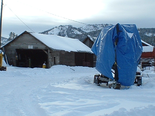

Thought I'd see if this will work. Yeah, nice photo of a blue tarp. Let's go sailing!:D
Willie,
Saw on the Weather Channel a few days ago that you had some real heavy snowfall out there and your pic. proves it. I second your statement "let's go sailing"; how about we make it someplace warm!
Jim
I'm thinking Baja is nice this time o' year. More snow, 16''out in yard now. And cold!! supposed to be near 0 tonight. More snow on the way too! Here's a shot of my current project/research. Open to ideas. Trailing edge of keel inside shoe needs some repair also --if anyone has done this, please send HO's and advice. thanks!

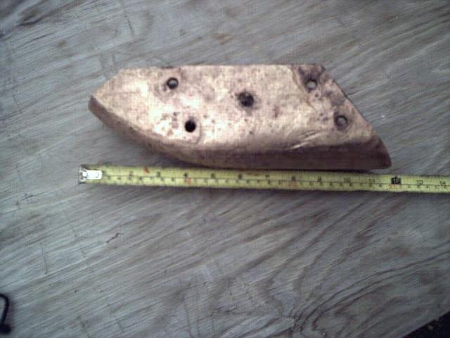

I take it that this is the shoe off of your Ariel and the interior of the shoe has partially been eroded by electrolysis; or is this the one that you found on eBay?
Are our shoes held on by five fasteners as suggested by your photo showing five holes?
I placed an anode on my shoe last season for insurance and could'nt wait to see it this fall when we hauled. I'm not even in a hot marina and our anode has really been pitted and eroded. Will change again in the spring before we launch.
Jim
Found the shoe from an ad in 'Good old Boat'. Thanks Brian! From a Vanguard. Looks good to me. The part missing is the trailing edge of keel, about 2''inside shoe. Still has 3 good mounting holes. Was attached with bronze pins, peened over on the ends. Trailing edge had some type of fairing compound?? that came off with old shoe. Any thoughts?

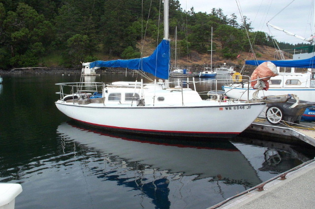

Here she sit's before I showed up.
Then we went on a trailer.

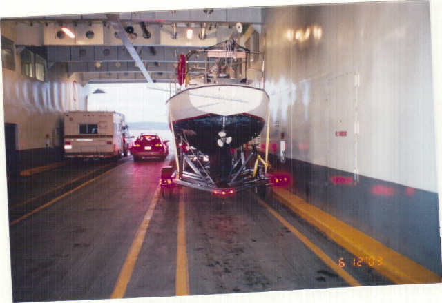

So here's another scanned one, on the ferry ride. We were gonna sail, but weatherman said 50+ knots for the day. Went to plan B. Or was it C? oh well. $123.00 for the ride, with Oregon discount.
Note the water line, with yamaha 9.9
450 miles later, we're back on the ranch, that's the 'snowed in Ariel' of eariler post. Here's a couple of the interior for fun.

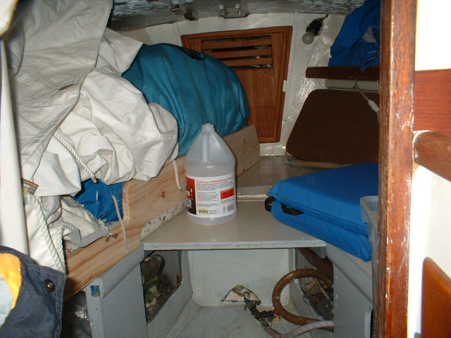

v berth. needs some work.

Capt Bill,
That picture is of you, right? Well you look short enuf - and wise enuf -to own an Ariel!

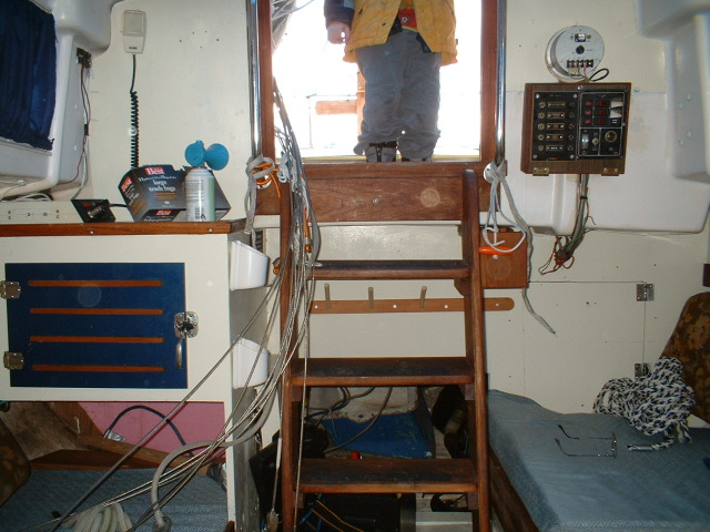

How about that hanging locker conversion to the galley sink, pretty interesting!
But really have to ask why the waterline of the boat is up so HIGH! - looks like 6" more than 338? Water in the keel?
BOWSPRIT??? Now that is another kettle of bouillabaisse. T'other Bill, the big cheese, he might want to post a little something on that subject!:rolleyes:

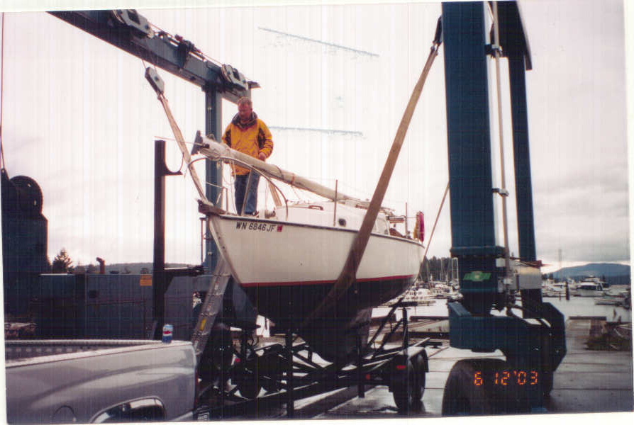

Ebb, you've a keen eye. Yep, that's me on the boat, almost short enuf at 5'9", not sure about the wise part!
And the waterline is indeed about a foot higher on 'er. She wasn't actually sitting on it in the water, about half way 'tween it and where Prof. Alberg has it.

Thought i'd post a couple shots of the next project.:mad:
here's a dry fit of the shoe, showing how much is missing.
this ones a little better angle, without the shoe. open to ideas. don't think there's a quick fix for it though. :confused:
and here's one that has me wondering what to do also. Rudder has glass over it on the top half, only paint on the lower half, which is about all peeled and sanded off now. Do i strip it all, reglass? gonna be in the Columbia for a few years, fresh water. Then who knows. Wood looks good.
Bill

The photo without the fitting is close to what 338 had. Yours looks worse! Ha! If you don't have a good feeling about embedding lags, that's understandable. 338 had more open space there, so there was room for that option, which you could create when you clean up the area and more comes off - if it does.
No matter what, whatever you leave has to be sound, no loose chunks partly held in place. Just from the photos, now, I'ld be thinking of grinding back the gelcoat and paint for the 'wrap' option. (That's because it doesn't sound like you are comfortable with the holding power of the lags.) I don't think the 'wrap' fix is as radical as it may look, from all my verbiage. You can play around with the matt dry befor you commit to epoxying. You know, to see if the shoe is going to fit good. Some faith.
Taking the matt up the sides 12 - 15" or so, at least with one layer, is IMCO the correct way to go. That way you will tie the shoe to the keel, know it won't drop off. I saw an Ariel at the yard once whose shoe was corroded away. The rudder was literally hanging on its gudgeon strap. Next time I looked the boat was back in the briney. Some faith!

IMCO Pearson had a heel of a time - and the guys just didn't get their broomstick handles deep enough into the mold - when laying up. When mixing polyester just a tiny bit of catalyst will cause the resin to kick too early if you're working too thick like in the 'trailing edge' and down in the heel.
338 had the same missing piece, except it was still in there when the shoe came off. DFO had your shoe off at one time and just didn't refill it. DFO in my case didn't want to disturb anything and put it right back but drilled new holes thru the side of the shoe, causing more problems inside, and making it even weaker.
I don't know if it is clear anywhere here but I had to REBUILD the whole trailing edge in front of the rudder. That's because I obviously don't want to go sailing. I keep telling myself that the Ariels did just fine befor I came along.
I stand by the 'wrap around' fix suggested. I'ld put the wrap more straight up over the heel, dieectly over the wound.
It's hard to believe that Pearson would market a hull that had that much REPAIR to the trailing edge. My guess is that it came from the factory that way. [338, also had a abalone sized chunk come off the bottom of the keel in the middle where the laminations were not pressed down in good enough - the factory repaired it with a primitive form of bondo - knew it was the factory because you could see the roving going across undamaged.] The traling edge is not doing that much work, except at the heel and the gudgeon. I would make sure it's all tight, take the dremel and clean out the cavities and fill. Dental work.
