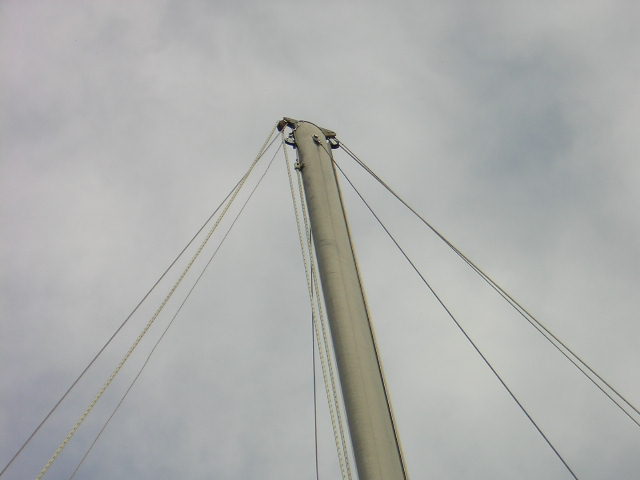

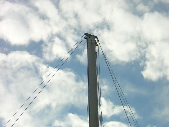

Spinnaker topping lift block
Here's the block location..
