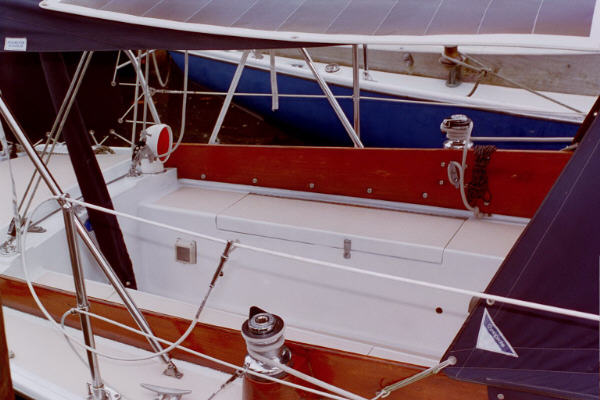

For the last two years I only did touchups on the varnished woodwork on my Ariel, Mischief. And this year it's showing, so...
I've never been able to get a really good finish sans sags on the coamings so I'd would like to take them off this year.
Has anyone done that? I've taken out all the screws I can see and they still seem pretty secure. I'm afraid to start chopping away at them in case there's something holding them in that I'm missing.

If your coamings are attached like those in the Commander, there should be about four big screws on the inside of the cabin for each coaming.
These go in to the forward part of the coaming boards. Forgive me if you knew about these already.

I couldn't quite make out from the photo if you have the same blocks I have near the cabin--some of the screws go into those blocks. That might be what I have instead of the screws into the cabin like on the commander.
The previous owner used epifanes varnish and I've kept that up--it looks so good I can't resist. Besides I kind of like varnishing.

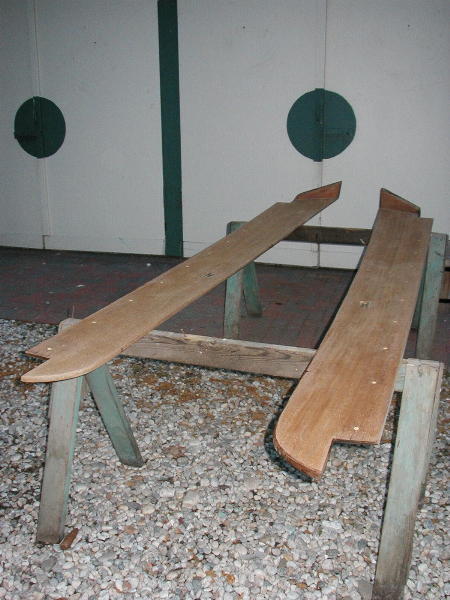

I found out what you mean about the coamings being difficult to remove. I had to force a very thin paint scraper into the gap where the sealant was and move along inch by inch. They finally yielded to that and alot of strong language.
Here they are stripped and mostly sanded
Coamings
Hey Commanderpete,they look as good as Sirocco`sI see you figured out how to post larger pictures.

Nice photos. I actually did some damage when I was getting mine off--the wood kind of splintered in a few places, but it won't show when they're back on. I've put on a coat of paste wood filler--so I can start varnishing any day now.

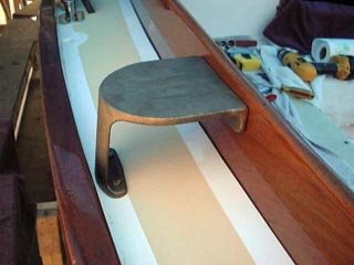

Here is the devil himself, taking the form of mahogany.
The devil disappeared before I could post his picture. Got him again.

Pic #39
Man, that silver 'coaming block' is abso lutely GORGEOUS!
Amazing what they did with aluminum back then!;)
