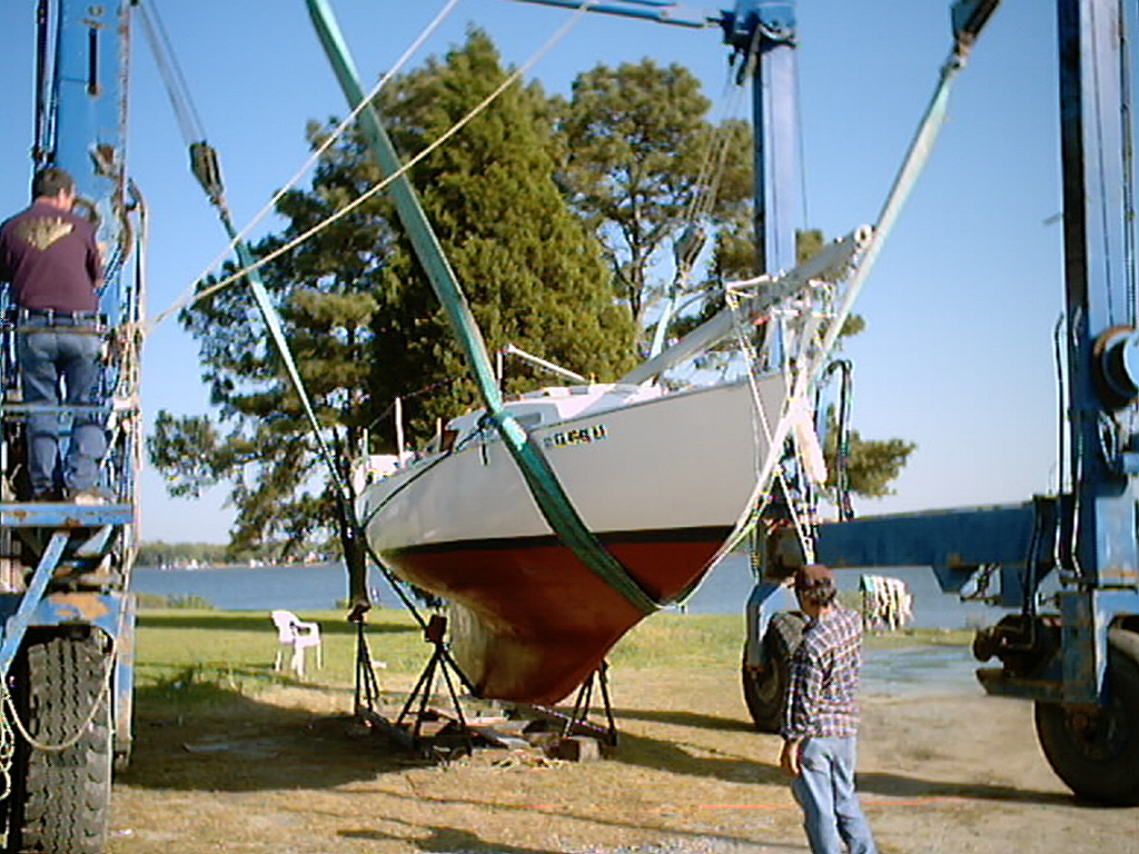

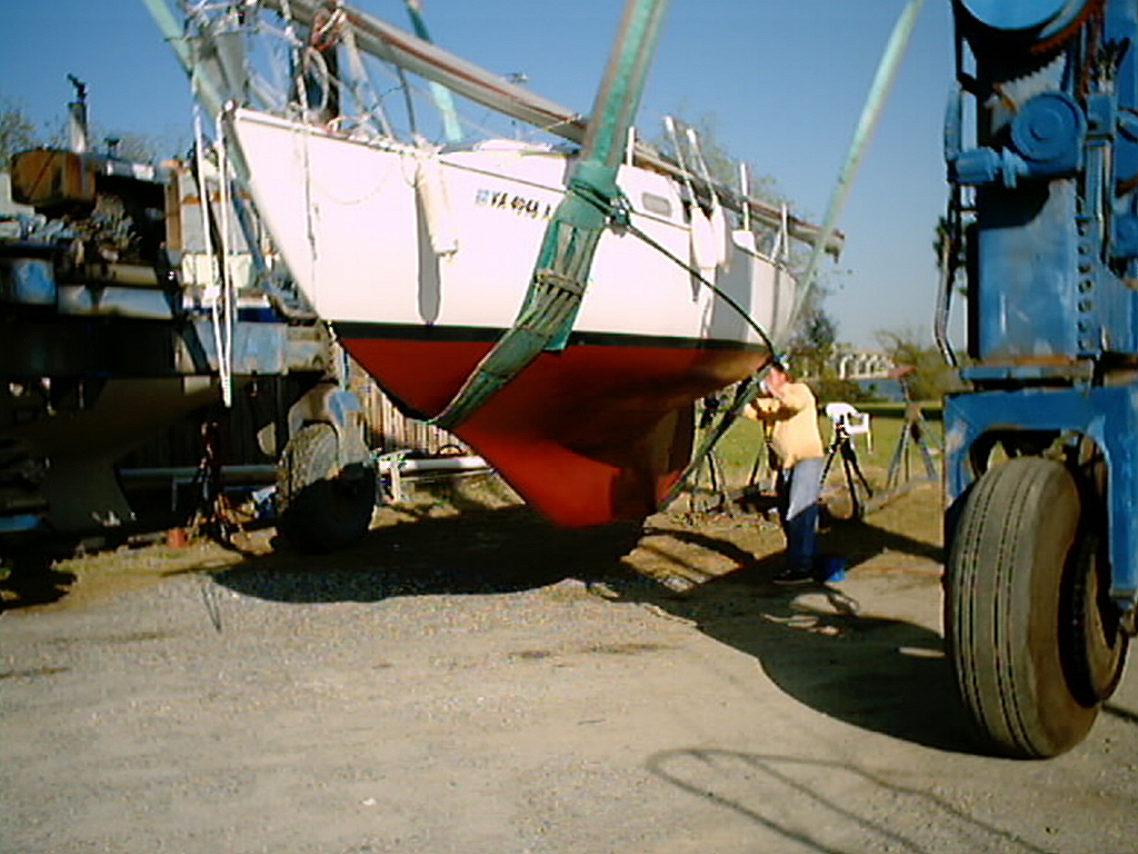

Robert splashed Sparky late yesterday , here are some shots.

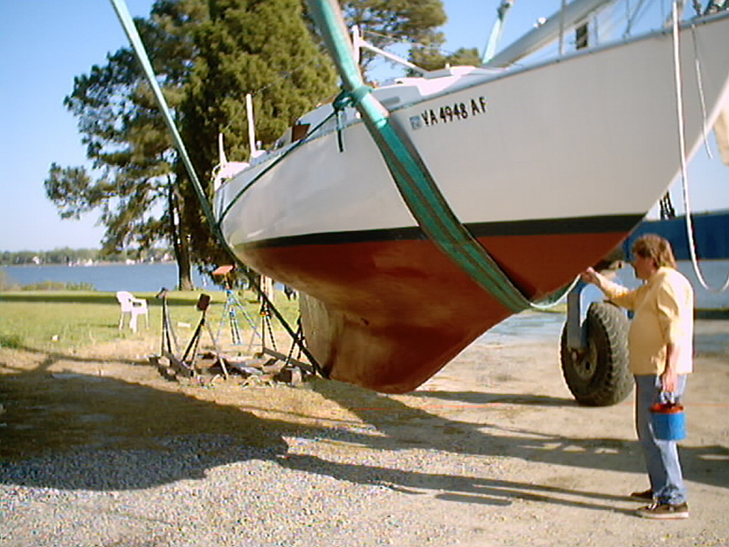

Touching up the pad spots
Now that's a sweet shaped hull!

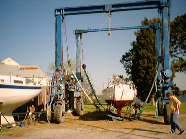

Ok, My question here is ... did a crane lower your mast?
Nope , we did it with a block from the cross member of the travel lift.
Ok, how about some details...for the slow... rookie.
I can not lock onto a visual...
block as in block and tackle?:confused:
Notice,hanging from the cross-member.
You make a strop and tie the ends to the moving block , the strop rides up and catches below the spreaders and haul away . Keep a line on the base of the mast for control.
You can do the same thing in a slip with the halyards from 2 neighbor's boats , makes the ends together and fasten to the strop and haul on both halyards together ( make sure you have their permission ).You only have to lift a foot to get the cables clear then lower away while the base of the mast is being walked forward and some one in the cockpit catches the top of the mast as it comes down.
There are lots of ways to raise and lower a mast without need of a crane.
