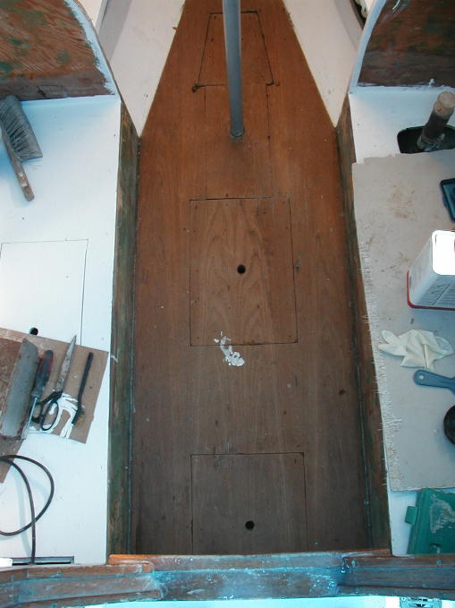

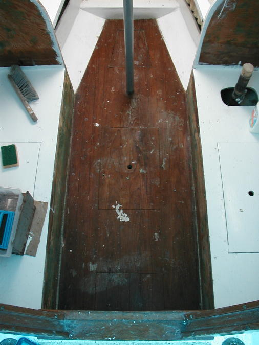

Adhesive for 1/4" Teak and Holly Plywood Sole?
I replaced the sole three years ago, but some water from a drip found its way underneath the plywood and started dry rot. This stuff is thin, doesn't take much to ruin it. So, I have extra half piece of teak/holly plywood and the template, so recutting a new piece will be a piece of cake. But......... what do the technical wizards think about the proper way to install so won't happen again? Thickened epoxy with some screws to make sure no voids around the edges? Does it matter if the stuff can't be removed in the future without blowing up the boat? Ha!

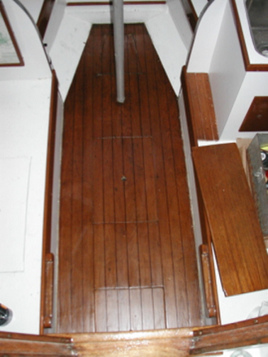

What finish for the cabin sole?
I bought a sheet of teak and holly for my cabin sole in Destiny. What do you guys recommend for finishing it?
Also I read someplace where finishing all sides top, bottom and edges is a good thing to help it keep from wicking up water that might get below it.
Thoughts?

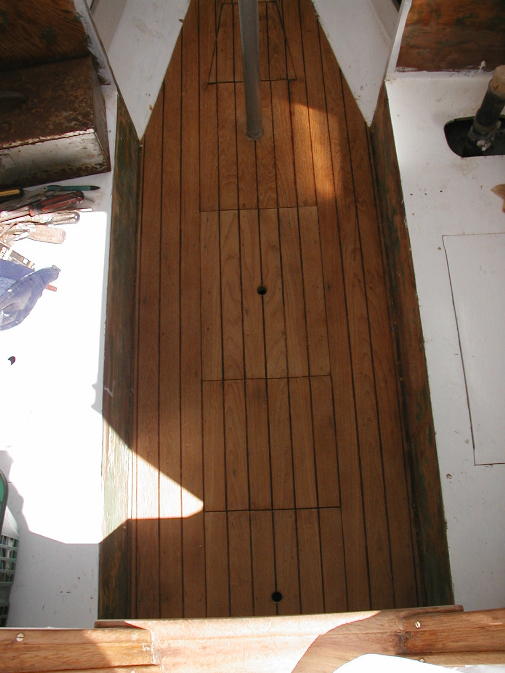

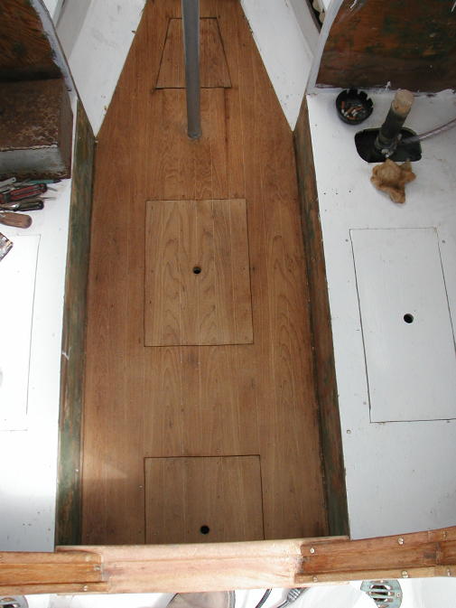

Ben, Ebb and Mike thanks for your replies
I guess I'm in the same camp as Ebb about sealing wood especially down here in hot humid Florida. And sealing all sides makes a lot of sense to me also. You never know when a leak could spring up that could cause water all over the floor. The water can certainly seep under the plywood and stay there for some time before it drys out. I think I will give Ebb's process a go.
Mike I have some "tropical" hardener for my Raka epoxy that dries really slow and Raka's resin # 127 is already a pretty thin resin for easy wet outs. So a combination of the slow hardener and the thin resin should seep in pretty good here.
