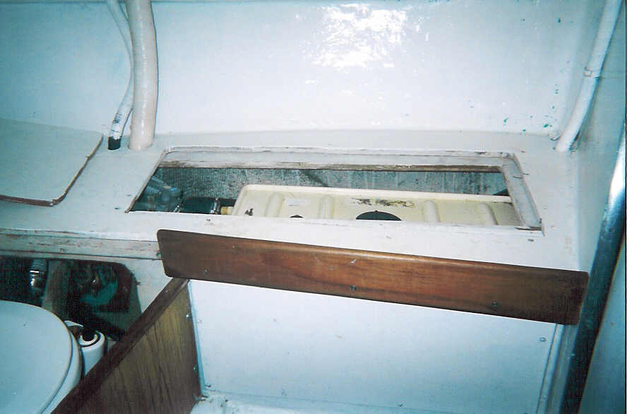

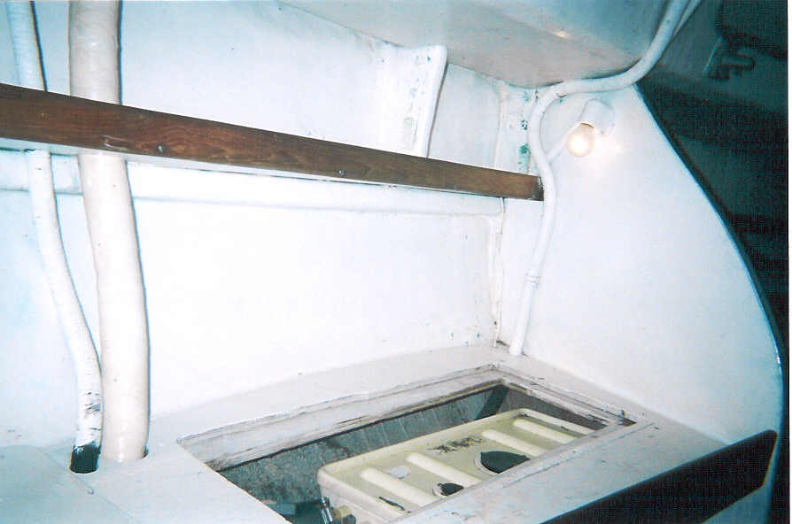

My Commander came with a marine head and holding tank. The tank is under the starboard V berth. I don't know if the Ariel has the same corresponding space. I'll try to get some pictures and post them.

OK, here are some photos of my holding tank set-up under the V-berth, with the cushion and cover removed.
Holding tank
