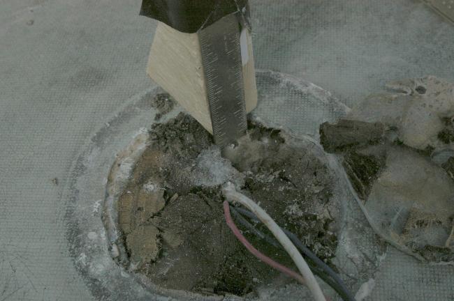

more on propping the inside under the mast
John, must br tired of this, huh?
Hesitate to say this as you may misinterpret.
Not sure of the inside finish of a Commander - or whether you have a flat arch in way of your repair - or have some other minor curves going.
If you do have other curves to the roof going on and you don't see that your prop plywood can snugly cover the area of repair, try something like this:
Fold a piece of stiff canvas into a pad. You'll have to figure out what thickness will work best.
If the cloth is relatively stiff and you press the wad against the roof one assumes it will span small imperfects but conform to the arch you are preserving.
In other words try putting a folded cloth like canvas on top of the plywood prop to get a tighter fit against the roof. Don't know if you need this. Something like this, stiff but bendy foam for instance, might get the snugness you need against the holes you think might leak.
ETHAFOAM
Foam sheet called Ethafoam is used for packing. Usually 1/2" thick, comes in big rolls, I get it at my local plastic supply, TAP Plastics, cheap. UPS store might have it. It is poyehylene foam. You could put that foam naked against the holey roof, do your wet repair from the top, and after the epoxy sets this foam will come right off. If you use that on top of the ply form/prop you'd close any small spaces that might leak.
