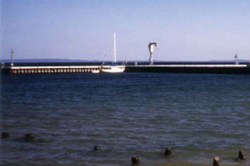

The places I am referencing do not have tie off poles. I have attached a photo of the dock that almost did me in last year. I don't think they would let you use a med system here because of the way these places are set up. Plus, without a rear gang plank (even more difficult) I don't know how you would get ashore without a dinghy). As for placing an anchor out to pull the boat off the dock, that is fine, and perhaps an alternative if you can foresee in advance an oncoming storm, or havce notice of it, but it is a pain - a fender board being an easier solution. Additionally, an off dock anchor can be problematic with other boats because, in most cases the anchor would be in mid channel.
As for line stretch, I have had 10', 3/4" bow painter stretch 1 1/2 feet in a blow, and there were other lines and springlines holding the boat as well. My tie lines are 3/8" and 1/2", which is about as thick as I want to go, because of the line weight and bulk. As for where they are tied, the issue is where the cleats/posts are on the dock, more than anything. Being a smaller boat, this is probably a more difficult problem because cleat spacings on docks appear to be more focused on larger boats.

That dock doesn't look very Ariel friendly !!
If I had a choice , I would anchor and dinghy in before docking to that @*!$%% dock .
You could always add a couple of weights on 4' lines off the fender board to keep it from riding up the fenders . I find the heavier boards stay put pretty well and I hang them low , maybe a foot above the waterline .
You are right - the dock is not that friendly. What I encounter may be unique to the lakes. There are a) government docks, like the one above (and which they screwed up on) that are built for the mainland ferry, which doesn't go out in bad weather, and then there are b) the old delapidated docks formerly used by commercial vessels.
