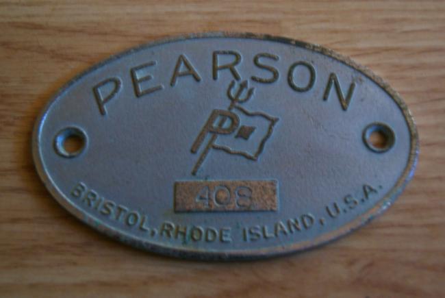

This is my Ariel ID Plaque.

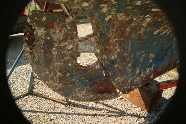

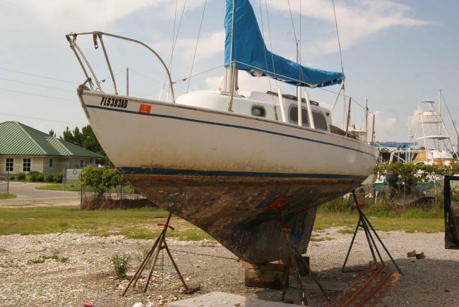

At Carrabelle Florida, She was too heavy with the oyster bar attached to her hull, and very slow, waiting for sanding and new paint.

You have barnacle Monet, shame you can't auction it off !:D
Need big money for my monet!

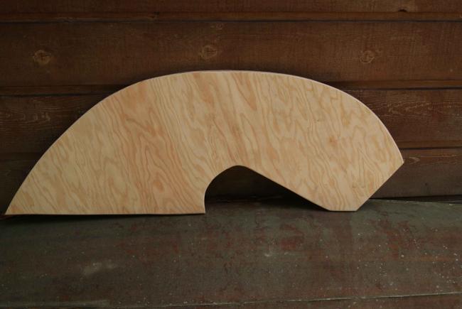

New rudder cut out and ready for the shafts and fiberglass.and paint, etc
It's difficult to tell, but is Linda Anne an inboard model?
She is the inboard model, but the engine has been removed and a tohatsu 8 was mounted aft, she still has the drive shaft though, I am going to mount a Yamaha 9.9 high thrust for now and look for an atomic 4, gas or diesel.......
